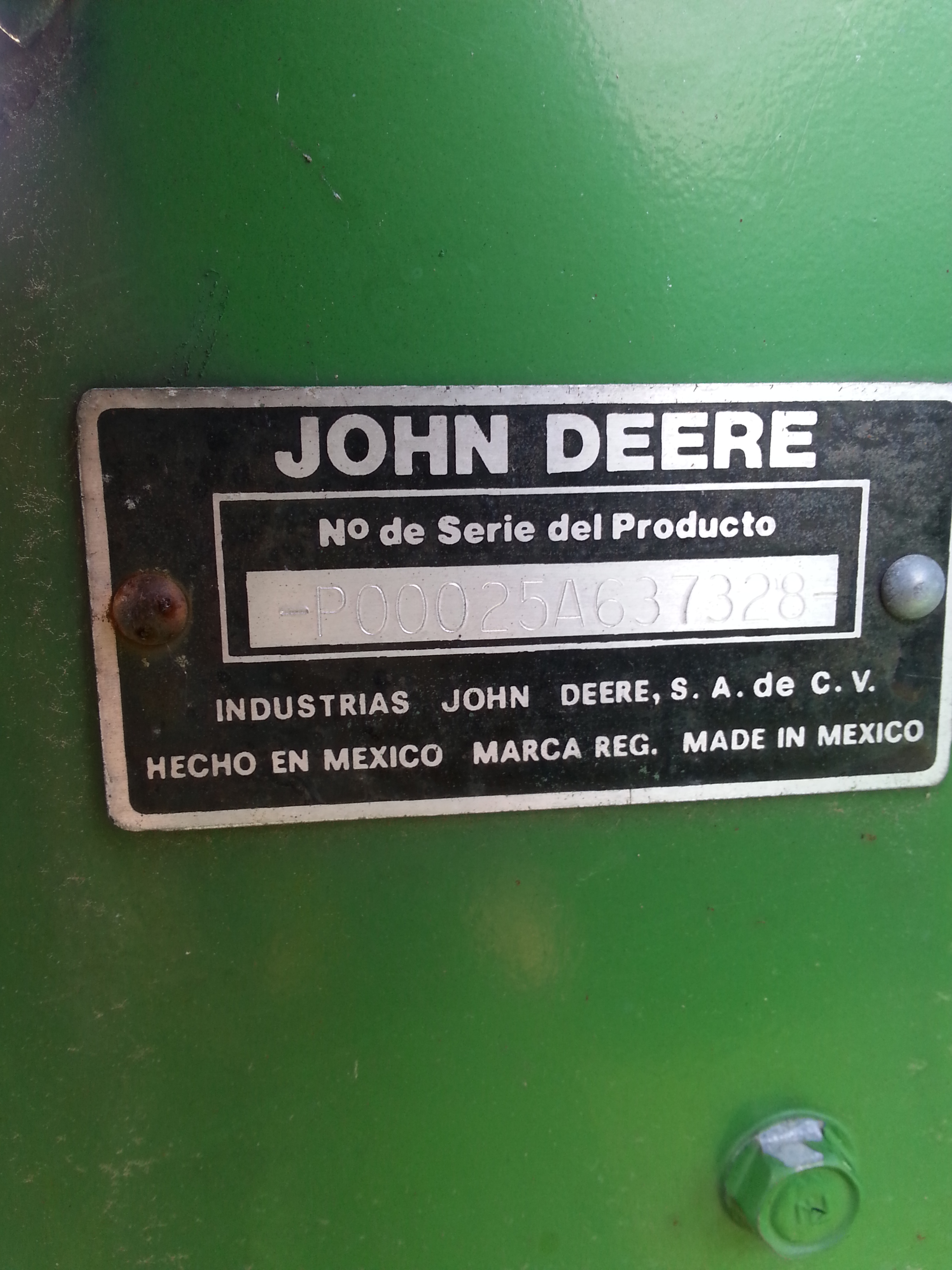

I've contacted several local dealers. Serial number doesn't come up. Serial P00025A637328. I contacted Deere. Not a valid serial number. I told her I was looking at the tag. She insisted there must be another number on it. I'll post photos later, but I will say that besides Hecho en Mexico, the other text on the tag appears to be in Spanish. Might it have been intended for a market south of the border and ended up here? Wouldn't that still be a valid number? It falls within the range of numbers on Deere site for a manual. The format of P00025A + six digits is the same as other's I've seen photos of. I don't get it.

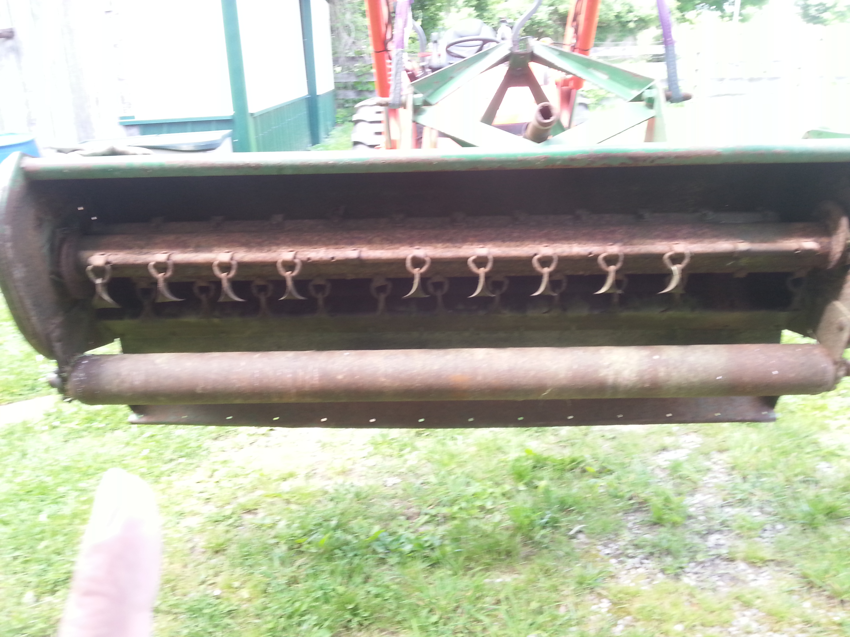

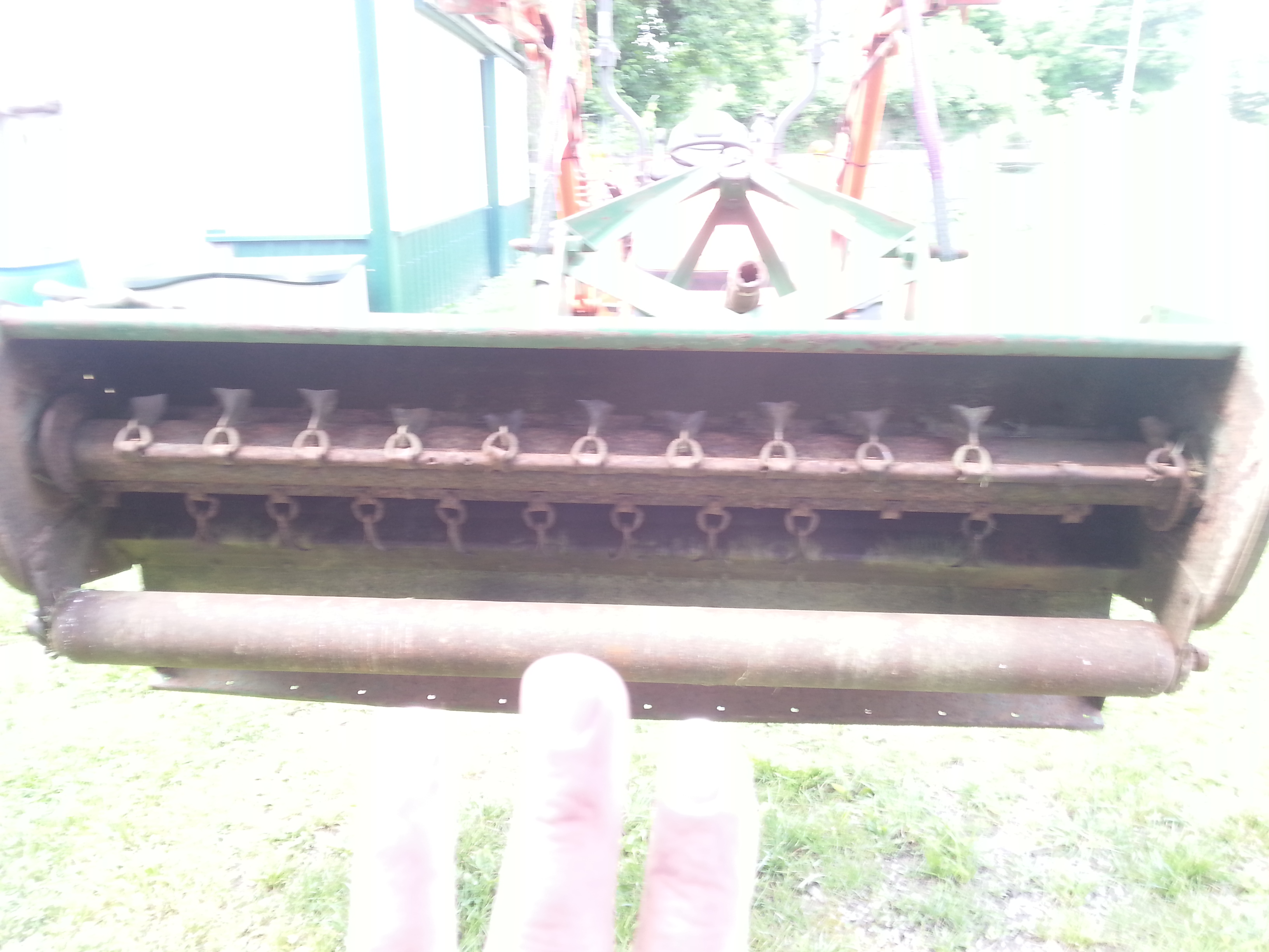

Regardless, I need to get this thing to work. Overall it does not appear to have spent much time exposed to the elements. It's missing blades. If I understand this thing, it should have 3 rows of twelve. I'm missing 3+3+1 in various places across the shaft. I did see it run, but the seller knew less about them than I did. He stuck his hand up at an auction thinking he could cut hay with it. It didn't make any alarming noises once we removed a loose side plate. At this point, I don't anticipate any bearing or gear box issues. (Please Lord let me be right.)

What I would like to you to do if possible is take a more than few pictures of the flail mower for me.
First:
I would like to see all three rows of scoop knives under the flail mower shroud and the inner bearing hubs on both sides of the flail mower rotor.

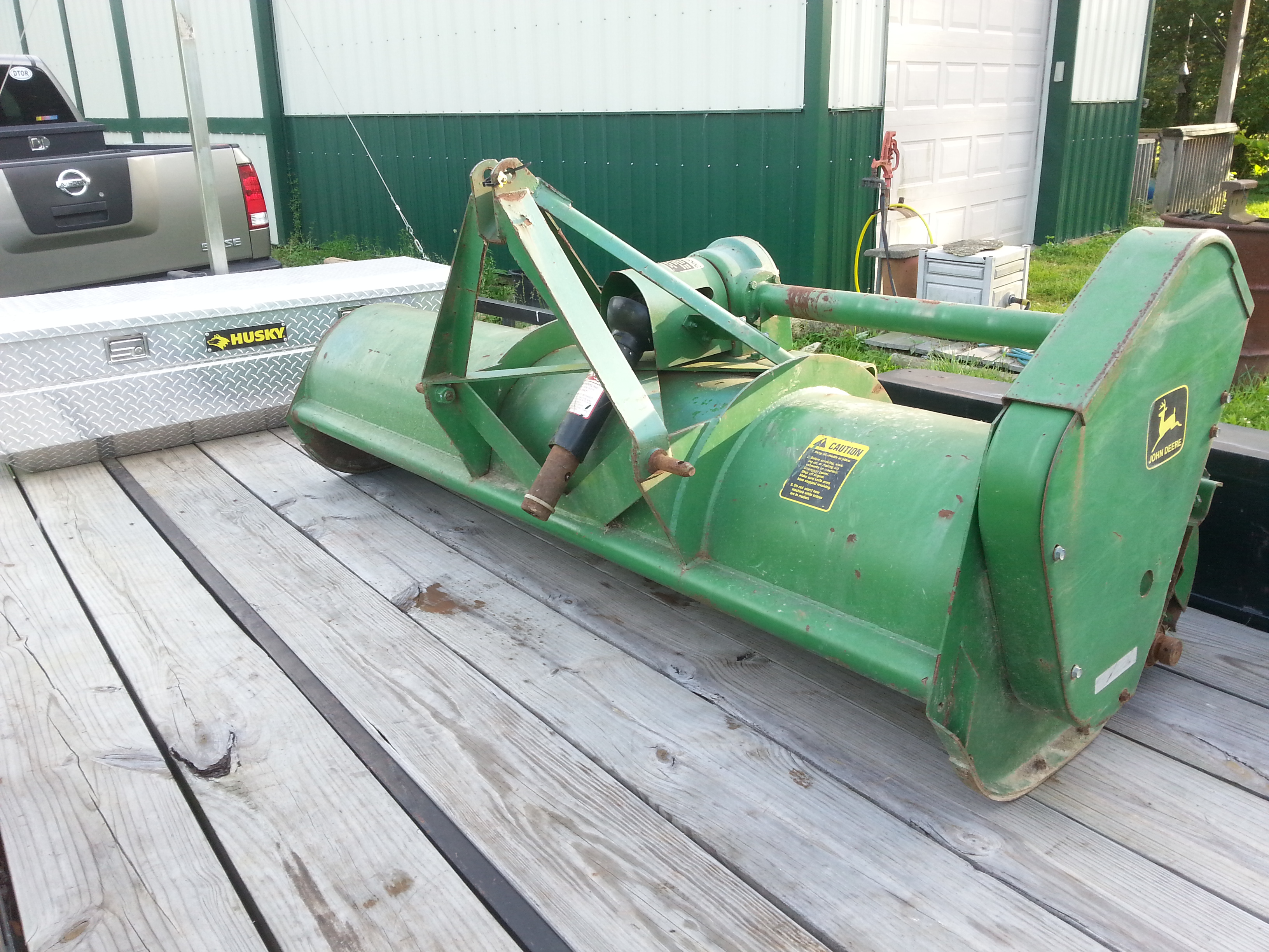

Second: I need you to take a picture preferably several pictures of side weldment with the V belt guard cover in place and then removed.
Third: I will need you to wipe away all the grease and rubber dust if possible to expose the drive belt side weldment of the flail mower to expose the bearing hub and the belt tensioner arm and grease fitting. Plan on purchasing a new drive belt anyway and preferably a kevlar V belt for it.

You need to obtain the replacement scoop knives, knife hangers and bolts and nuts to replace the scoop knives that are gone. Please use blue loctite to secure the nuts and washers-yes you need flat washers.
Preferably ones using Allen head caps screw bolts eliminates a lot of money going in the swear jar as all you need is a long 3/8 breaker bar and a long handle allen wrench to remove them as needed as the breaker bar will make quick work of loosening stuck nuts that are passing over dented bolt threads. They cost a little more but they are very difficult to break as the allen head bolt holds the wrench securely preventing slippage and skinned knuckles and money flying into the swear jar.
Humor me and take a clean piece of paper and a good pencil like a carpenters pencil and place the paper on the name plate and rub the pencil over the numbers and then take this paper with you to the dealer that way you can show them exactly what you have and you cna purchase a 25A manual from them too.

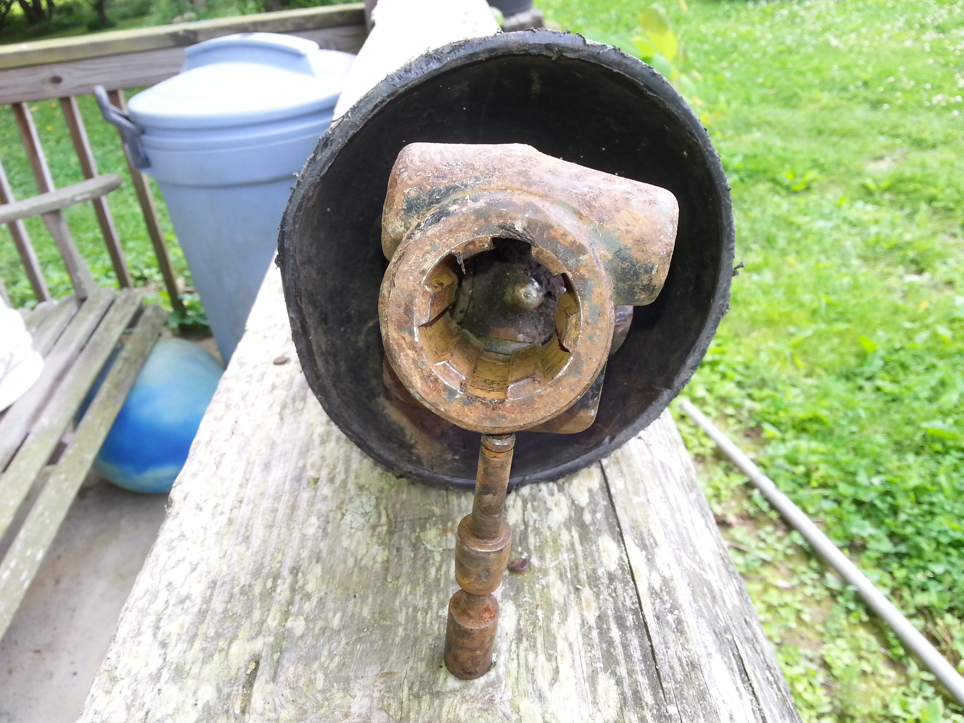

Just so you know the PTO Shaft that you may have hanging around may not work with your 4740 mule and the JD25A so be prepared to wander down to TSC or Menards or Farm and Fleet for a new one without a slip clutch.
I need to know more from you as you may also need to cut the new PTO shaft to the proper length for your mule and we will get that right the first time.

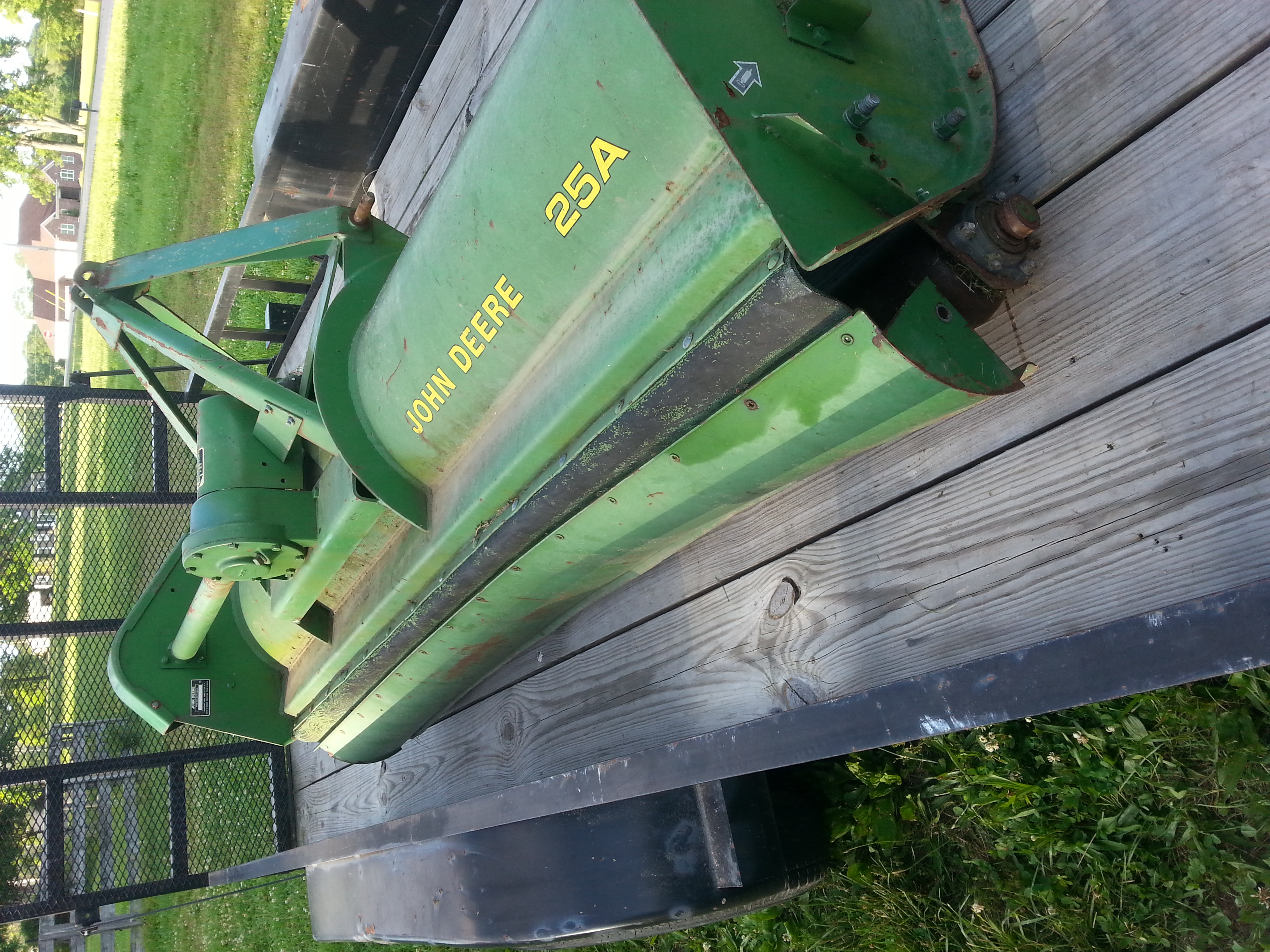

Alrighty now. You want photos. I got photos.
Let's see how this works. More of underneath if this works. (fingers crossed)
   / New member. New owner JD 25 A Flail mower. Help!
Groovy. We're in business.
In the bottom of each photo, you will see me holding up one two or three of my fingers.
You can probably guess that is to identify each of the three rows of hammers.
The pto connection needs a spring and whatever retaining hardware is missing. Clean and grease and I'm optimistic I'm good to go.
One more of it on the trailer.

Thanks for uploading the photos. I would like to see under the V belt guard when you can do that.
I think you need to invest in a new shaft as that one seems to be pretty well horse whipped.

I have one endplate for the right side as you look at the rear. Somebody has backed it into something stronger than the back cover, so that will have to be removed and beat out with a rubber hammer, or a block of wood and a sledge. I'll be looking for suggestions. I'm pretty sure no blades were hitting it, so it's not a major big deal.
I pushed on the main rotor shaft with the blades and could get no movement at the bearings whatsoever. The roller was solid on the left side and the right only had a hint of looseness. I'll be keeping an eye on it.

Any guesses as to why my serial seems to be in Spanish? The warning decals are in English, but they could have been replaced I suppose.

It was assembled and painted in Mexico where they build their line of Frontier implements.
You have a forever mower Ribz as that unit today would be $7,500.00 Plus
Lots of manufacturers simply tag the implement with the order number/inventory number
to identify it so no worries there.
Who ever told you the number was not correct they were mistaken.
All the numbers and letters on the name plate are what is referred to by Deere as their "Product Identification Number" or PIN.
Please be sure to mark the number down and keep it in a safe place as the 25A flail mower would be extremely expensive to replace if it was stolen.

Could it be the dealer just needs the 6 digits on the end and not the entire number? Try just giving them the numbers after they get past the model.

BTW: My pto shaft was missing the tractor end lock cylinder, I just drilled it out so I could use a bolt and lock nut.
