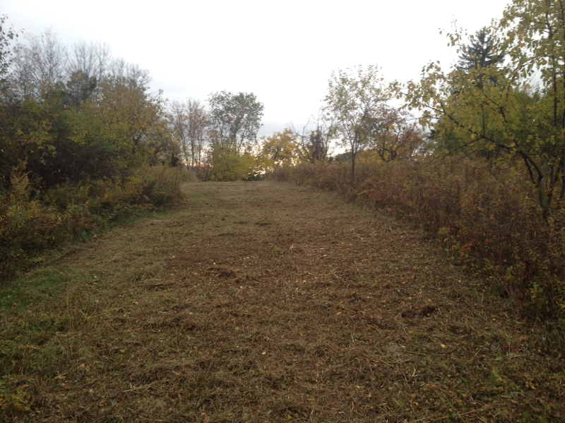

I got mine from one of my father's coworkers. It's likely an older model, as stated earlier it's truly beat to snot, the hood is tweaked, if I lift it while spinning one of the knives will contact the housing and make a terrible racket, but the rotor bearings were good and he gave me a bucket of new duckfoot/scoop knives and hangers with it and a new belt.
I picked it up for just $300, checked gearbox oil, replaced missing knives, greased it, and have been running it ever since.
Here are a couple pics of my field done in a single pass. Mind you, most of my knives are dull, I only replaced five of them! You can see to the sides how high the field was to start. Some of the tall stuff just layed down, but most was mulched up nicely.
Those tall weeds were well over my head while I sat on my MF35 Utility!

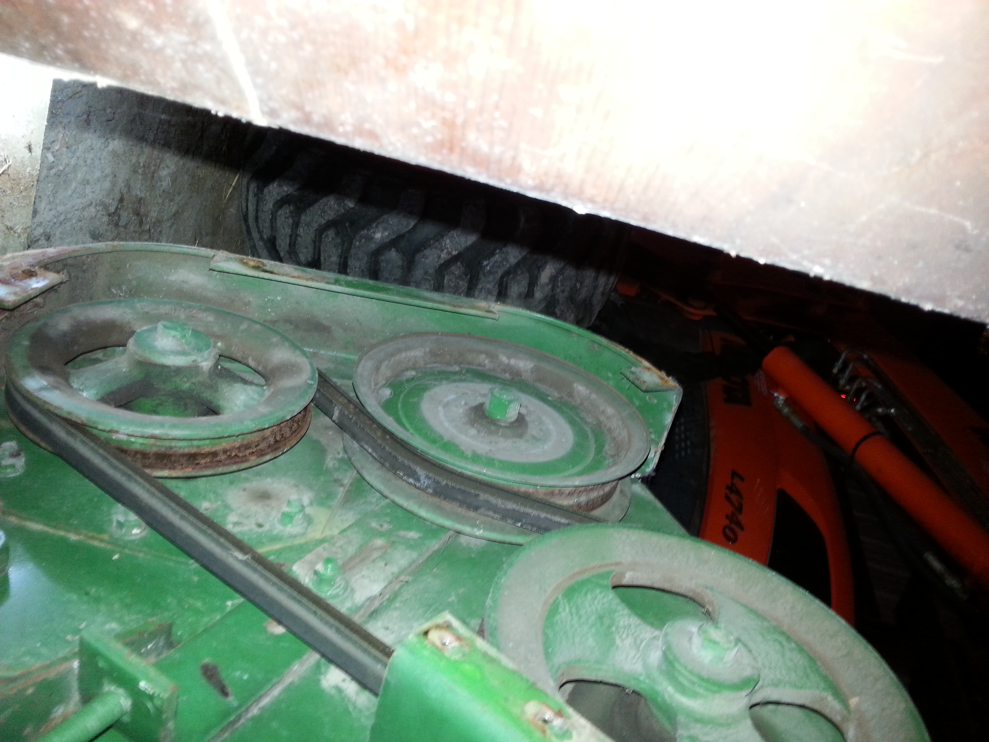

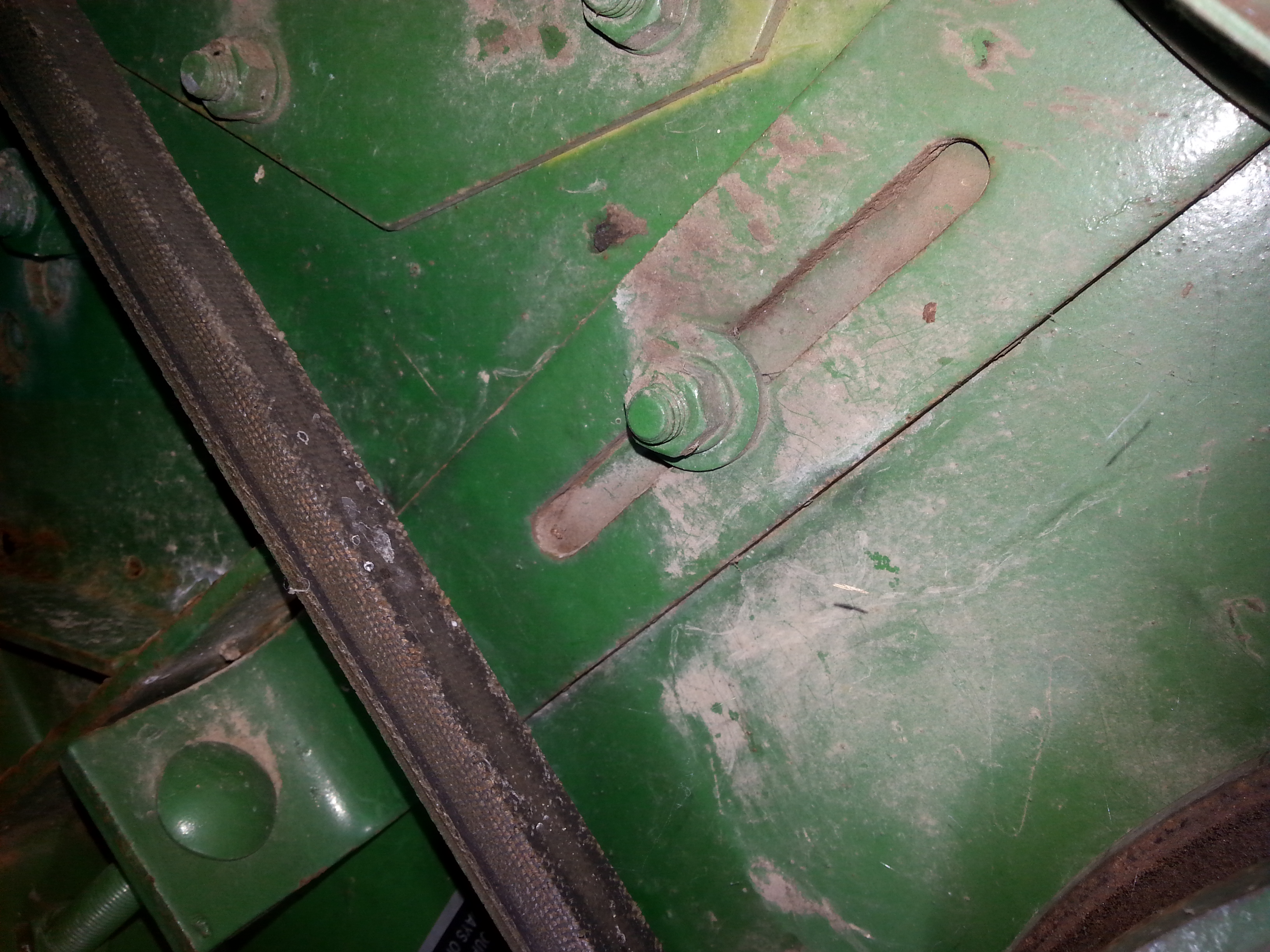

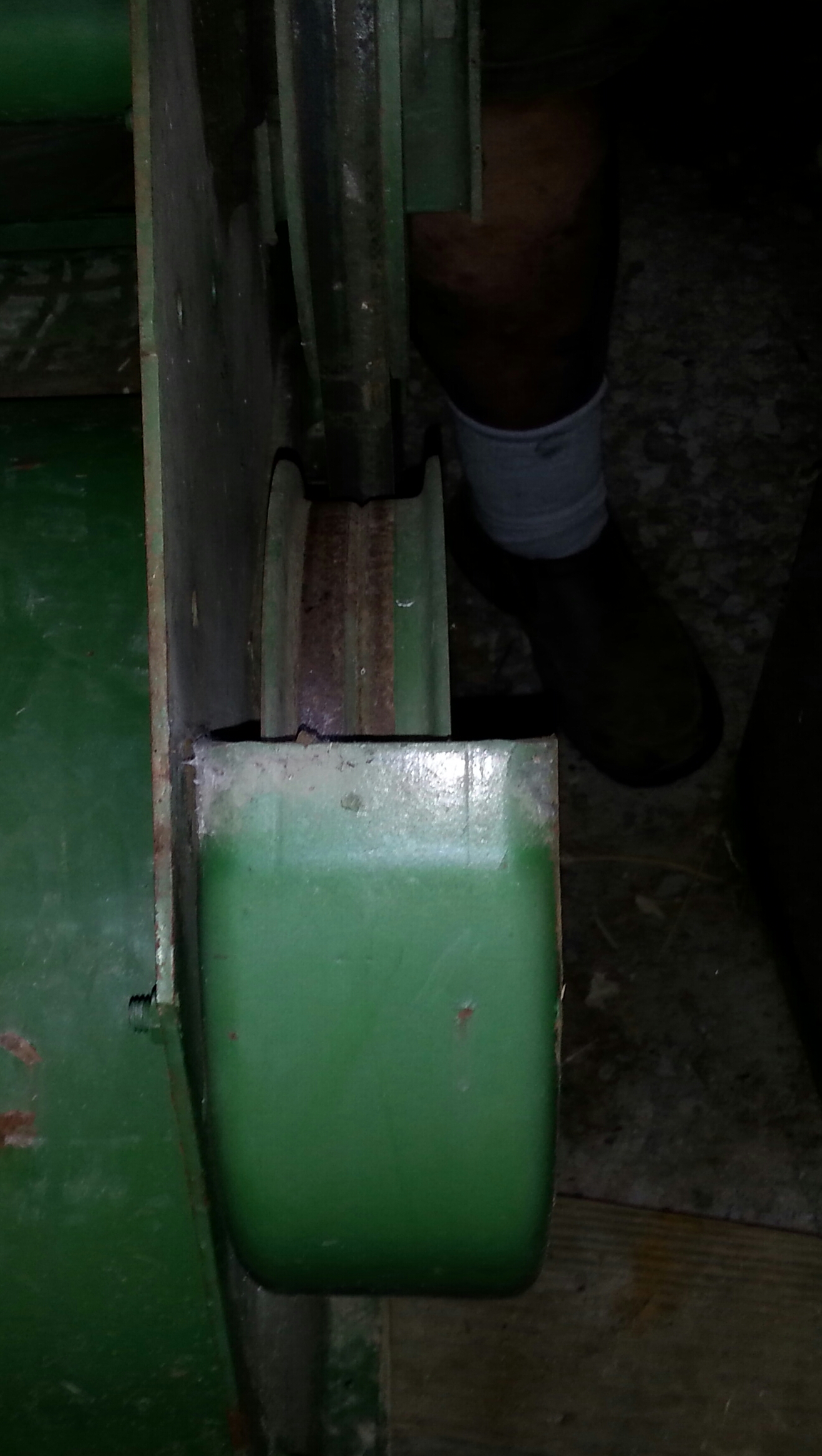

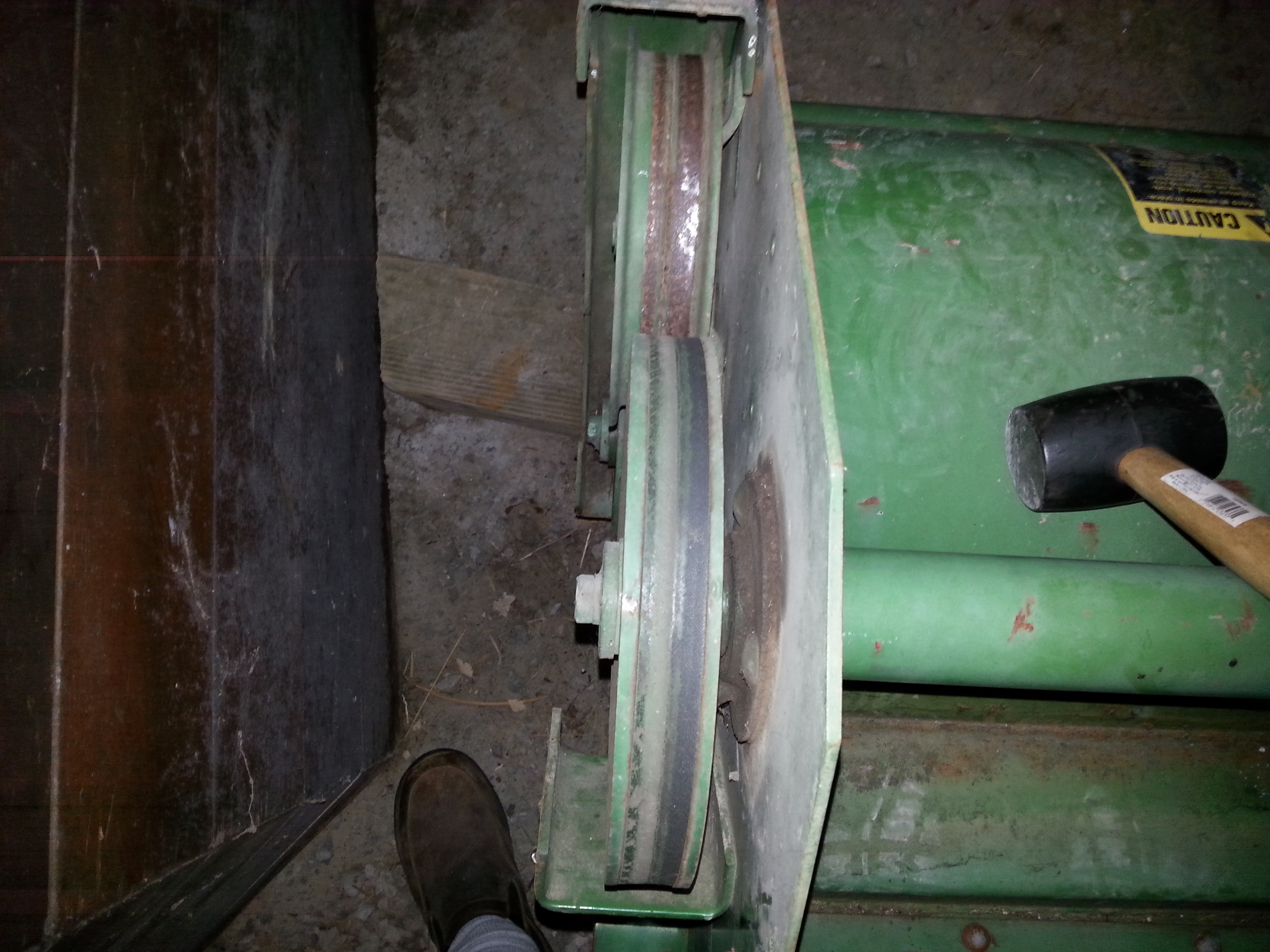

Ok I got caught up, (now that's funny). Ok, maybe not caught up, but I got a chance to pull that cover off and take some pics of the belts and pulleys. It's stored in a tight place in the barn, so I was limited on my camera angles.
Admittedly, I don't know what problems to look for, but things looked better than I had a right to expect. Paint looks nice under there. Belt isn't new, but looks decent to me. 20170530_214542.jpg
Pulleys have light rust on the contact surface with the belts, the rest has bright green paint.
So what's the panel's judgement?
   / New member. New owner JD 25 A Flail mower. Help! #28
You need a new belt and you need to back off the tensioner to assure you can remove the old one and install the new one as the belt on it is original.
