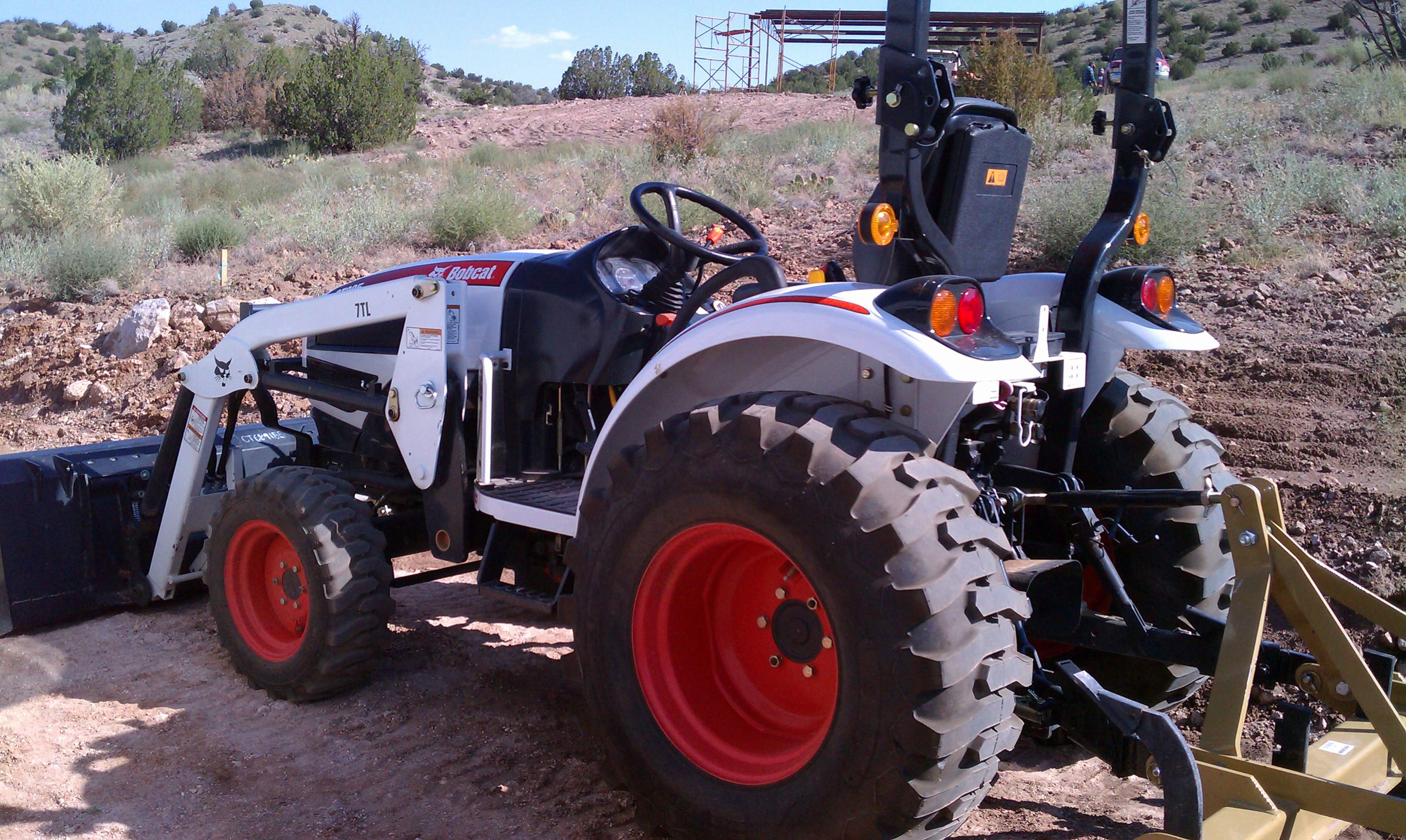

   / New Member, New Tractor CT225
#12
My tractor:
