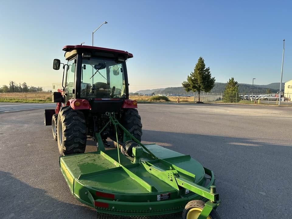

I have a TYM T474 HST with a cab (48.3Hp), I now have 405h on it, never had a regen request. When you work them hard enough they will do passive regen. Here I got it with my 6' JD LX 6 rotary brush cutter.
LX6
