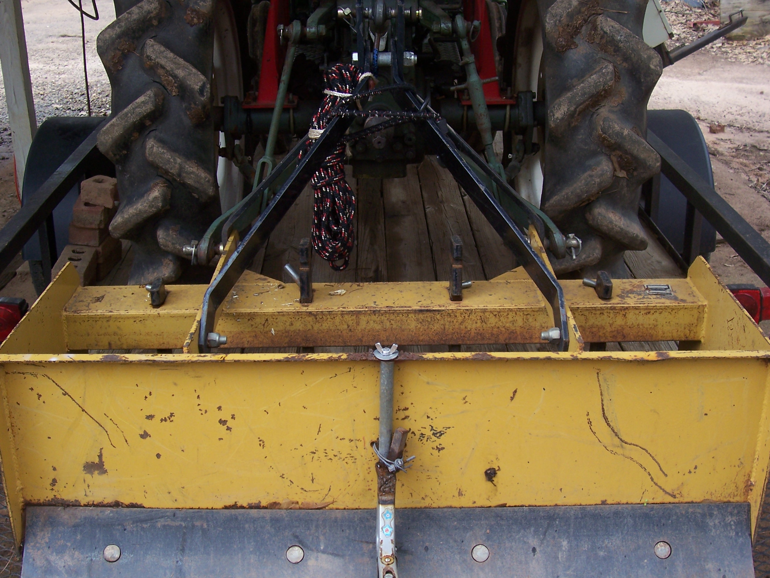

FWIW I use a ym2000 2wd. and a box blade on my 600Ft. Dr. with org. rice patty rears. With crush and run. When I grade it I can/will stop my tractor dead easily. Not by lack of HP. which is the same as the 220 according to Tactor Data but Traction. And it's mostly level with only a hundred feet tops on an incline. I use a BB. also on the JD. 55Hp. 7FT.BB with AG,s. Compare it of the R.patty's I won't even consider removing them. The R.Patty rears are a little rough on my front yard using the FM. but that's only if it has rained recently. Here a pic. of it and you can see the tread of the RP's.
