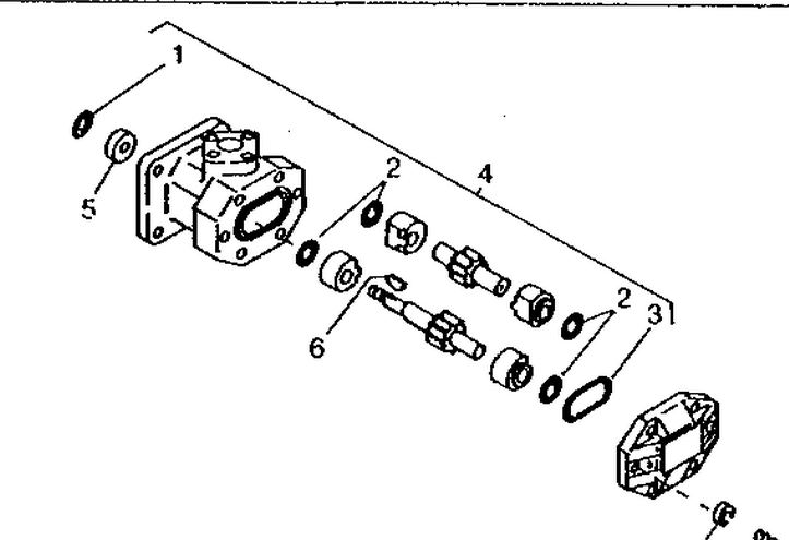

Hello, my name is Gary. I have a 750 John Deere 4wd w/Front loader which I have had VERY good luck with,a 318 John Deere w/ Onan ( which I rebuilt after a wristpin keeper came out when it was about ten years old ) and a Case 580B, which I had to rebuild about a month after buying it when the end of the camshaft broke off right behind the gear. My problem right now is that the 750 Deere, which has been pretty good up until now , lost all hydraulic pressure when I started it this morning. I could usually hear the pump as soon as it would start, but today there was no pump sound and no pressure upon starting. I'm hoping that it has a pump key that has sheared. Anyone else gone through this?

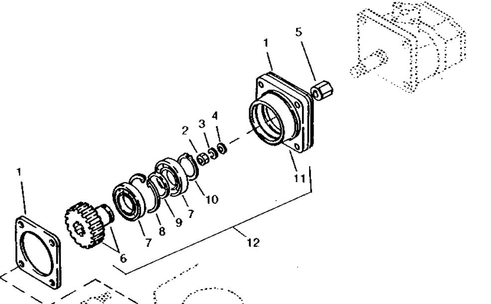

garyl,
I looked through the Technical Manual and there is no keyway. The design utilizes a hex shaft to keep the gear from spinning on the shaft, and is gear driven. I'm guessing the parts are not available individually. Are you certain there is zero hydraulic pressure? I trust the fluid level is normal.

Gary, Here are some pics of your pump and drive. Does the pump make any noise at all? Did you hear anything pop or crack when you started the tractor?

GOOD NEWS- 2 bottles of dry gas fixed it right up. It did take a little longer than I expected ( about ten minutes) but it did work. Thanks to everybody who offered assistance
