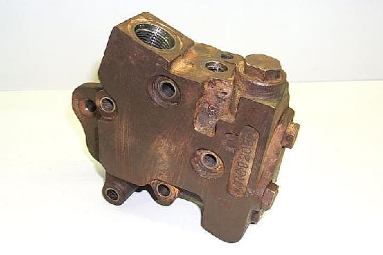

Most of the tractors I've seen power the steering off of the hydraulic system. But, apparently on your tractor, JD chose to do something different.
What does the steering gearbox look like?
Perhaps you could adapt an automotive pump, running off either the fan belt, or the crank.
Does the rest of the steering system seem to be intact? I'd hate to spend $1000 to fix the steering pump, only to find that one also needs a $1000 steering gearbox.

Sounds like he is missing the crank driven hydraulic pump.

I have thought about adapting an automotive pump. From what I'm reading my tractor is closed center hydraulics. If I understand correctly. That means this factory hydraulic pump must have a relief system built in? I am also worried an automotive vane pump might not handle the weight of a loader? I was thinking maybe a gear style pump off a heavy truck.

The pump I need is for the steering only. Their is also another main hydraulic pump that runs the loader and three point.

Take some photos of what you have, and what you're missing, as well as the steering gearbox on your tractor. Do you have the part diagram/photo of the part you are missing?
If it is steering only, then I still think you could run an automobile power steering pump off of the fan belt, assuming you can find a place to mount it. I suppose it depends a bit on whether you are trying to restore a show tractor, or a work tractor.
Some tractors appear to have 100% hydraulic steering, so without hydraulics, there would be no steering.
How does the tractor seem to work without the power steering?

Not looking for a show tractor. The part number is AR39029. I did not see any on ebay. The steering column is a hydraulically assisted mechanical gear box so it works without pressure to it. It just turns really hard, especially with the loader. I'll search for a factory pump at a reasonable price for awhile. Then I may just try a car pump.ar39029.jpg

If you look on E-Bay for:
Deere 1020 Power Steering
You will find several Power Steering Conversion Kits for the 1020.
All with belt driven pumps.
Prices $600 to $700.
Perhaps you could just buy the pump. I'm also seeing a couple of vendors with the kit with a google search. Perhaps you can write to them to ask for more details.
If it actuating a 2-way hydraulic cylinder, perhaps the reservoir and actuation needs would be different than for autos.
There was apparently a thread about the kit on TBN a year ago. Maybe you could try contacting the original poster on that thread.

I like the idea of buying a pump out of one of these kits. I will look into this.
