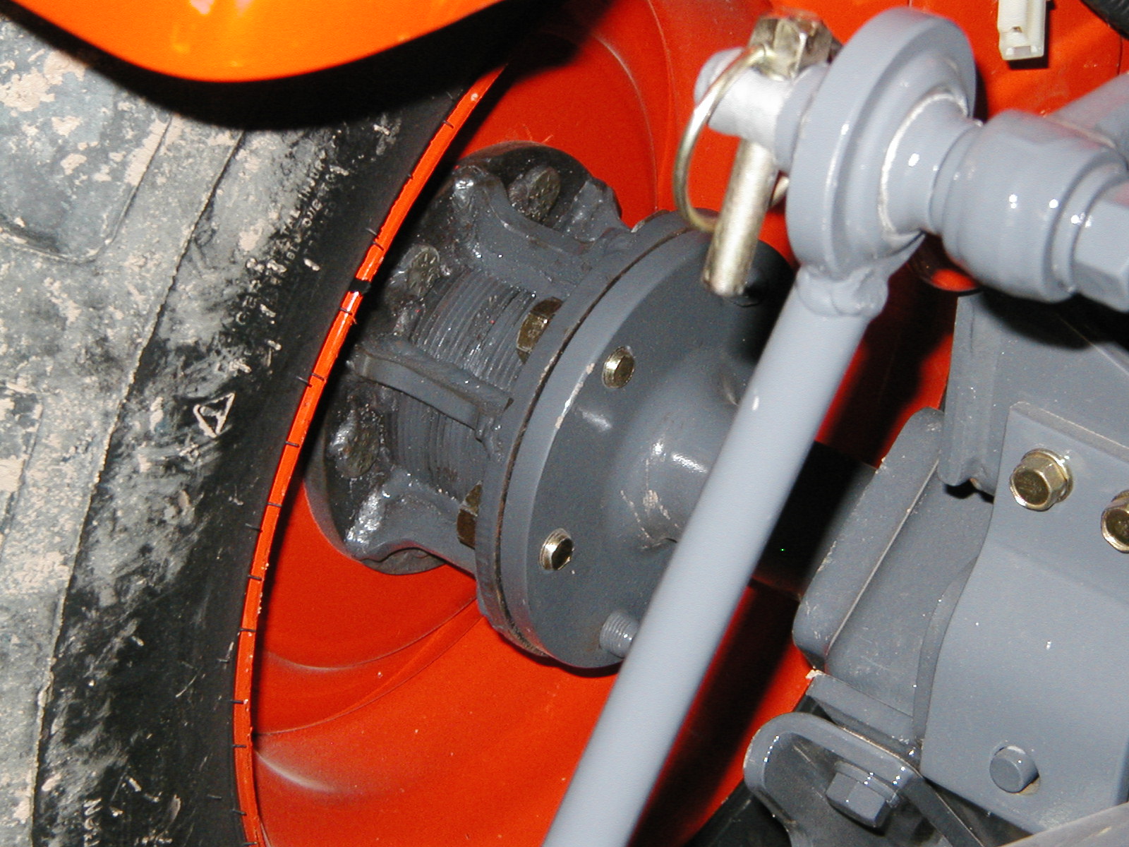

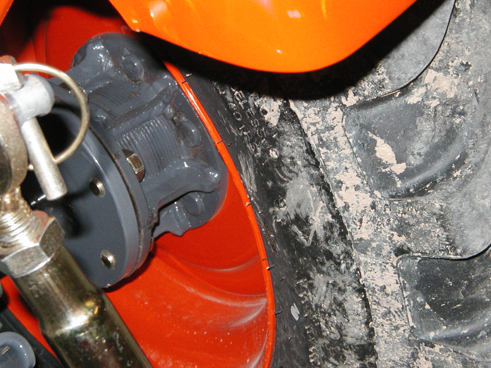

I also live on an hill and had 4 inch spacers installed on the tractor. Made a big difference when going around the hill instead of up and down.
   / New member with CK20S on the way #23
Where did you get the spacers? I sure could use some of those.

My dealer has them made for him
