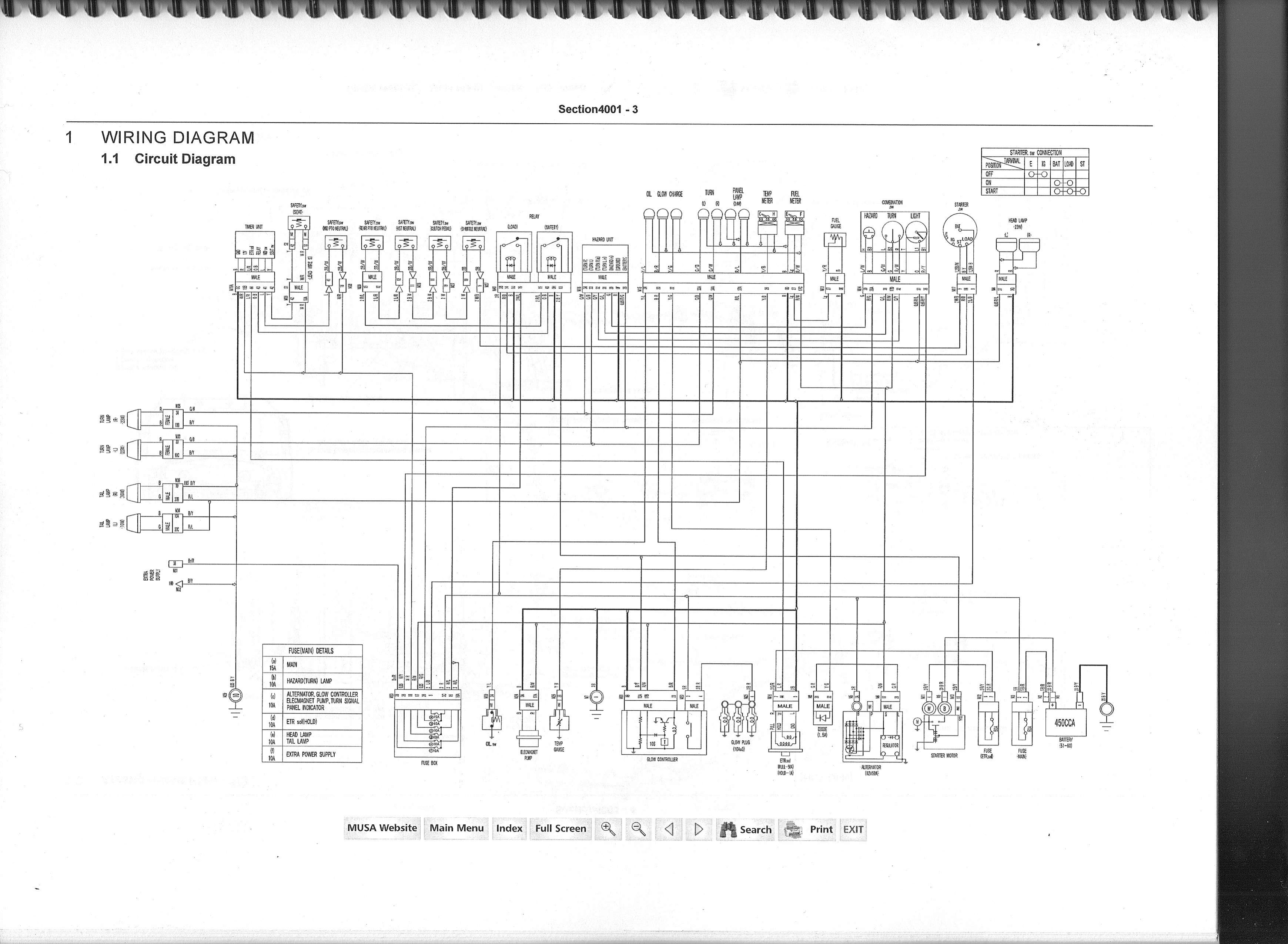

Any idea where I can get a schematic telling me where all these solenoids are?

Here you go.... I hope that it is big enough for you to use for troubleshooting your issue.
good luck and post your results
