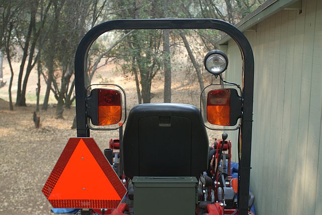

ON my GC1715 I moved then inside... Didn't take to long to learn a replacement light assembly costs $127.00.... Just swap them side to side, use a couple of washers on bolts between ROP's and fixture so you don't squeeze wire and a few ZIP ties down the ROP's bar....
BUT on GC 1720 with fold over ROPS bar and swiveling seat for BH operation area may become a little tight....
