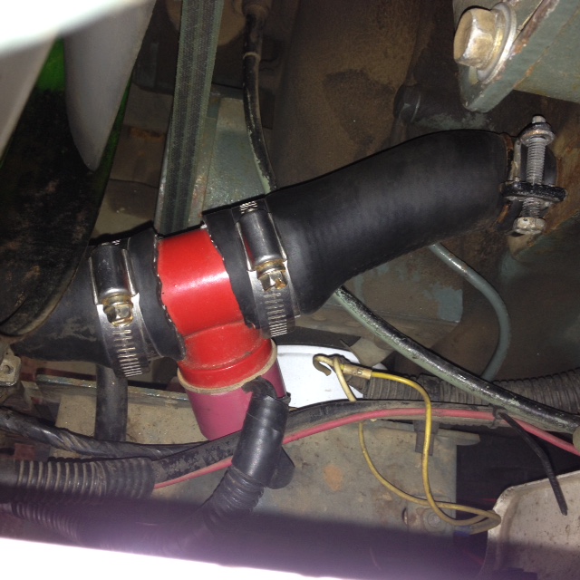

What size lower radiator hose to get i noticed tractor supply has all different sizes of them. And i have not changed or removed the fuel filter
   / new member with yanmar problems #23
I think the hose was 1" and the heater may have been 1 1/4". Its been a while since I did it so I don't remember exactly. Looking back I should of kept track of the parts used. It was all off the shelf items at TSC. The hose is bigger than the original hose which is 3/4". It was one that had a couple of bends and I cut it in the middle to make the bends work in the tight space. I tighten the clamps down and have not had a problem in 3 years of running it like that. I do take it out every spring.
