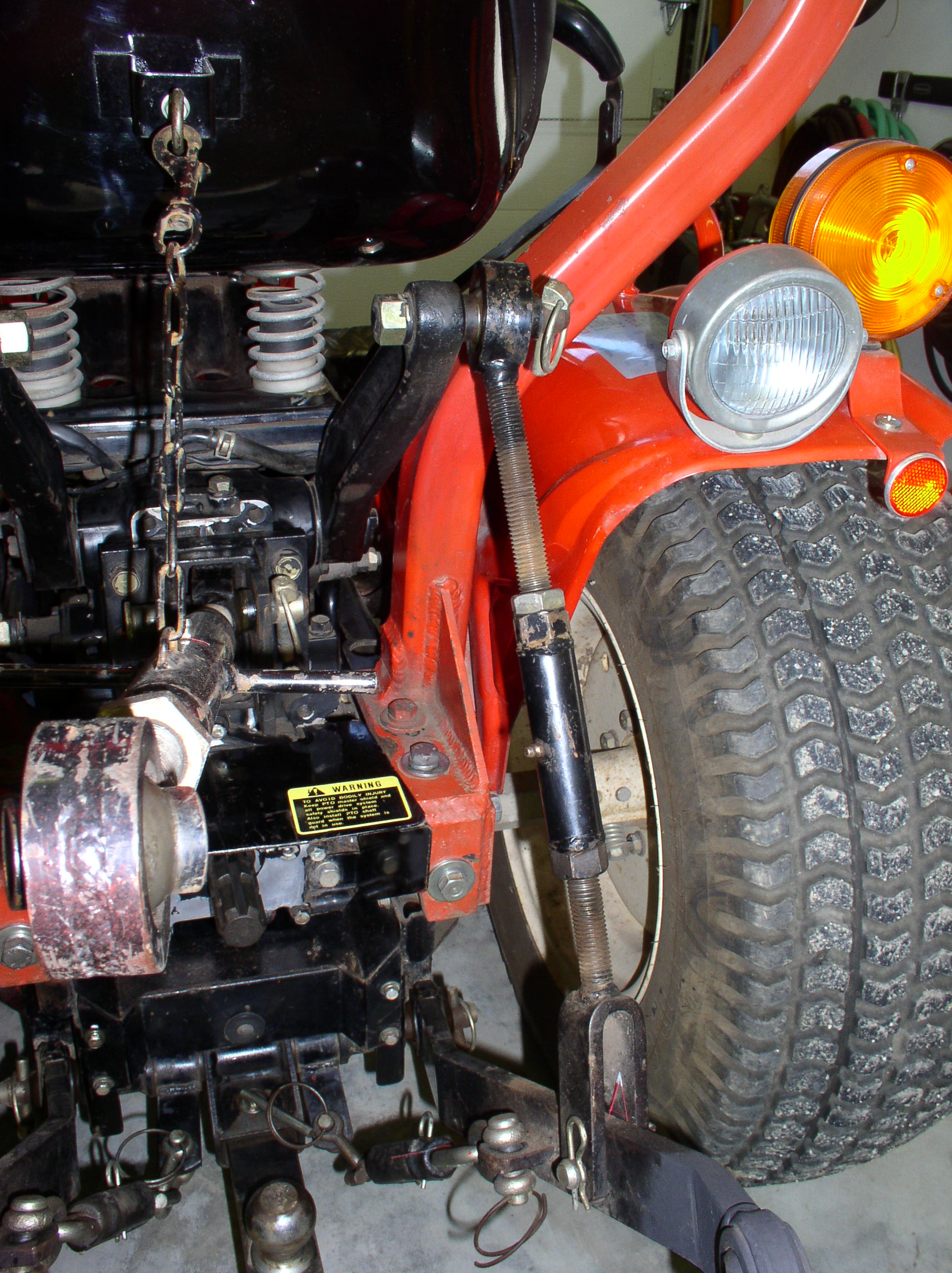

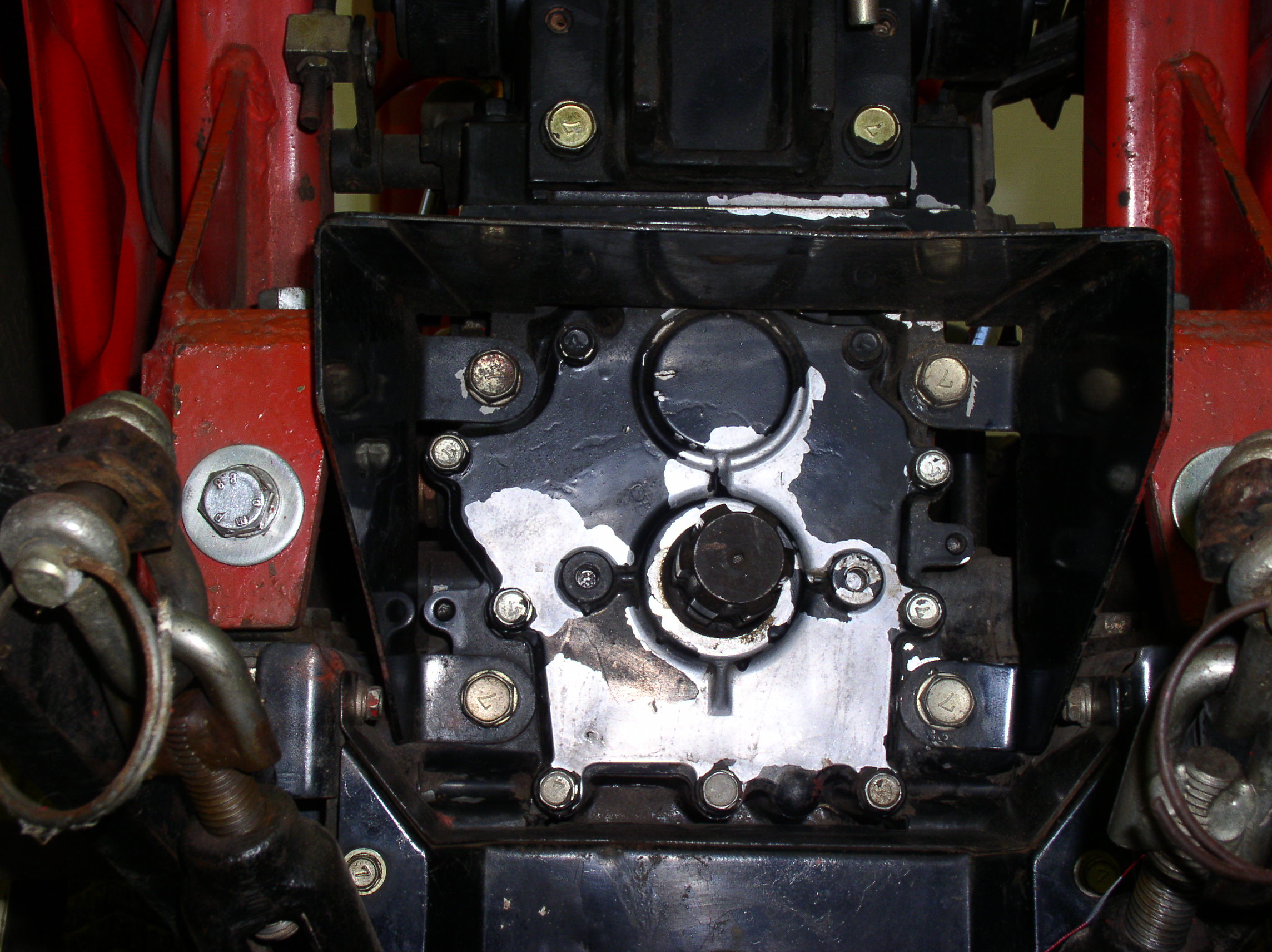

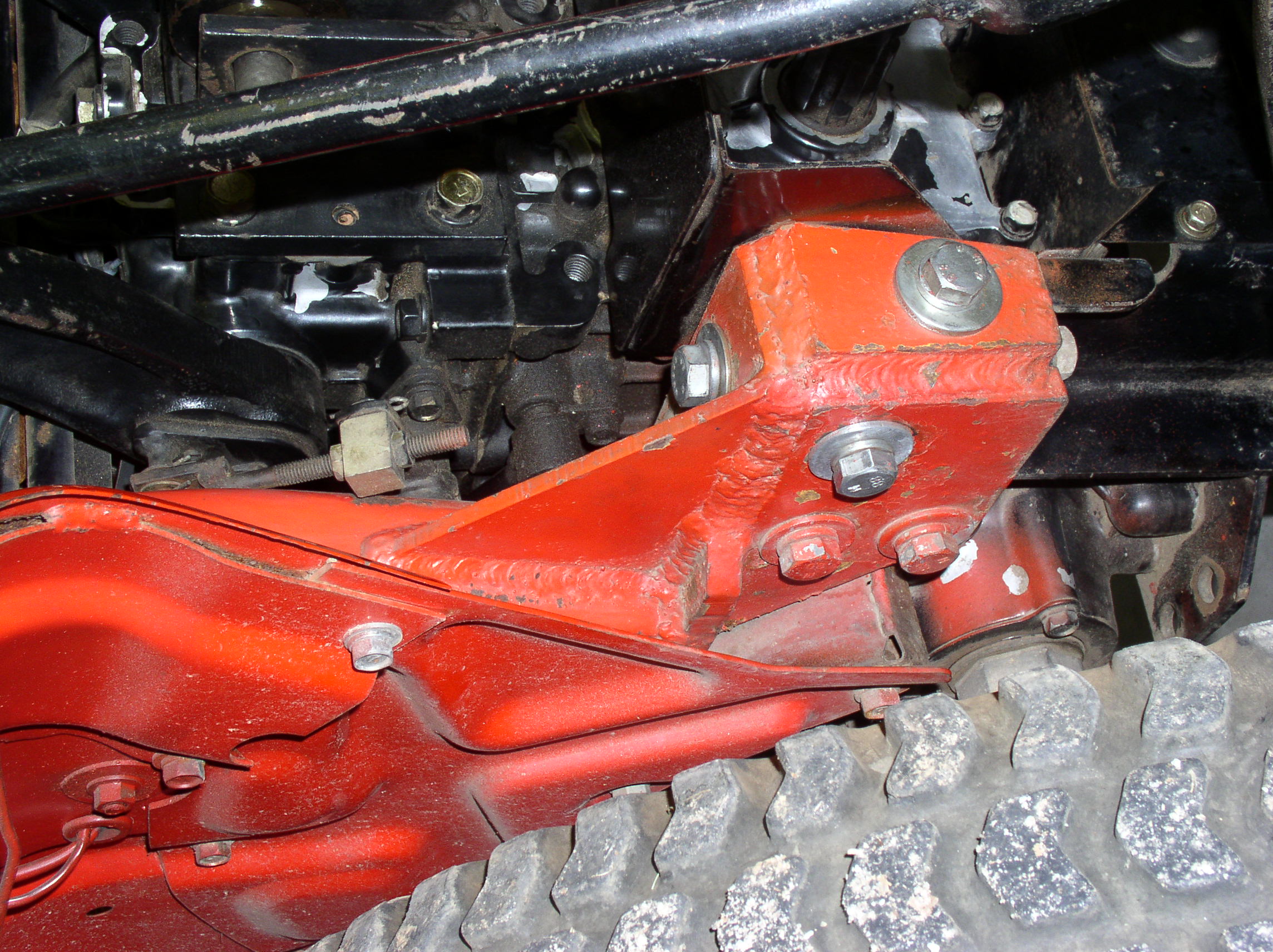

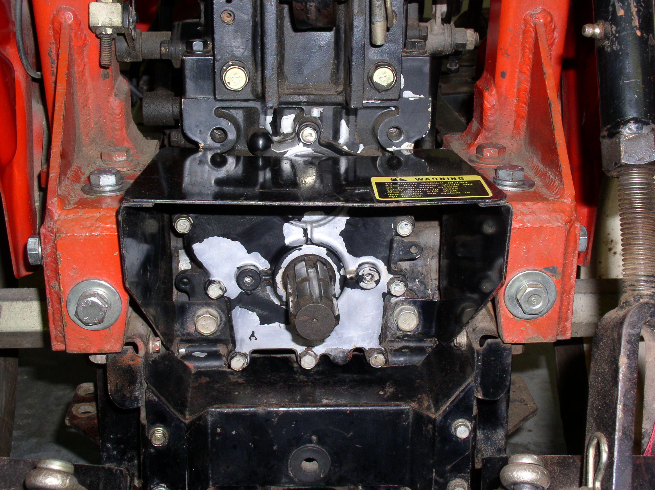

Mike, here are a few photo's of the rops mount/pto cover setup. The rops mount wraps around the end of the frame rail as well as the sides and is held is place by some large bolts. Hope this helps.

Thanks Jim for the pics. It looks like this was constructed after-the-fact. Certainly looks sturdy enough. What does it have 2 or 3 bolts on the top, one from the side and then one from the back? 4 times 1/2 inch (???) bolts on each side will take alot.

Mike, Looks like three on the side, three on top and one from the back. Its rated for 3500 lbs, serial # CP 855-10-2. It was made by Custom Products of Litchfiled, Minn. Their still in business. Here's the link: Custom Products of Litchfield. Thanks, Jim
