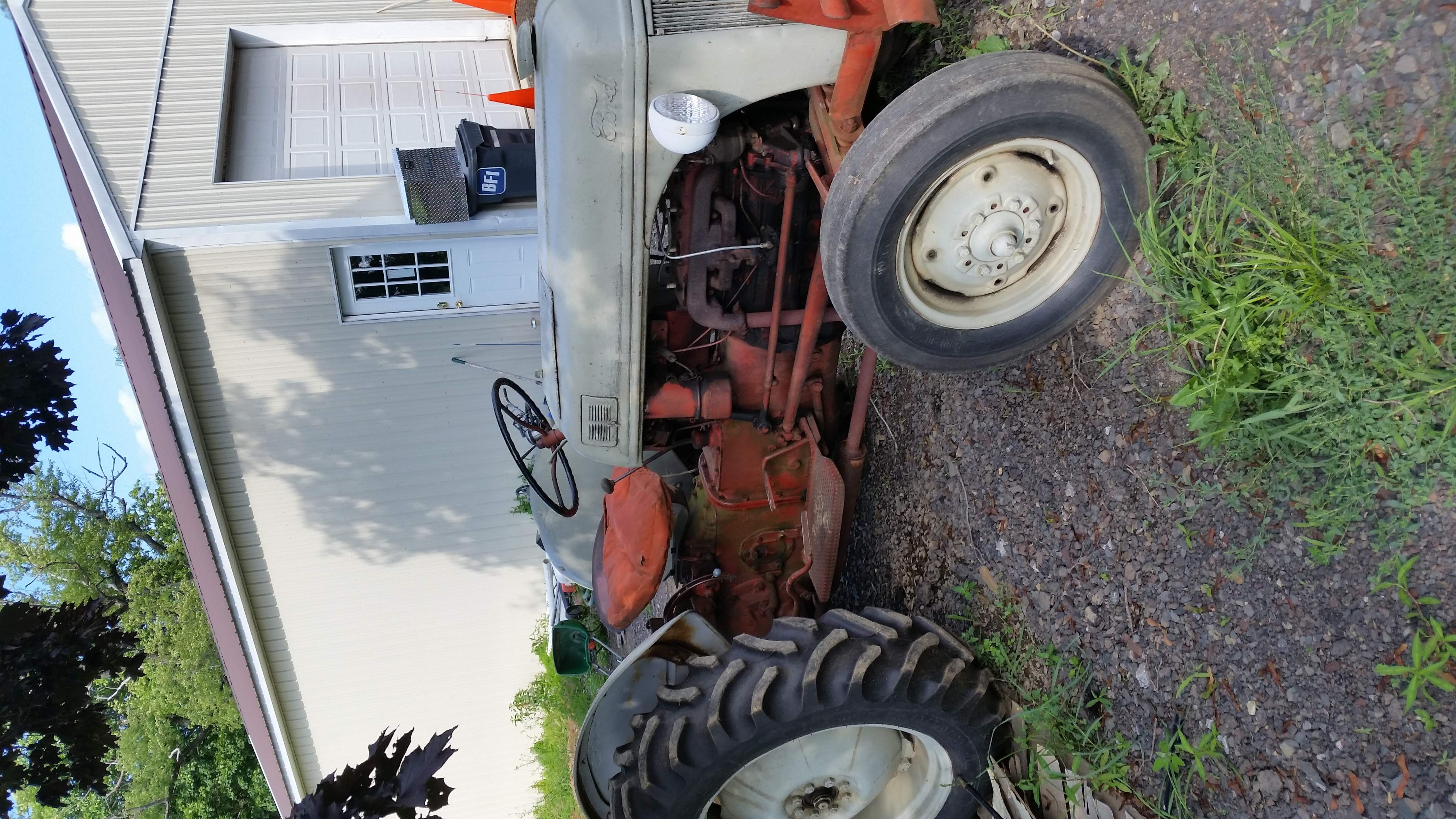

it has 4 speed and a reverse. Here is the tractor 1.jpg picture of the tractor
   / New member #18
Hello, you have an 8N late 1951-52 as it has a tach and side mount distributor. Edit; Done a little research. found out it was 1950 -52 with the tach and side mount dist.

Thanks Jim L. Now I can order part so I can do a tune up
