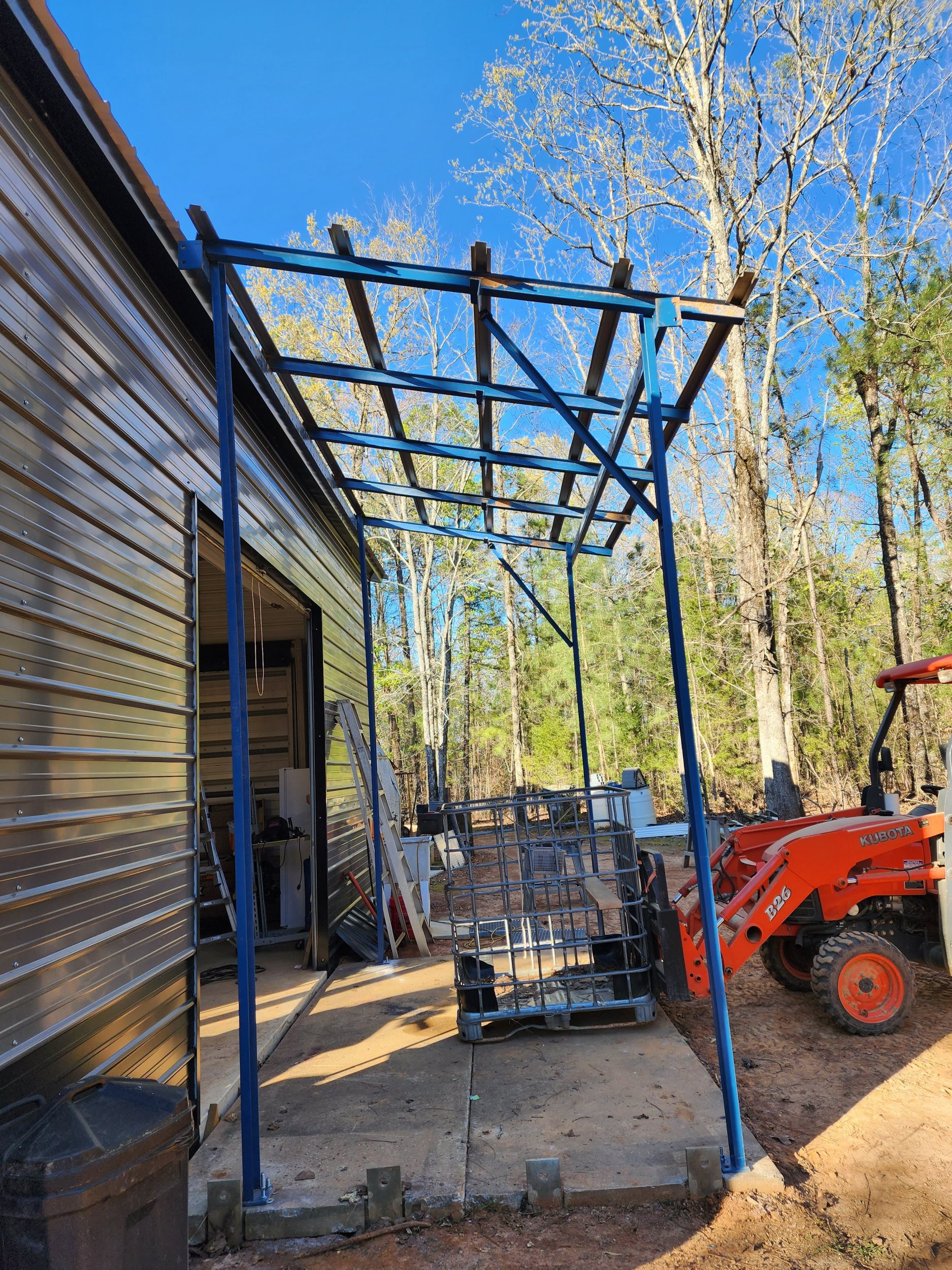

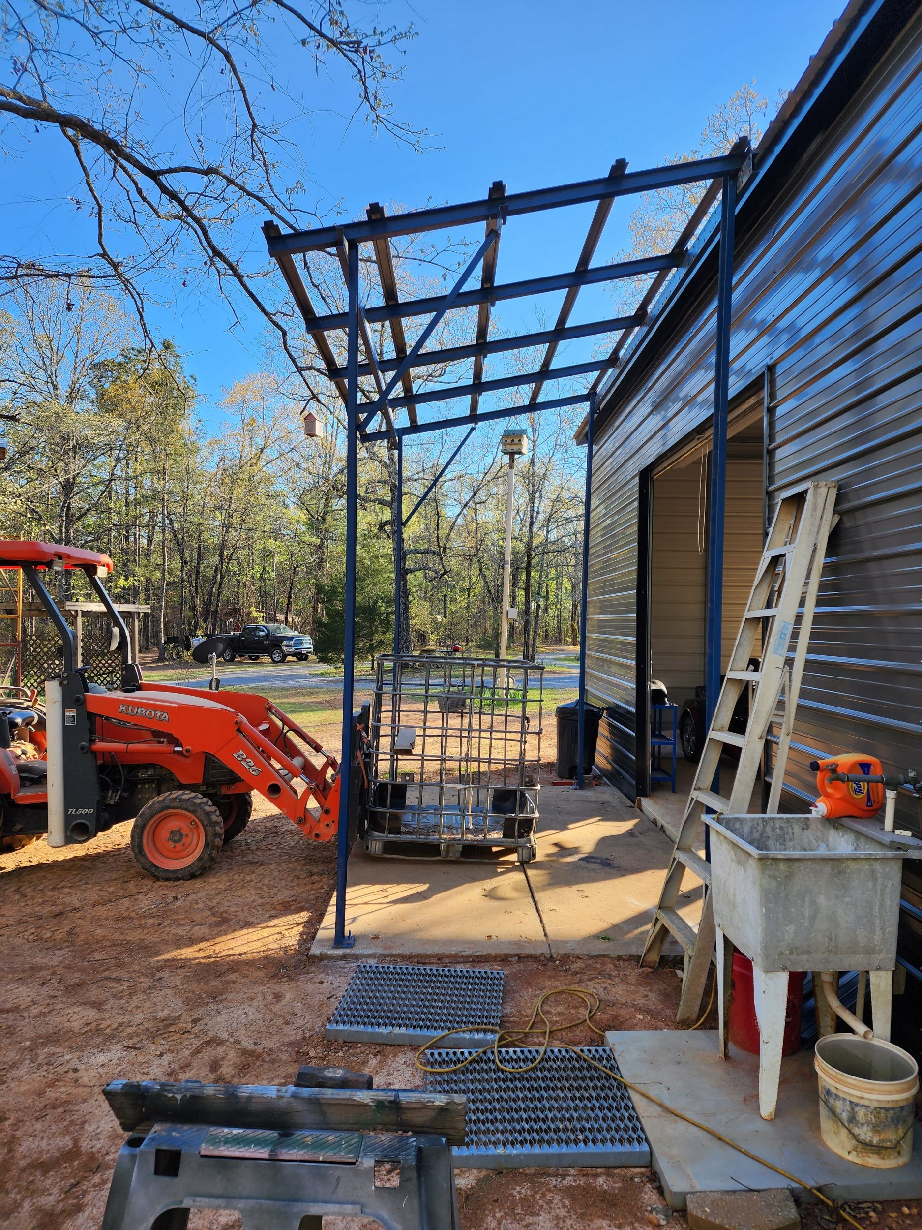

Had a friend donate some steel to me so I put it to use and built a porch in front of the 10ft rollup door, the post are 4inch channel and the rafters are 3inch beams all welded together. I scored the Hat channel for 28 bucks a 20ft stick the local roofing supplier was asking 60 bucks. I will tie the roofs together with the roofing metal. Hopefully this will stop the rain water from coming under the rollup door.
