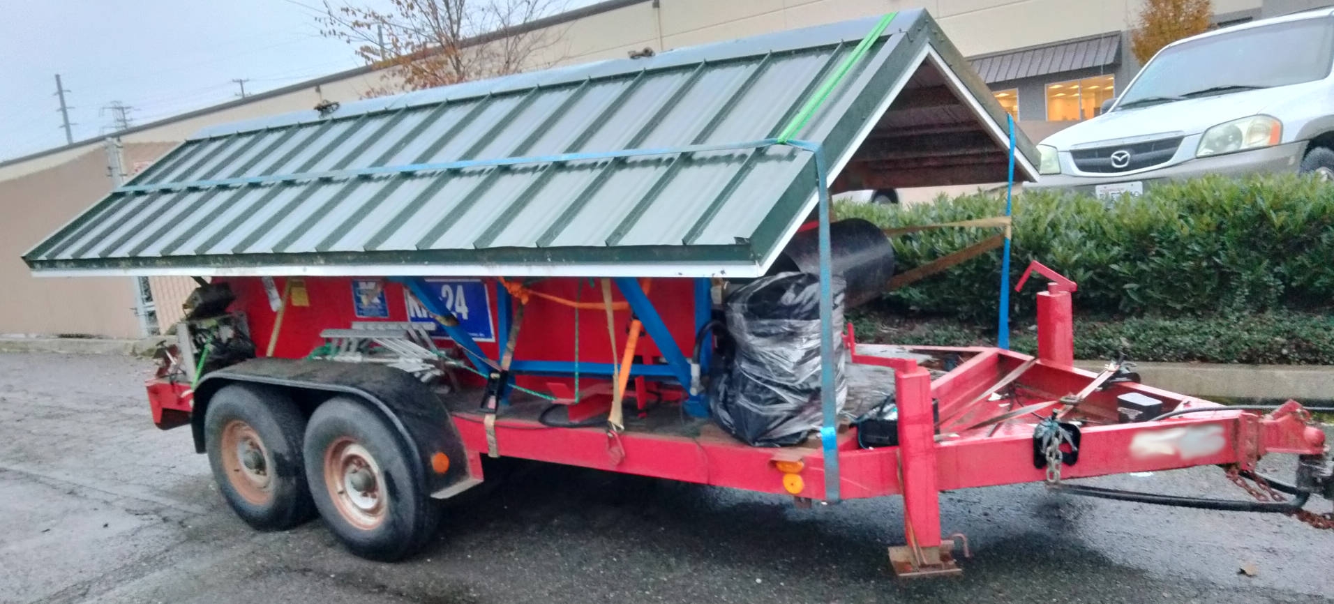

After quite a bit of scouring, I found a used roofing machine on Craigslist. Shipped to me down from Alaska.
So next summer will be about learning to make roofing.
This is an older type of crimped standing seam. While there may be some options to change patterns, it may well be orphaned by the manufacturer.

That custom roof over the machine is very cool too!!
The photo was taken in Seattle, 300 miles away. I added a couple of extra straps just in case it wasn't a 70 MPH roof. But, overall it held up well for the trip home.
The roof has 2 shackles on top for easy removal.
Overall the roof is handy, however a roof without walls lets too much condensation into the machine. Apparently some of the rollers need cleaned up a bit, so I'll probably have to do some tear down this spring.
I'm also learning that things like metal coils are heavier than I had otherwise imagined. And I'll have to figure out how to deal with trim work.
