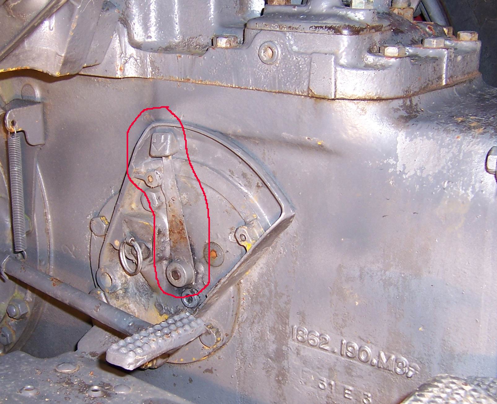

Next to my hydraulic dipstick there is a mystery lever. Anyone know what it is and it looks like that area is supposed to be covered by a panel. Will it hurt anything by not having that covered up?

That lever near the hyd dipstick is the draft response control lever. It is used together with the draft control lever above it to adjust the reaction speed of the draft system when using a ground engaging implement like a plow. Sometimes an implement will cause rapid changes in the draft load and the implement will bob up and down. The draft response control lever can be adjusted to minimize this motion. You're right--the panel that covers that lever is missing.

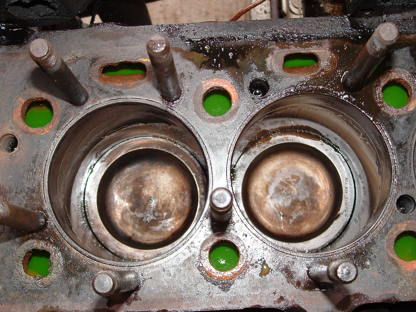

Now if I can just figure out how to check the timing. Which is the number one cylinder? Closest to radiator, middle or closest to operator? I have hooked my light up to all 3 and can't see any flywheel marks when it flashes.

I've looked into my MF-135 service manual. I can't find any info on cylinder numbering. All I could find is the firing order, which is 1-2-3, and that the #1 valve is nearest the water pump end of the engine (the front end).
   / New MF 135 owner #16
Heres a picture of my perkins gasser with the head off. The pistons are numbered, 1 being the one in the front. Good luck! TB
