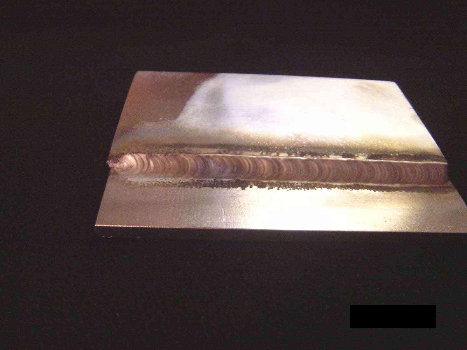

I know you've seen me do it.;)
But one way to get more power out of an underpowered Tig welder, is switch to DC, and use helium for gas. You can pretty much cut your amps in half compared to 100% argon.:cool:
