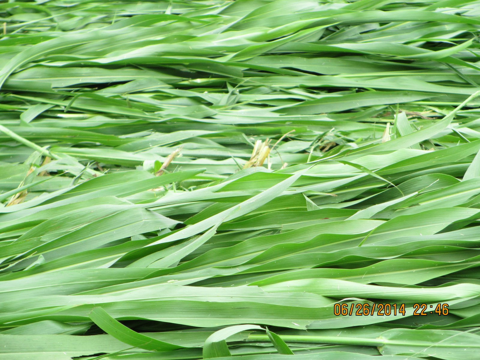

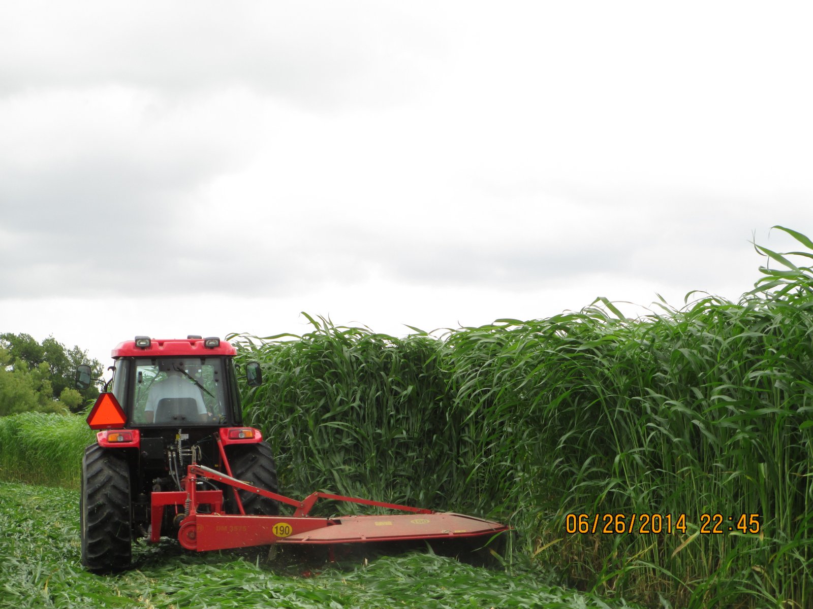

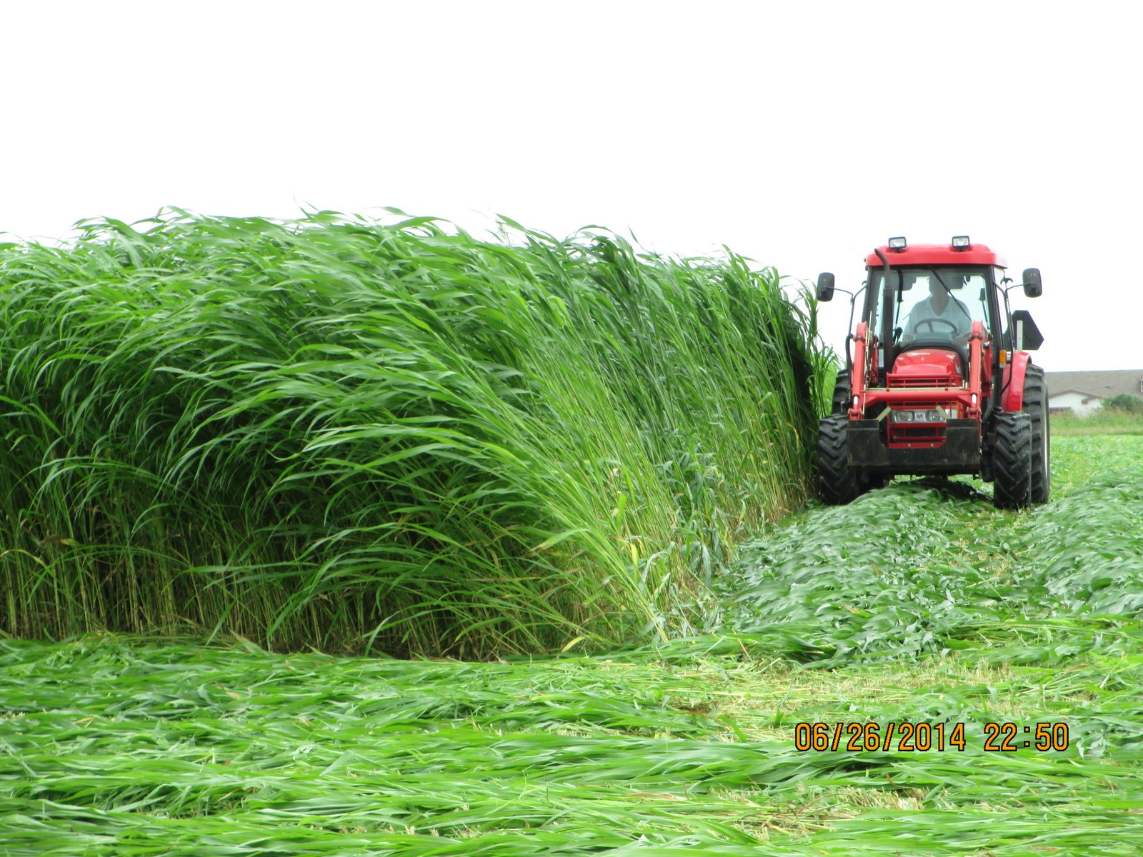

I had my belly full of sickles and said there had to be a better way. Started looking at used discs as new and disc MOCOs were totally out of the question for my bottom line. Every, mind you, every disc I looked at had brass braze repairs to the bottom of it. Plus I looked at all the parts to fail and all and said phoey on that. Accidentally saw an ad for a drum. Bought a 6', 2 drum unit and haven't looked back. That's my story.
Will post again in case you missed it; top of my cab is 8' off the ground for a yardstick:

I bought a Galfre 190 drum mower. It's all shaft and gear drive and it'll cut anything. It doesn't windrow the cut either. It has vanes on the drums to spread the cut out for quick drying.
/ New Mower #7
Mine does a ww and I need it. Considering the tire width on my tractor and it and the mower being setup for a 6' width, even on this heavy crop it keeps me from stomping on the cuttings on the next round. Teddering has become the way I do it anymore since learning the benefits first hand so it doesn't bother me to have a slight ww.
On this years crop of the same seed, I was over the field about 4 times to get it to dry. After the crop in the picture I tried to get to it sooner, like at 4-5' but the weather this time, as that time, wouldn't let me in the field and it was back up in the 4-7' height depending on whether it came off the regular fertilized part of the patch or the part I grew and incorporated Austrian Peas.
As I mentioned elsewhere, I like teddering long stem crops as the tedder not only spreads things out, it also crimps the stems for me and is much easier to incorporate than a regular crimper like the IH 404.
