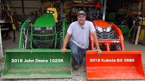

Kubota BX23S/ John Deere1025R
Width: 45.1"/ 47"
Length: 99.0"/ 134"
Weight: 1600 lbs/ 1556 lbs
Transmission: 2 spd/ 2 spd
3pt lift 24" behind:680 lbs/ 758 lbs
LA340S Loader/ 120R Loader
Lift bucket pins: 699lbs/803 lbs
Height: 71"/72"
The Kubota is shorter, and can lift less on both ends. 3pt capacity is 11% less, and loader is 13% less. So depending on your uses the JD could be worth 24% more. If space is a concern then the Kubota is better. Overall they are very similar. Tractor Time With Tim is bias towards green. He points out some good information, but through rose (or green) colored glasses.
Messicks did a video with a 1025R discussing axle weight ratings. He did it through orange colored glasses, but the somewhat scientific approach is colorblind.
I have not looked at this size of tractor so my buying insights are limited.
