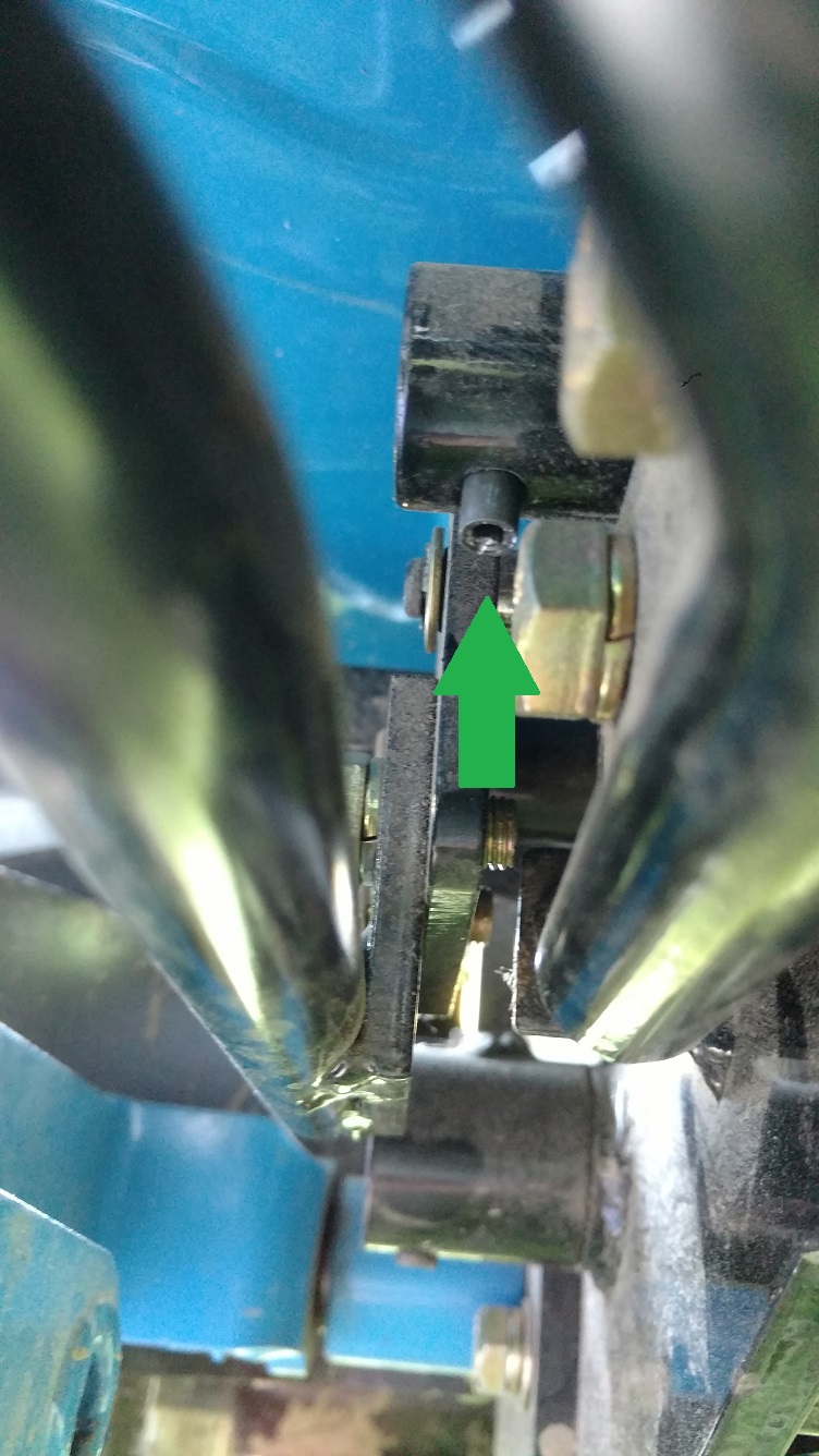

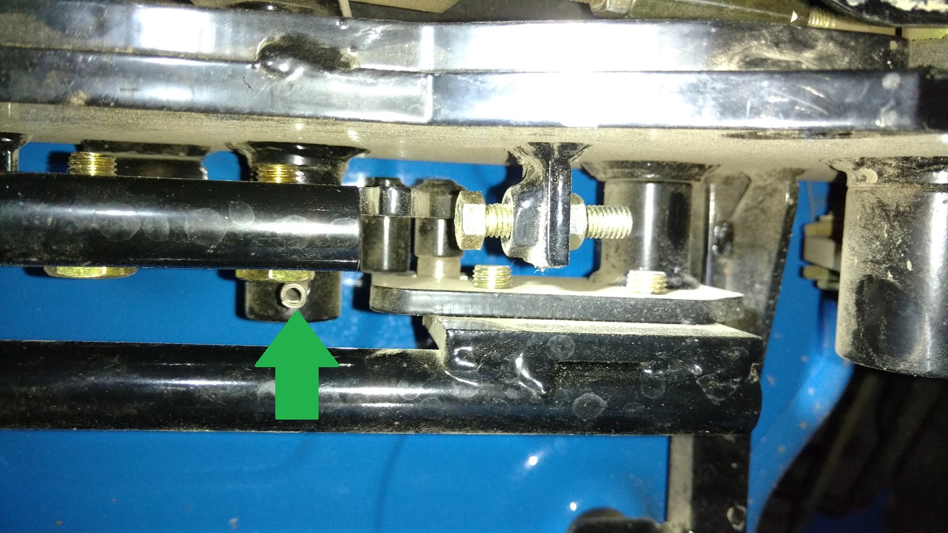

   / New MT 125h owner! #15
So my pedals actually went totally slack. They would not engage the drive at all. The mechanic came out and was not here for long.
It turns out that this pin in the linkage between the pedals and that connector rod had worked loose. I was not there to see the fix,
but I have before and after pictures. I think he just hammered it back in. Now the pedals actually engage the drive again and the tractor is back to normal and working hard again!

Glad it was an easy fix.
If that pin goes all the way through that shaft, you can run a piece of wire through it and twist the two ends together on the side of the shaft to prevent the pin from coming out again.

Glad to hear it was a simple fix. I'll check mine out tomorrow to see if that pin is loose. Gonna do the wire trick previously posted to make sure it does not work out.
