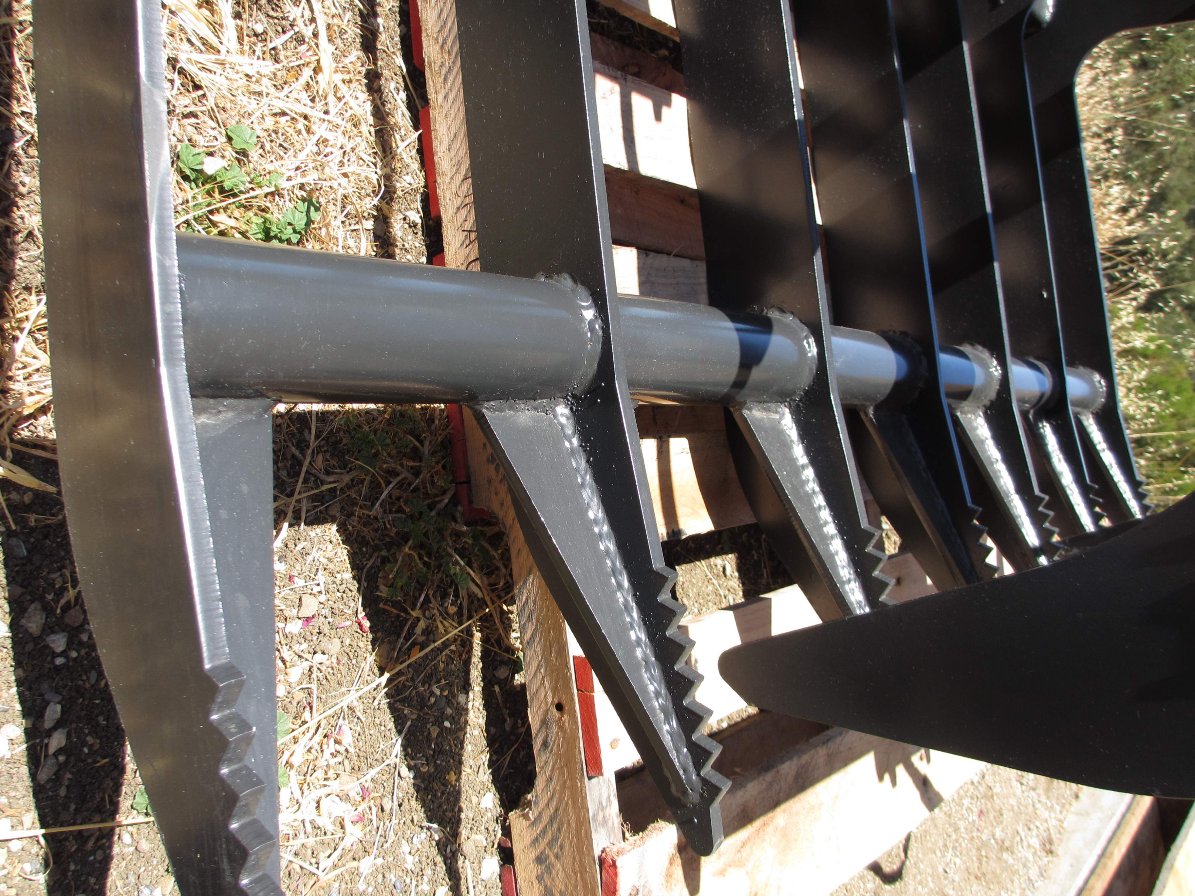

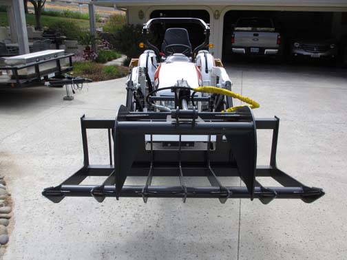

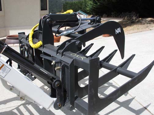

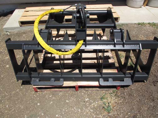

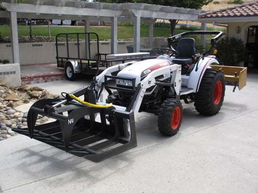

NAI 60"... Right off the truck... delivered today. The truck dropped it off at the driveway and I took it from there. Now to work on the 3rd function valve. Anxious to put this thing to work.

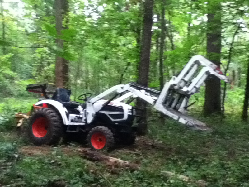

Congrats! Better hurry up and get that thing in action! Here's a picture of my grapple, i love it for cleaning snowmobile trails
That's nice. Looks like a two cylinder model... and it even matches the tractor. :thumbsup: It may take me a month to finish up the hydraulics. Too many other things to do.

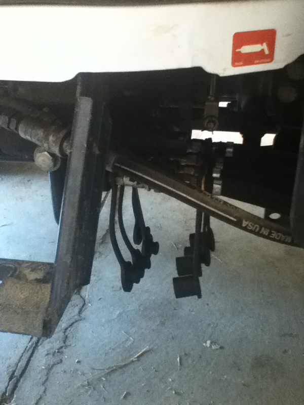

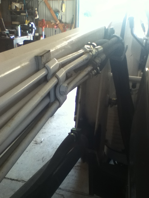

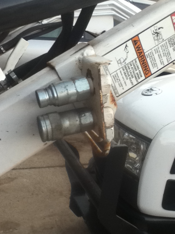

thank you! yes its a 68in two cylinder. i also use it on my T190.
I have a T off my rear remote valve that goes to the quick connects. its then all factory look with metal hard lines to the flat face couplers. I'm still need to take the lines off, sandblast, prime and paint. I just threw a quick coat of white on as i used it right away.
i can grab better detailed pictures tomorrow. this was my best route as i had the most of the stuff. image-1359083445.pngimage-1647005902.pngimage-3096150744.pngimage-3722421735.png

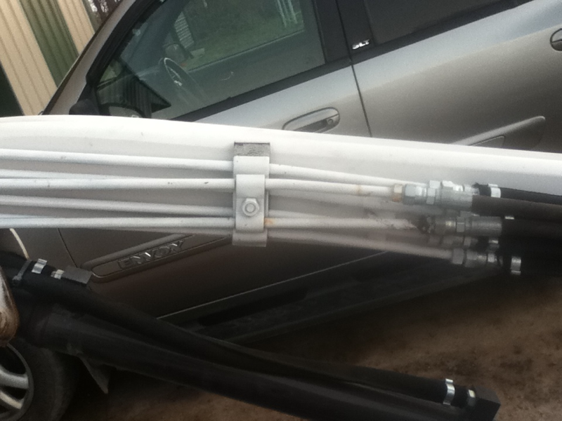

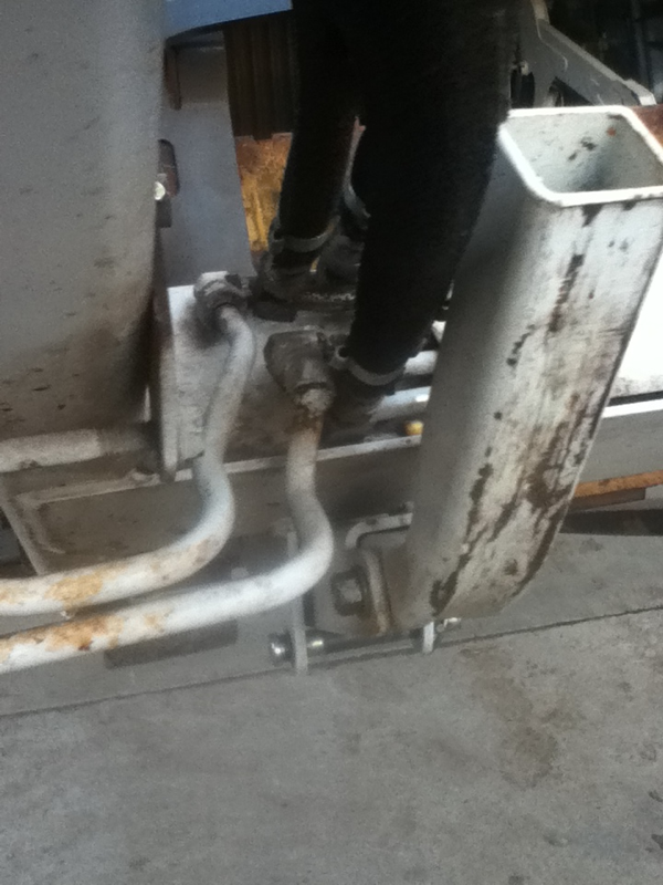

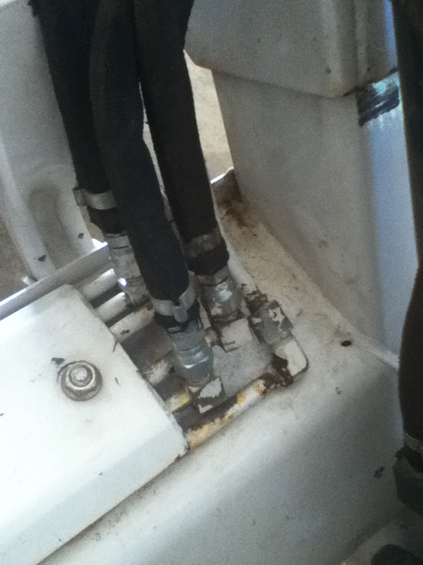

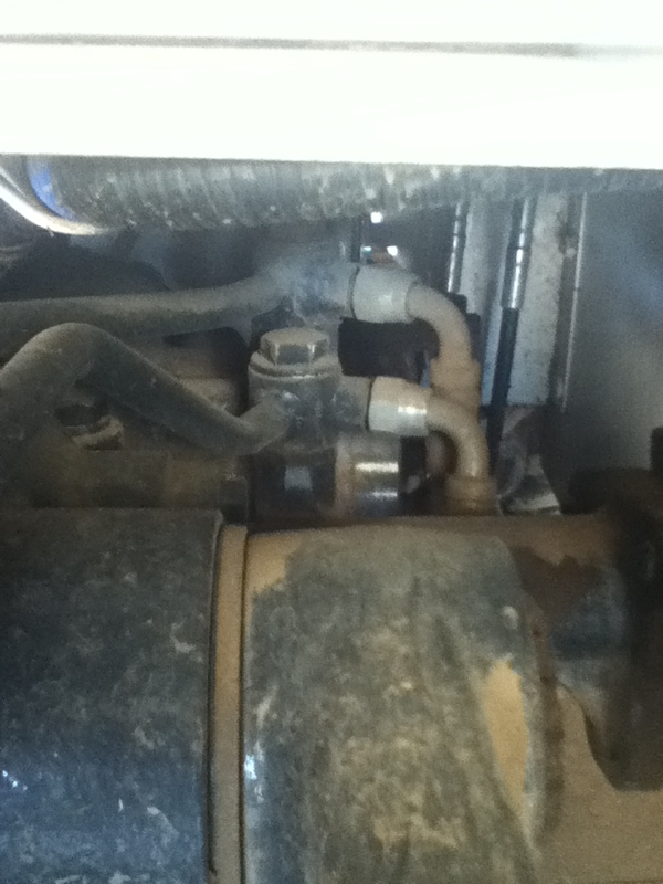

Thanks for the info and photos catdozer. It looks like you're using the larger skid steer quick connects at the bulkhead?
/ NEW NAI GRAPPLE #9
No problem, yes I used the flat face couplers, so the. I can run it also on the skid steer. I also have a plow for it so flat face was my best route!
/ NEW NAI GRAPPLE #10

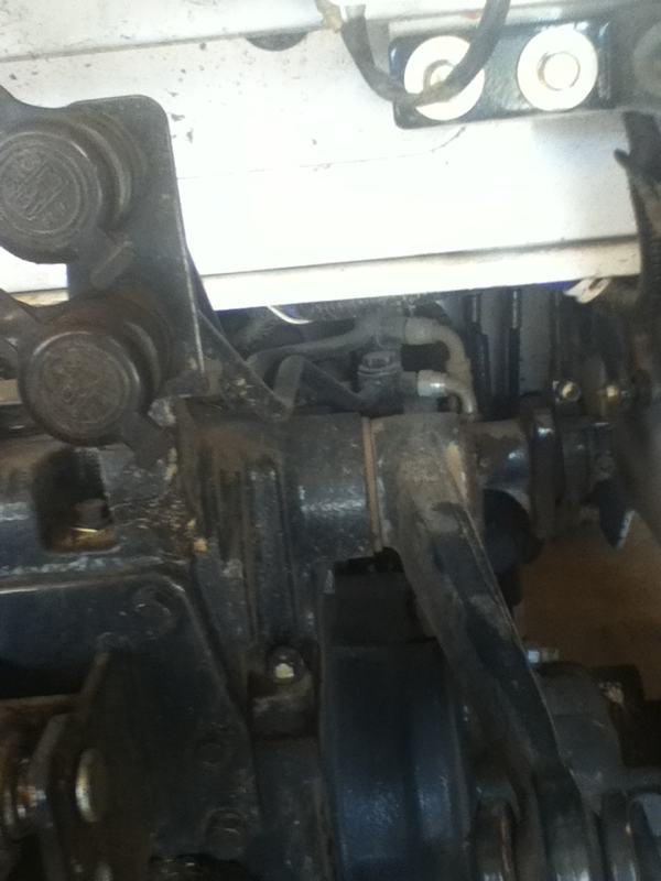

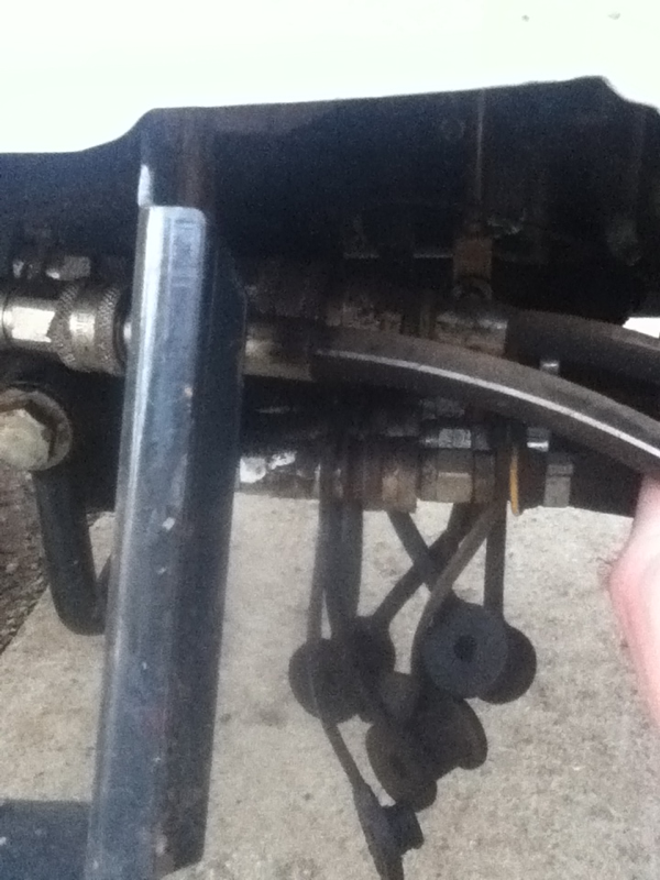

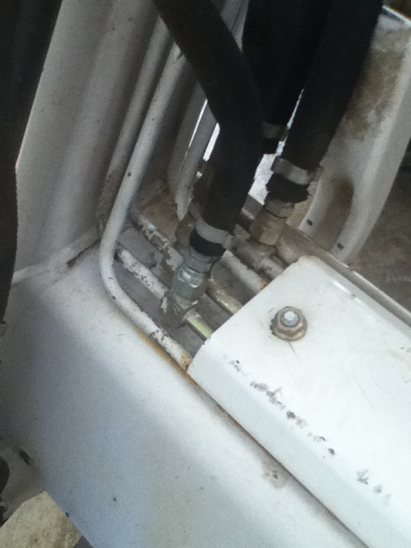

Heres some better pictures of my setup. My 235 already had the T but was capped. So if you don't have that I would get some hoses and plug into rear remotes

Informative pictures! I'll have to check if I have a T on my unit. I have the flat face couplers on the grapple.
/ NEW NAI GRAPPLE
#12
catdozer, I don't have those T's on mine. :confused:
