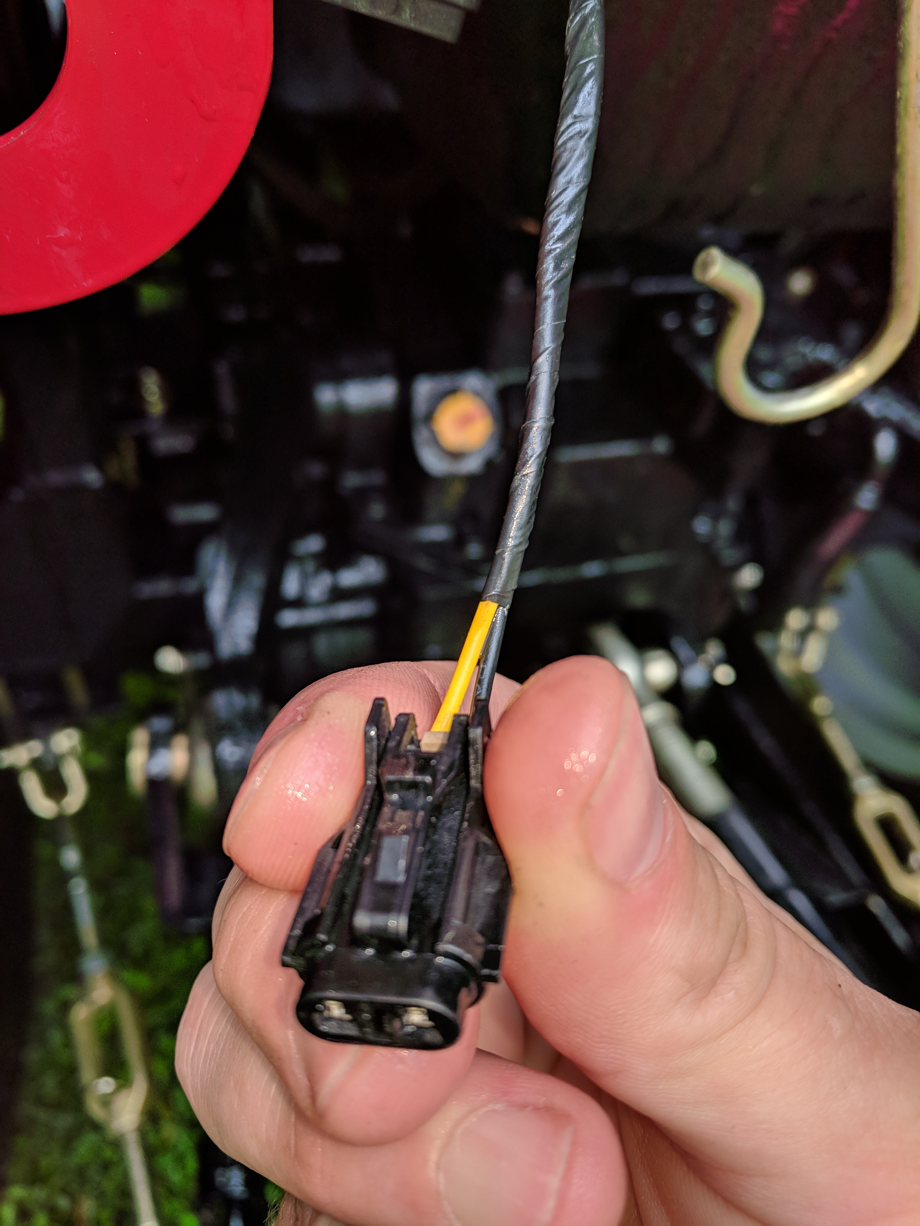

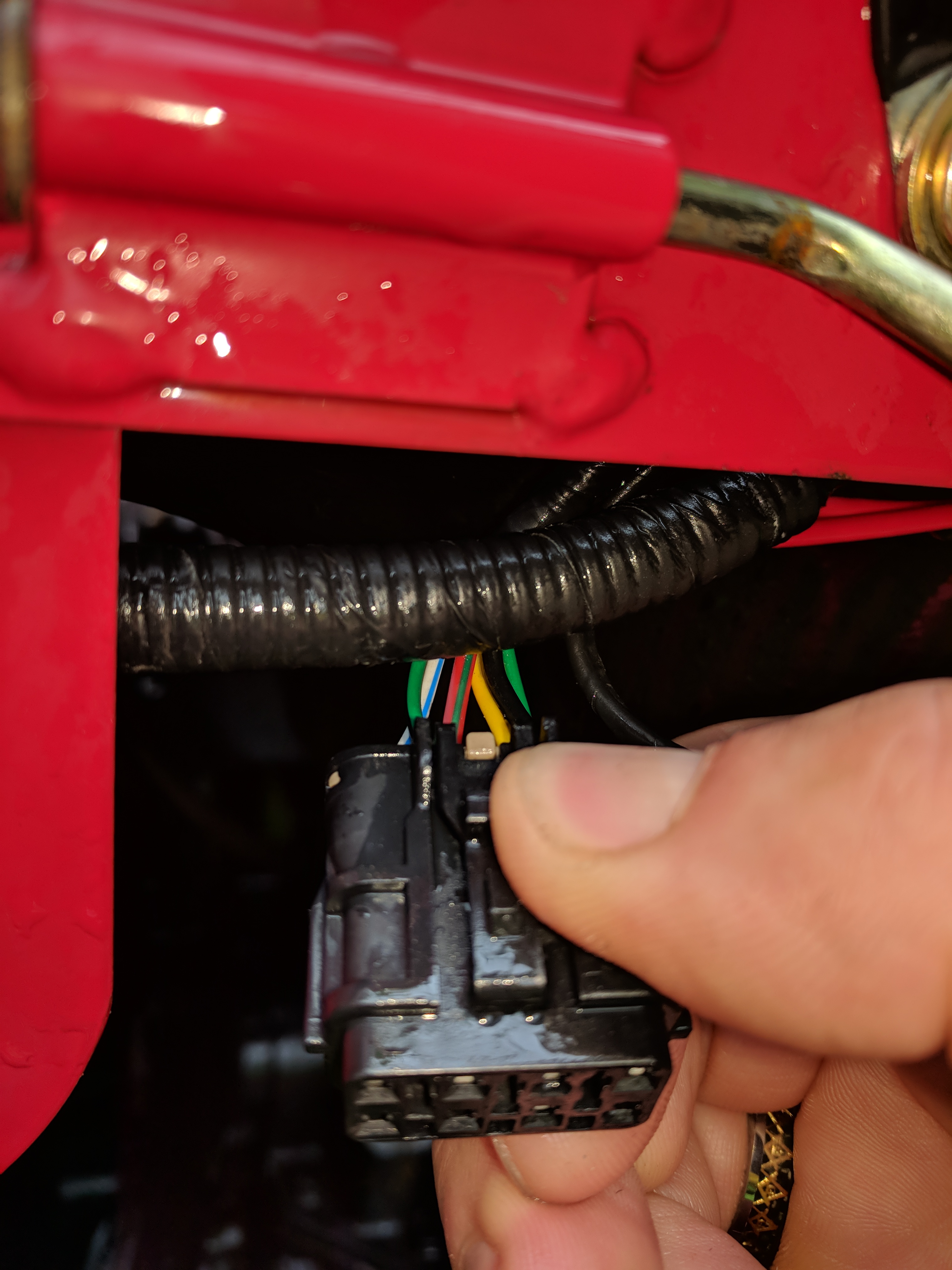

In reading the manual (I'm an engineer by day, yes, I RTFM), I noticed that there is an accessory wiring harness option, in my research here it is a European 7 pin trailer hook up. I've searched all over to find that part, as I would like to, on occasion, pull a sled trailer (Halloween Hay Ride - used to use my ATV, but negative tongue weight is a problem!)
I found several connectors just dangling freely without caps or covers at the back end. I'd love to be able to source the mate for the trailer wiring and just hook up a flat 4 or flat pin 7 (same as my pickup). Or if the mahindra part is cheap enough, just get that and an adapter (cheap. See 'engineer' above). I ASSume that the rectangular plug on the left side near the mounting plate is for the trailer.

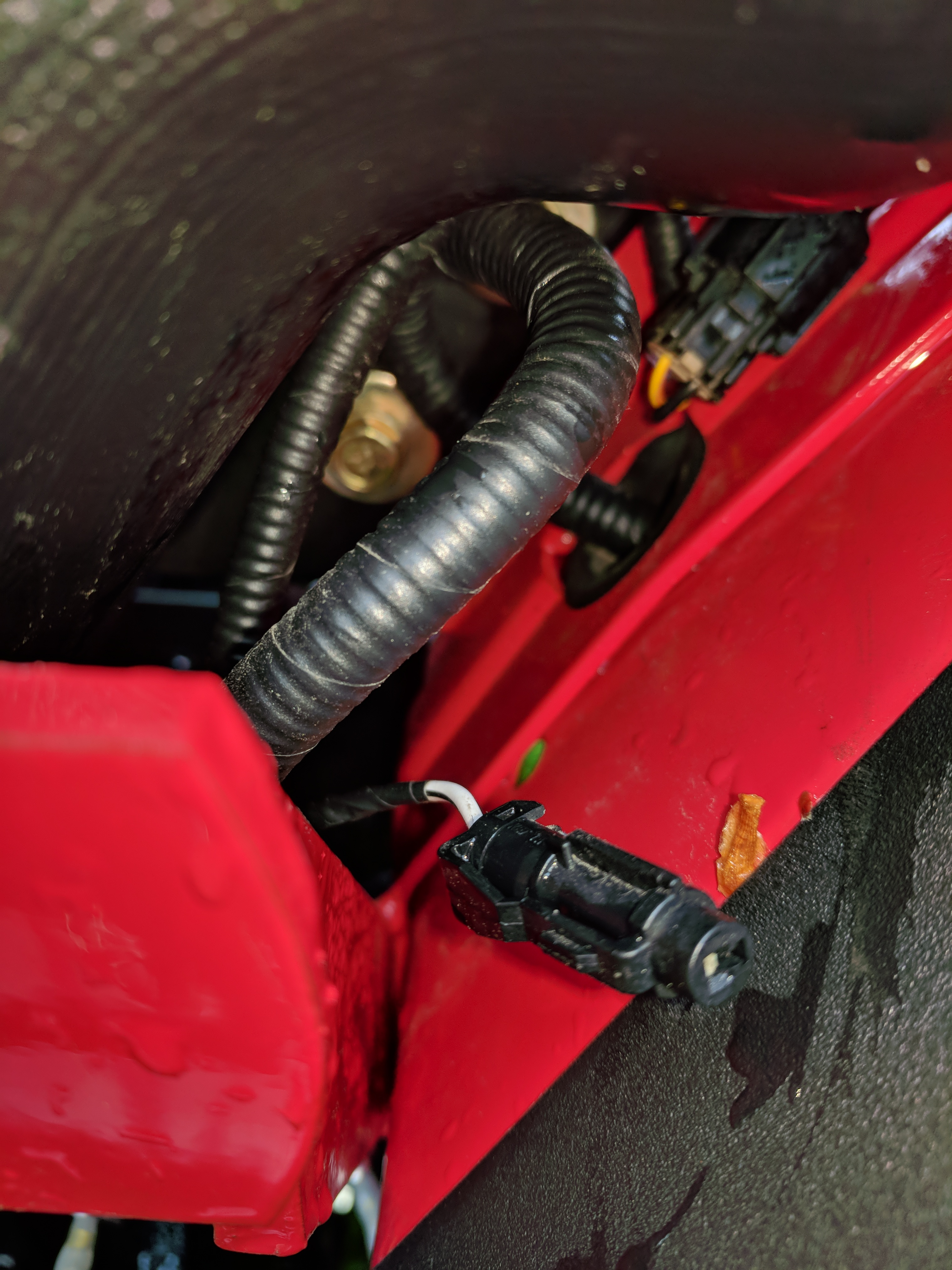

Near that connector is also a 2 pin connector. Any ideas what that is for?

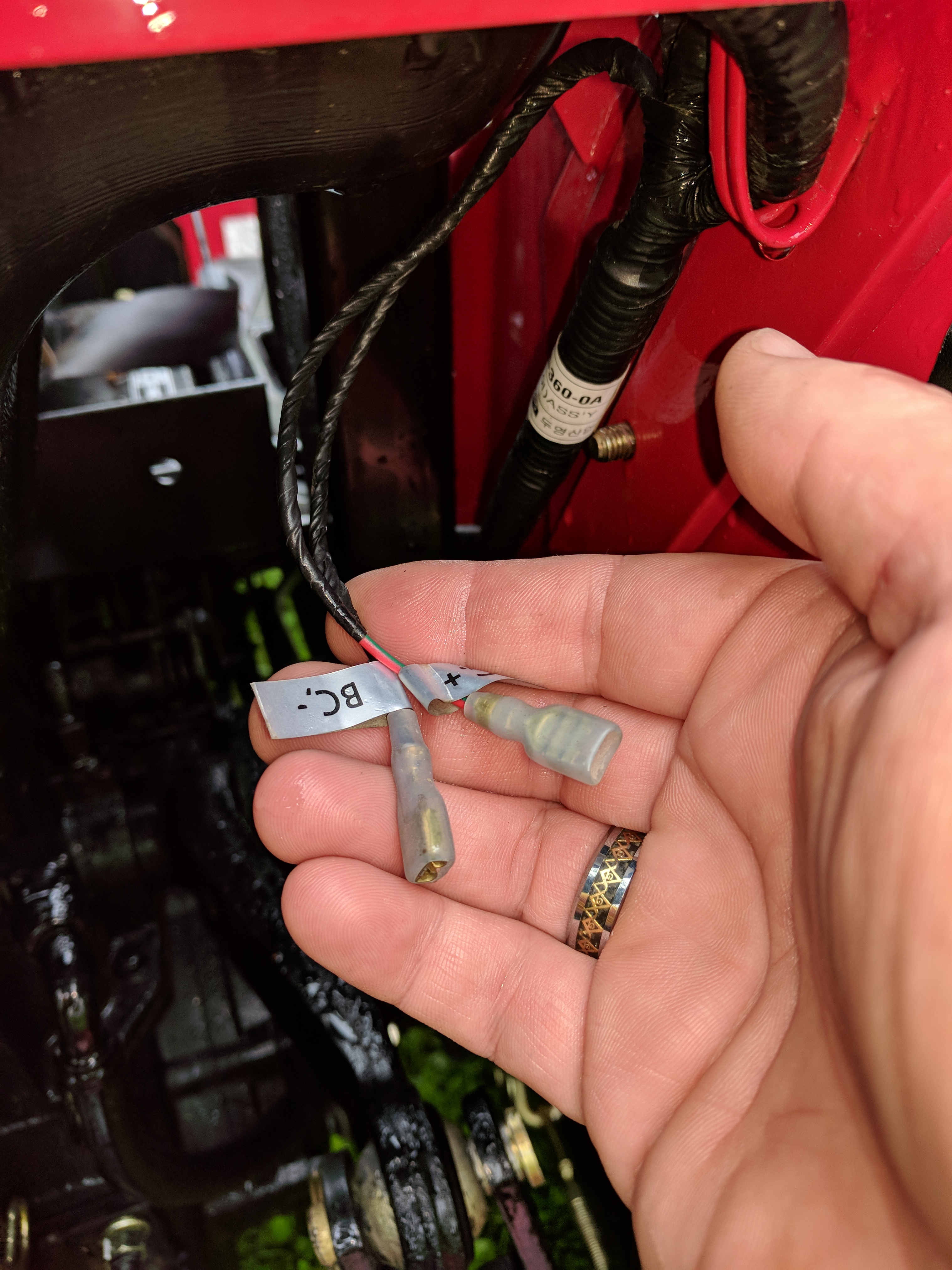

On the right side I found 2 spade connectors with silicone covers labelled B+ and B-. I haven't "fluked" them yet, but what I've read on this site is that they are always on 12V and ground pair. If that is the case, I'd love to add an LED accessory light, but will need to add a switch. In the same area is a single wire with connector (black and white). I haven't the foggiest what that is either.
As far as switching the acc. light - I noticed my dash doesn't have knockouts. But, pressing the mylar cover sticker there are 4 holes, like they just wanted to save the $0.04 in manufacturing and assembly by not providing blanks. Anyone know what size switch they accept? (Just trying to save time before I disassembly my brand new dash!)

I too have OCD and understand the desire to “find” the exact wiring harness.....basically out of principle at this point. My fear is the harness you are after will be harder to find than hen’s teeth. Between to local dealer and Mahindra USA I doubt they will have any desire to search down a euro wire harness....just my gut.
Anyway- you sound knowledgeable with regards to the electrical so here we go- ring out those plugs to see which one is the trailer lighting (turn, hazards, running etc). If you are bent on using the existing plug check out www.delcity.com and look up the waterproof connectors. The ones in your pictures are generic. The other option (to heck with OCD) would be to lop the existing connector off and install the one you want.

My Branson 8050 has the Euro style 7 pin connector mounted on the tractor, I picked up a male connector to fit it and a standard 7 flat blade US RV and wired them together, some of our implements use a 7 pin and some have a flat bladed 7 connector it's a pain

At least one of the pigtails near the rear end is an accessory lead, not keyed. I used mine to mount a 12v power port on the rear, so I can plug in a fuel pump, accessory light, heater, fan, whatever. I suspect that there may be 2 accessory pigtail leads back there. I'm doubtful you can "re-wire" those to adapt a 4 prong tail light assembly.
The pigtails for the tail lights, flashers, and turn signals may need to be "tapped" to get your harness leads.

I have the mating connector for the directionals, brakes and hazards on order from AliExpress. I will take pictures and what-not when it arrives.
I didn't find an exact switch to fit the knock out behind the mylar (I did end up taking apart the dash. There are 3 knockouts covered by the mylar - 1 for cruise and 2 smaller square holes just south of where the cruise button is).
I have a 7 pin flat trailer wiring receptical that I will mate to the KET connector when it comes in. I will have to fabricate a mount for it as it won't fit where the euro connector installs.
Here's a link for the KET connector (fitment not physically confirmed yet):
8 Pin Female Male Waterproof Electrical Wire Connector Plug Auto Connectors MG640341 MG610339
8 Pin Female Male Waterproof Electrical Wire Connector Plug Auto Connectors MG64341 MG61339-in Connectors from Lights & Lighting on Aliexpress.com | Alibaba Group

Yup. Verified the connector wiring with the service manual. Brakes, directionals, and parking lights are there with my fluke.
Connectors have arrived from AliExpress and it fits!
