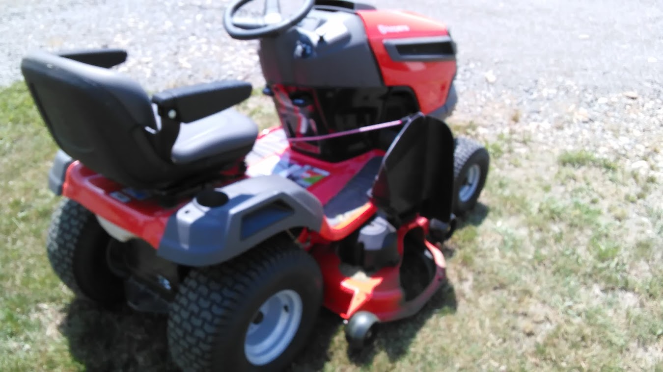

Husqvarna YTH24v48
I purchased this model from a local dealer for $1995 plus tax. Delivery was free. It came delivered setup and ready to go, even with a full tank of gas. I have used it twice and the following review is based on relatively new experience with Husqvarna products.

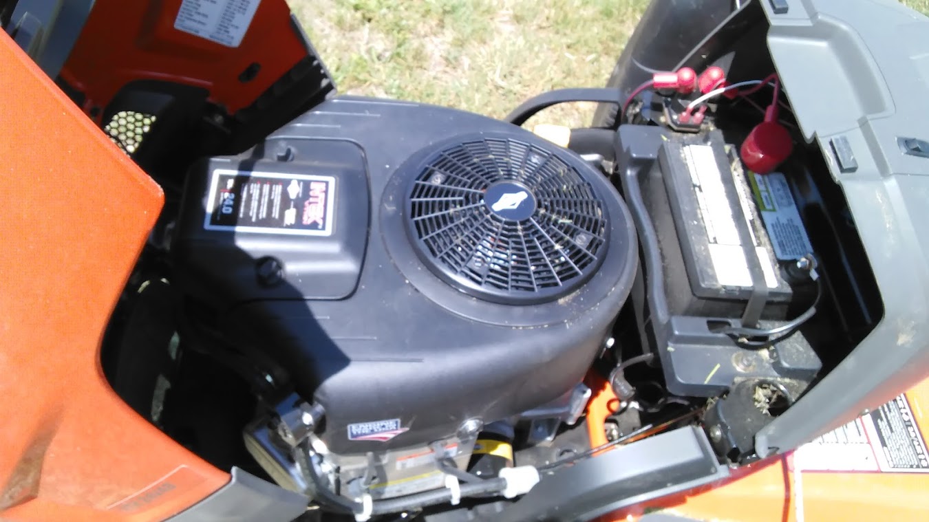

*B&S USA assembled engine

My primary goal is as follows. All I need is a mower to cut grass. Not to mulch. Not to bag. Just cut. Thus far, this unit does fairly well but still falls short of the 1990's era Ariens YT1340 unit my dad had back in Indiana.
Nevertheless, after a lot of research I decided on this unit. It is the last of the units that Husky will offer with a K57 transaxle. Going forward, all the units, yes even the ones sold at Lowes, will have a plastic, yes you read that right, plastic CVT made by General Transmission.
The mower starts and runs well. The B&S engine has an automatic choke that makes starting a breeze. Once you get in position, you lower the deck to desired height, rev up to full throttle, engage the electric PTO and off you go. The mower handles my grass with ease; I cannot comment on high thick stuff as I live in a residential area and keep my grass cut so it looks neat. I would assume with 24 ponies under the hood, it should handle the task.
The deck appears to be robust and with the 10 year warranty on the shell, I think it should last a while. The only drawback I see is it does not pivot with the front axle so evenness of cut is lacking compared to others that offer this design feature. The reverse speed is sufficient so as not to slow things down, it can really get up and go when you mash the pedal but I don't consider that a priority when mowing.
The B&S engine is OHV with full pressure lubrication, cast iron sleeves, and oil filter. Seems ok but at 24 HP I question, seriously, is all that HP necessary when I mowed for years with 12-15 HP machines as a kid. Still it runs well and has not used any oil during break in. Parts are easy to come by also.
The battery is a basic 240 CCA 12V affair that you can buy anywhere. Blades are available at Lowes. I plan on having the dealer perform all the service save for oil changes.
I cannot comment on removing the deck as I see no need to do so. LIke I said, this needs to cut grass. No more, no less. I cannot comment on pulling power as I have no cart or dethatcher but again, with 24 ponies under the hood, I cannot see it being underpowered. If anything, the K57 transaxle will give up the ghost long before the engine will under such usage.
Overall, it is a good unit. Time will tell how reliable it is. JD missed the mark by not having greaseable spindles and requires you to hold in a flimsy yellow plastic button to mow in reverse. Otherwise I would have purchased a JD. In the end, it came down to details.

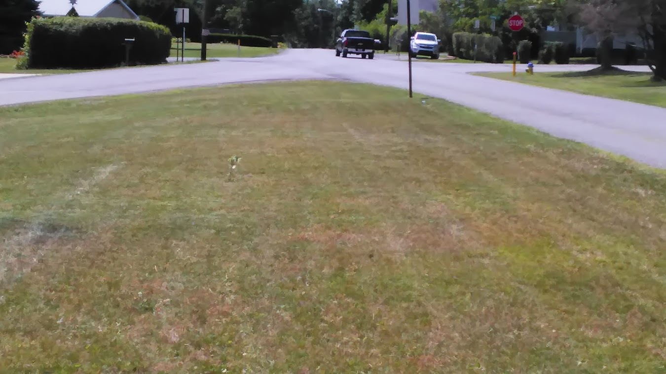

It did clog on me last week when I mowed slightly wet grass. I do mean slightly wet. Kinda disappointing with 24 horses under the bonnet and it still bogged like that. Blades are sharp so that was not the issue. I did cut off about 4 inches of the dumb deflector that really kills the dispersal of the cut grass.

Good news is once I cut back the darn plastic deflector, it throws grass much better now. Doesn't bog down as much.
