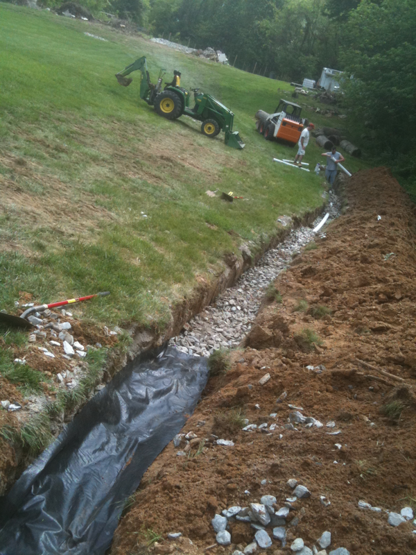

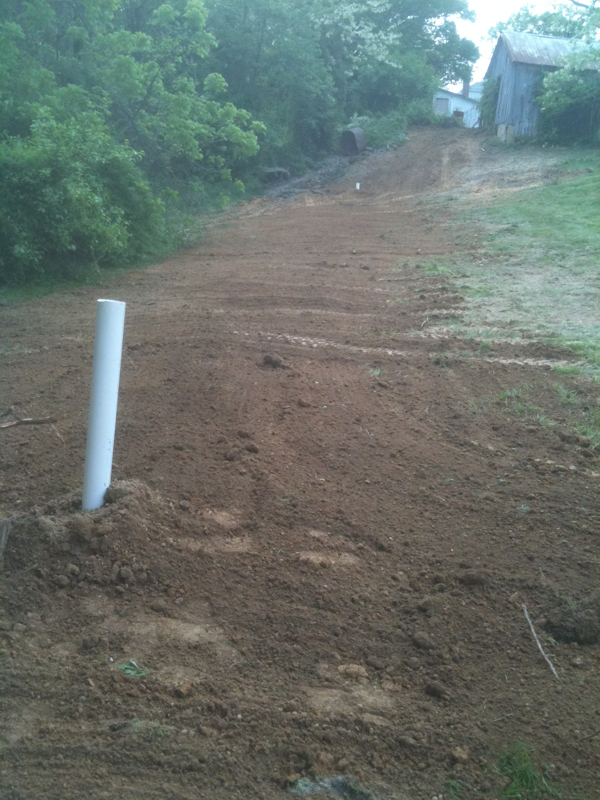

Forgot to put the proof pic in

About the leach field. My 790 had the #7 hoe as well. Very good for what it is. The new to me 4310 has the 47 hoe on it. Just a bit beefier. But still a kick in the a** to dig a field with it. I did about a 125' field with it and was on that thing the better part of a weekend. The guy I know who sucked my tank out before I started had a good laugh when I told him I was going to dig with the Deere. Said I'd be all weekend. I was. Oh well I told him that's all I have. Got it done but if I had to do it again there would be a mini ex rented.

Boy..that's a heck of a slope you're working on...with the ROPS down too!!
I mean..it's so steep, the houses are built on an angle!

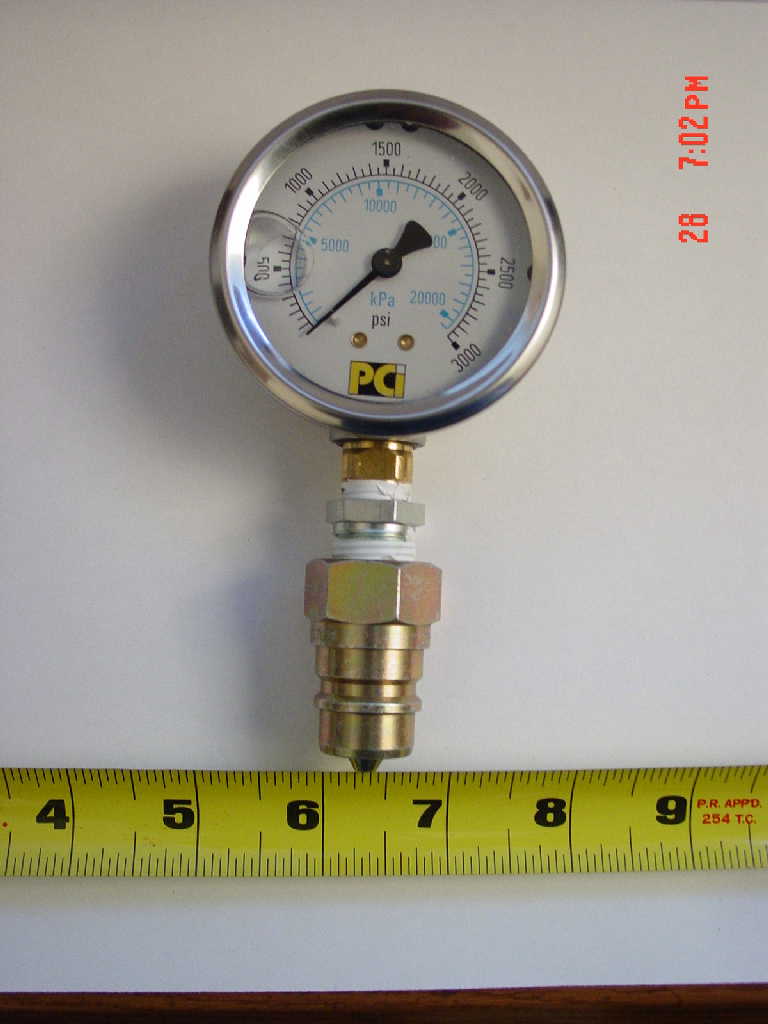

I will build a gauge to check that final pressure but it will be a few days out before I get to that.
Here's a pic of the one I fixed up. The gauge was like $19, and the quick disconnect fitting and the adapter for it were about another $8 I think. Just remember when you check your pressures, you will want the engine rpm's to be pretty much maximum so you are seeing the most PSI the pump will deliver.

I am assuming the fitting is not a hardware item, so where can I obtain one? And good point about the RPM. Which reminds me that the tension nuts on the manual throttle arm needs tightening as the rpm drops off on its own. Its been raining almost every time I get a chance to go out and tinker. June and its still winter here in the Santa Cruz Mountains of California. Supposed to get even more rain over the weekend.

I think that a JD dealer can provide all the parts needed to build your gauge, but I bought my stuff from a local hydraulic repair shop. You may/may not have a hyd shop near you, but check around and see. If not, you can always order the parts online but you pretty much have to know exactly what to order then. I don't have the part number for the quick connect fitting I used, but maybe some else here can provide it?

Well Roy. You caught me. The first owner damaged the top bar for the rops. So I've never had it. I know I know. I'm being not only cheap but stupid. Let the safety police stoning begin:-(
