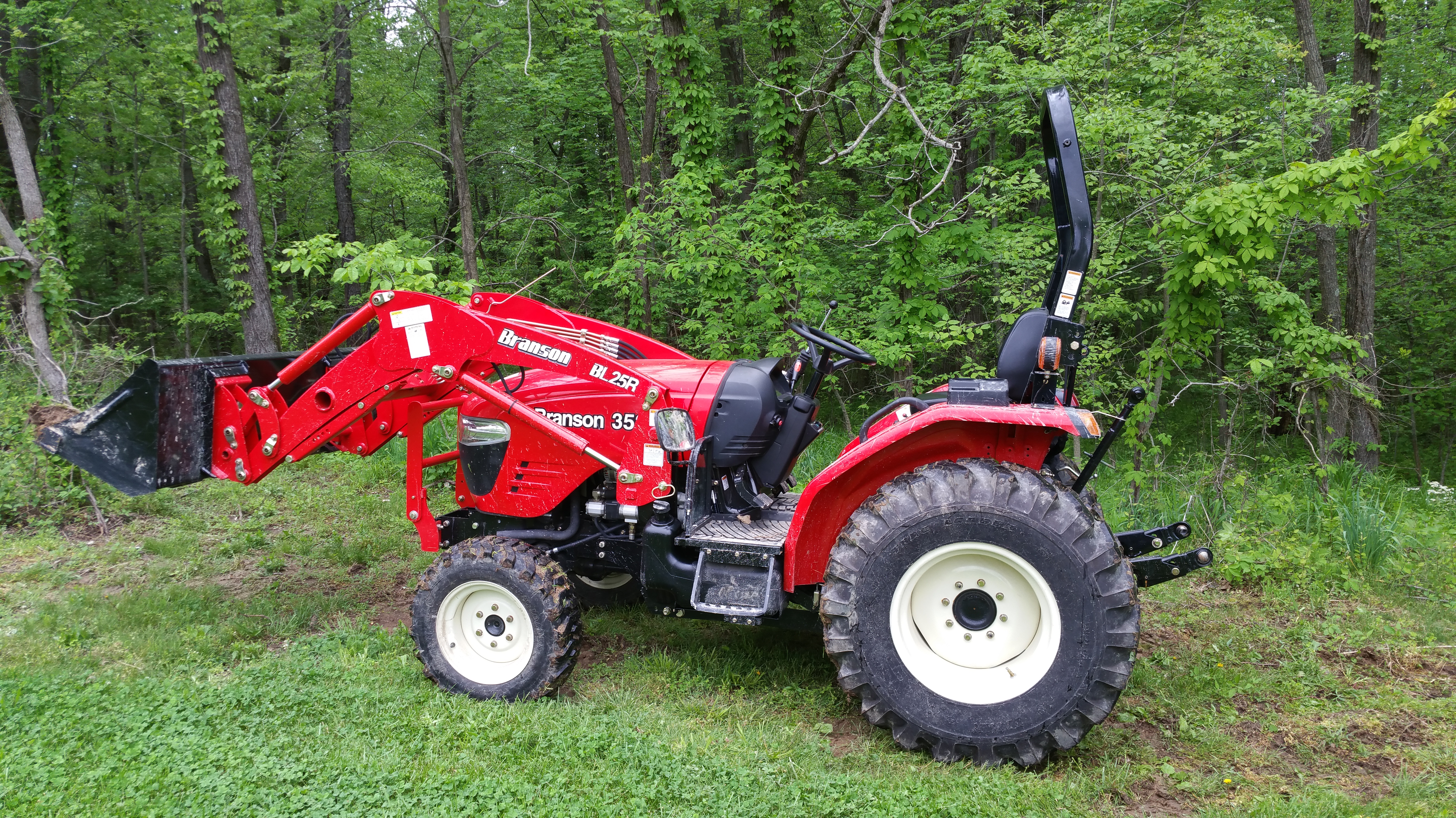

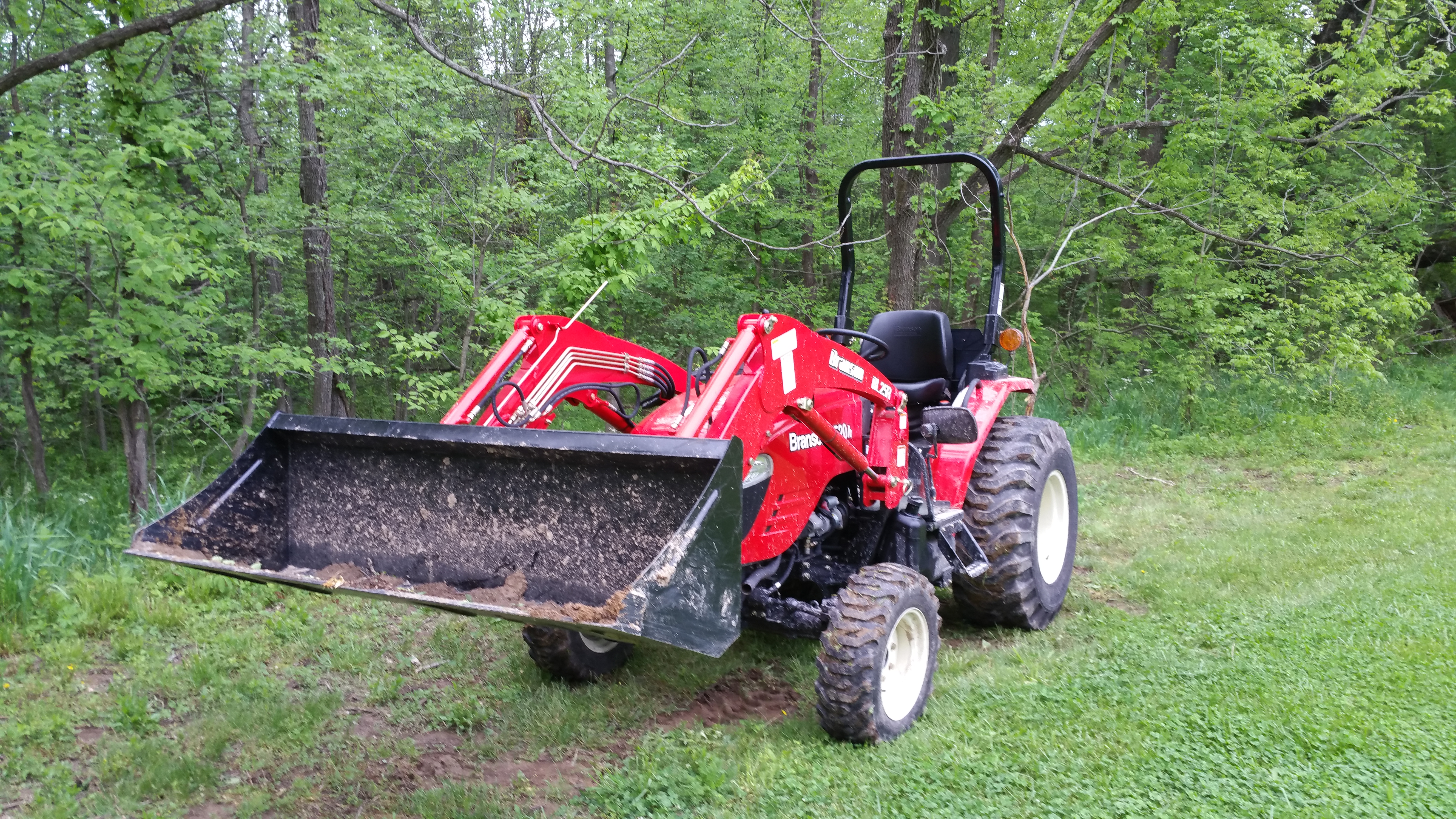

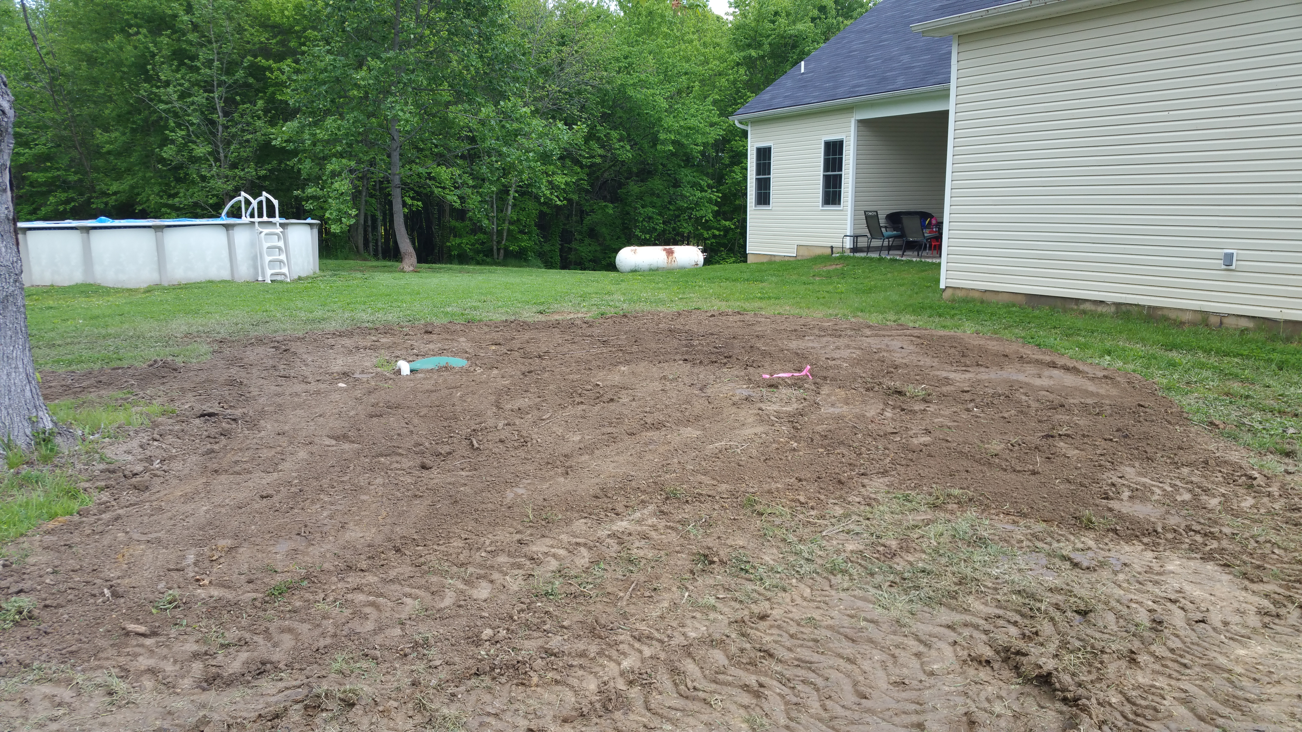

Finally pulled the trigger on a new (2015) 3520h last weekend. Looked at New Holland and Deere and just wasn't impressed. I think I got quite a bit of tractor for the money. Already used it to spread a load of top soil. This forum was invaluable when trying to decide what to get. Thanks to all who post their thoughts on here, good or bad.
