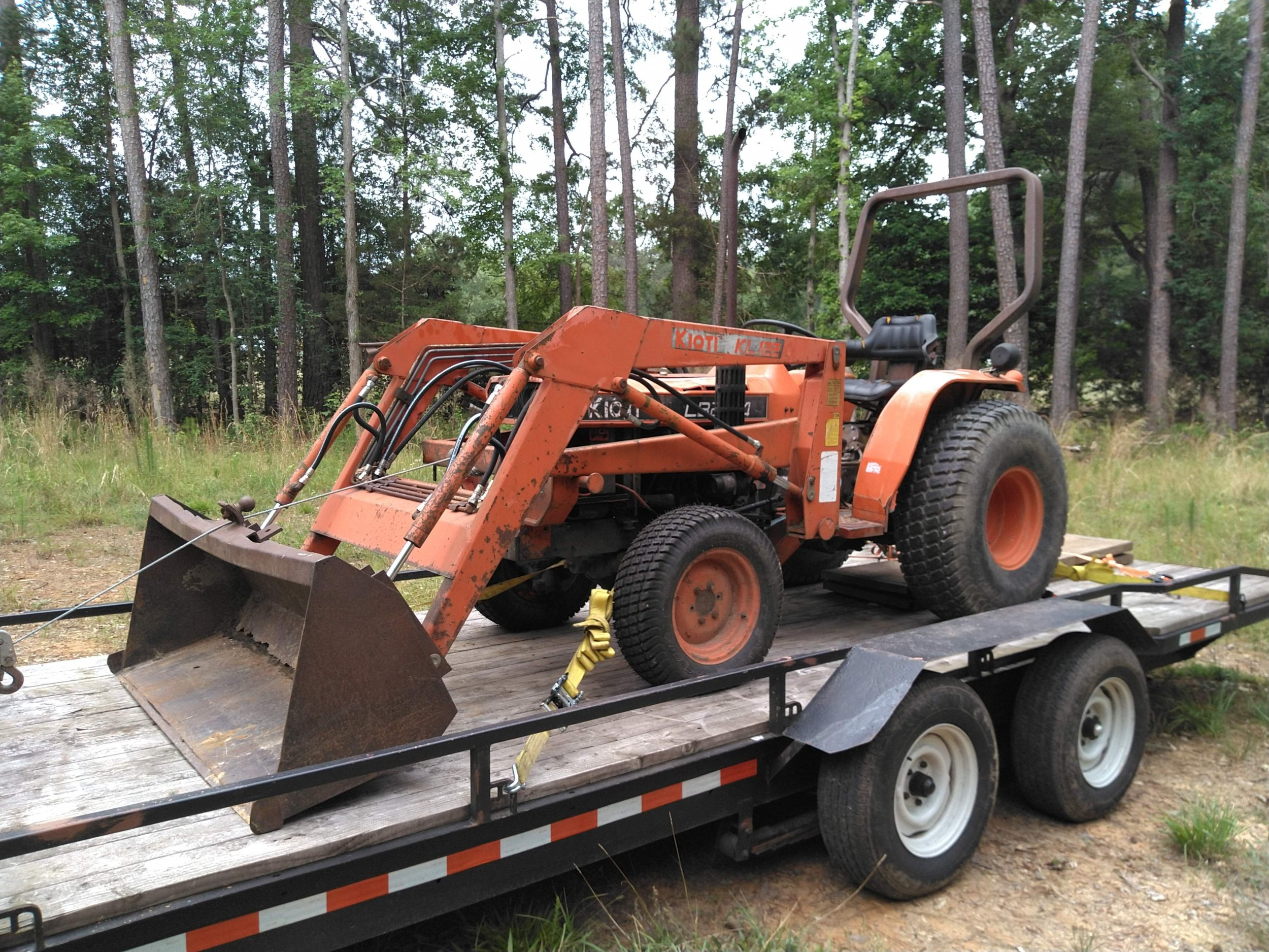

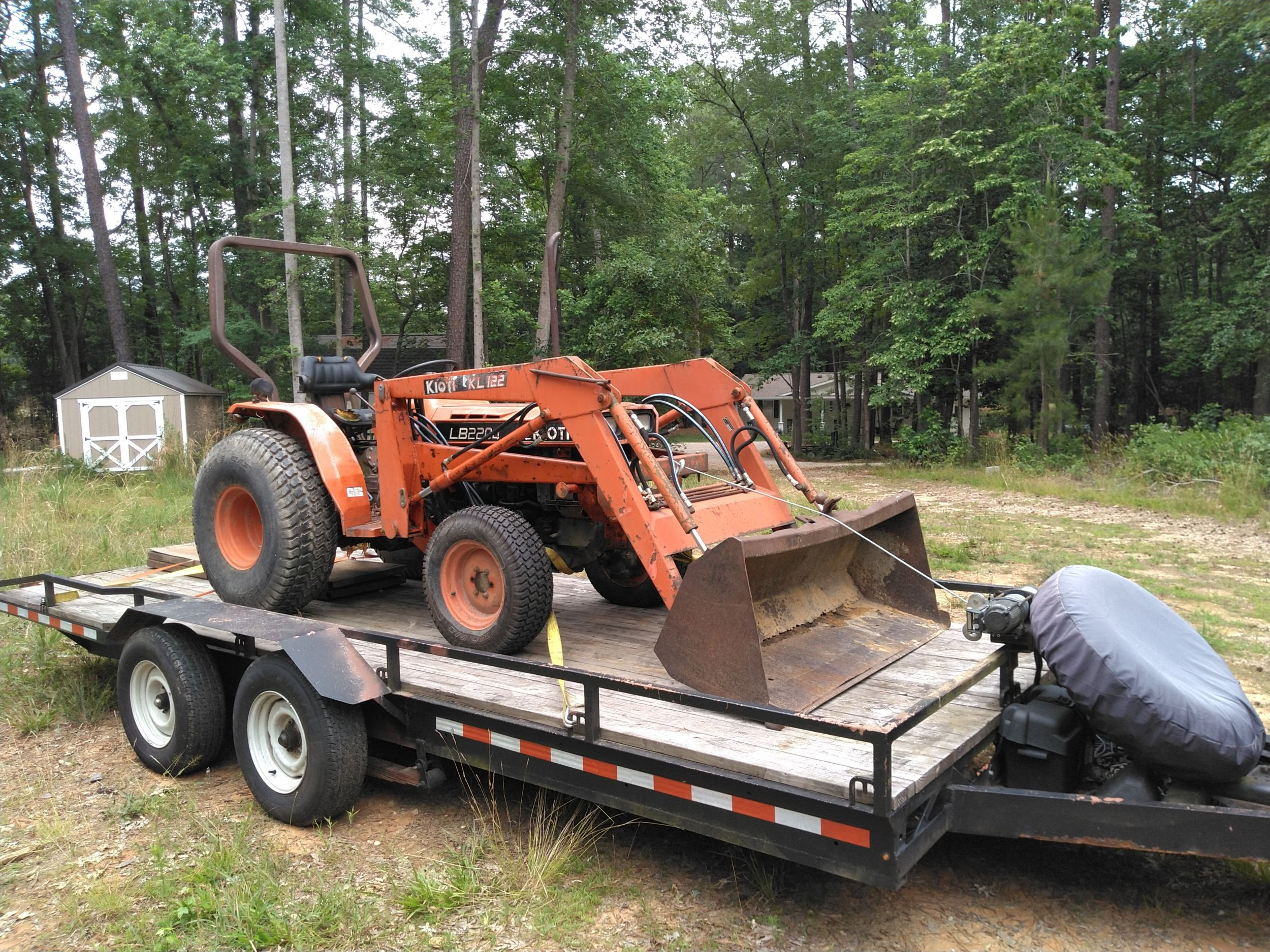

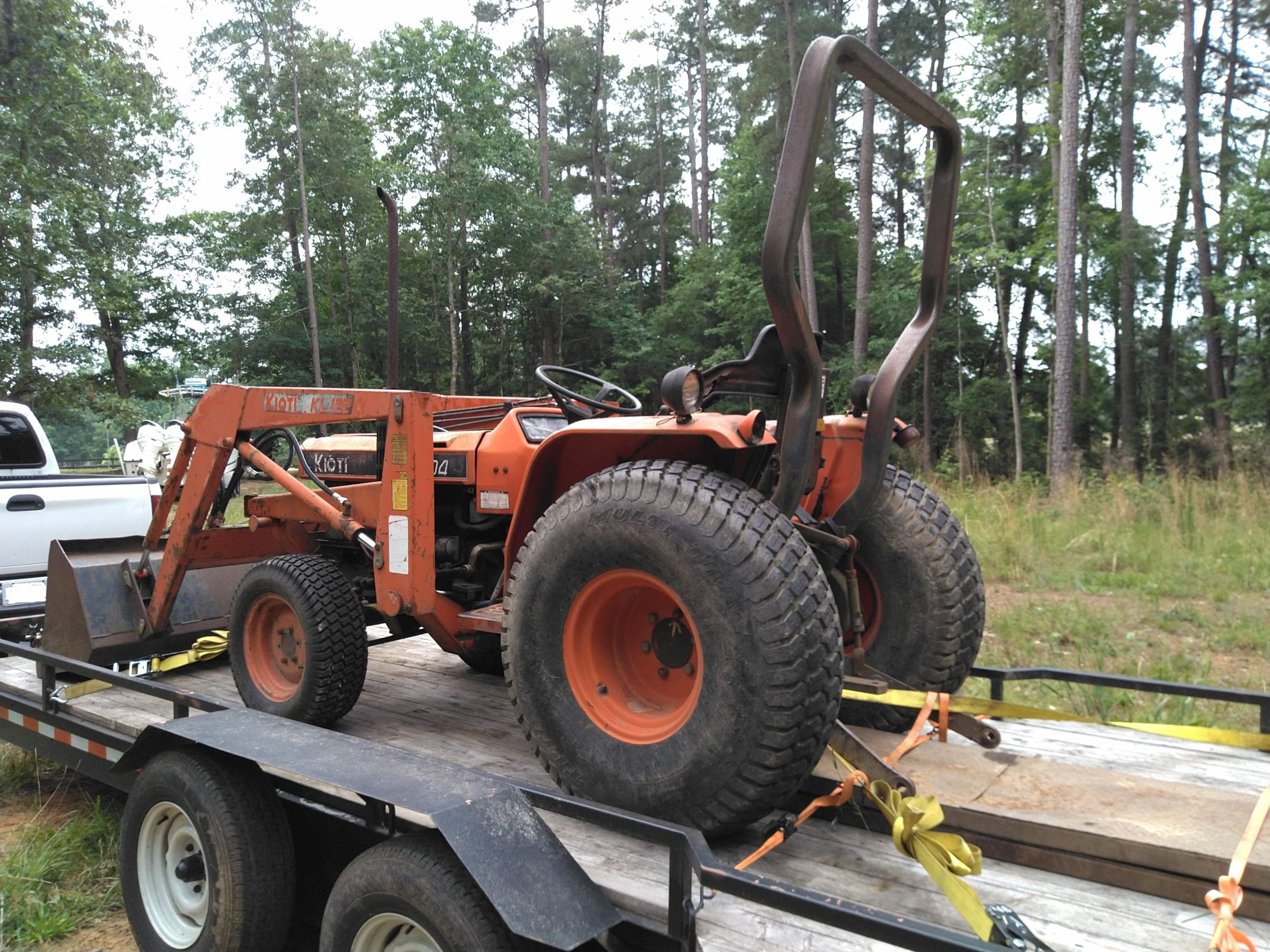

Just picked up this machine for a pretty killer deal. Needs some work, but even after I get done fixing it, I'll have less than half what it's worth into it. I was going to wait until later this year or early next but couldn't pass this one up. If anyone is interested or can offer some info, I've got a thread about the engine under Owning/Operating. Can't Wait to get this thing whipped into shape and start moving some dirt!

Thanks! Oh it's going to be either a complete rebuild or a repower type situation. Massive blowby and I think one cylinder is so down on compression it's not firing at all. I knew that going in, and I'm not afraid to do the work. I've done a few gas motors already. Finding info and support for the DH1101-B motor is proving quite difficult though. Can't find a kit to do a rebuild specific to the Dae Dong version of this engine. I'm suspicious that it's actually a rebranded Kubota engine or at least a Kubota design since the L245 tractors have the same part number, DH1101, for their engine, and it even has the same 1115cc cast on the side of the block as the Kubota, but I can't find anyone to confirm whether the internals will interchange. I'd hate to spend the money to repower when I could have essentially a brand new motor for $500 in parts off of eBay.
