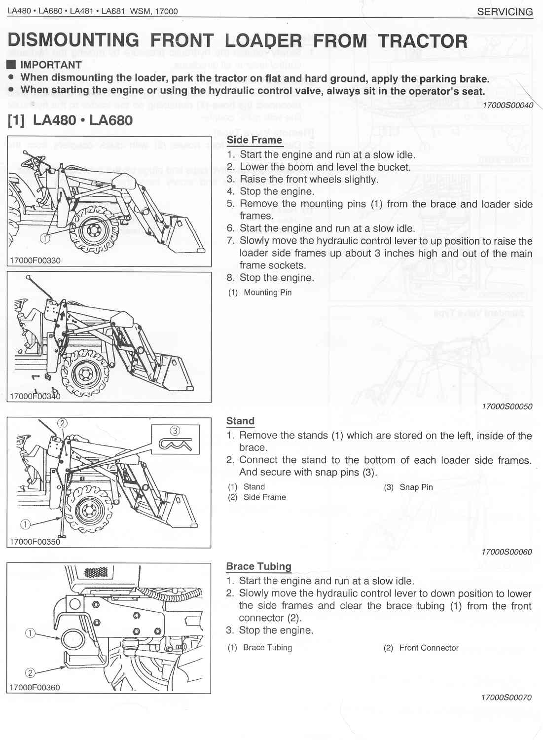

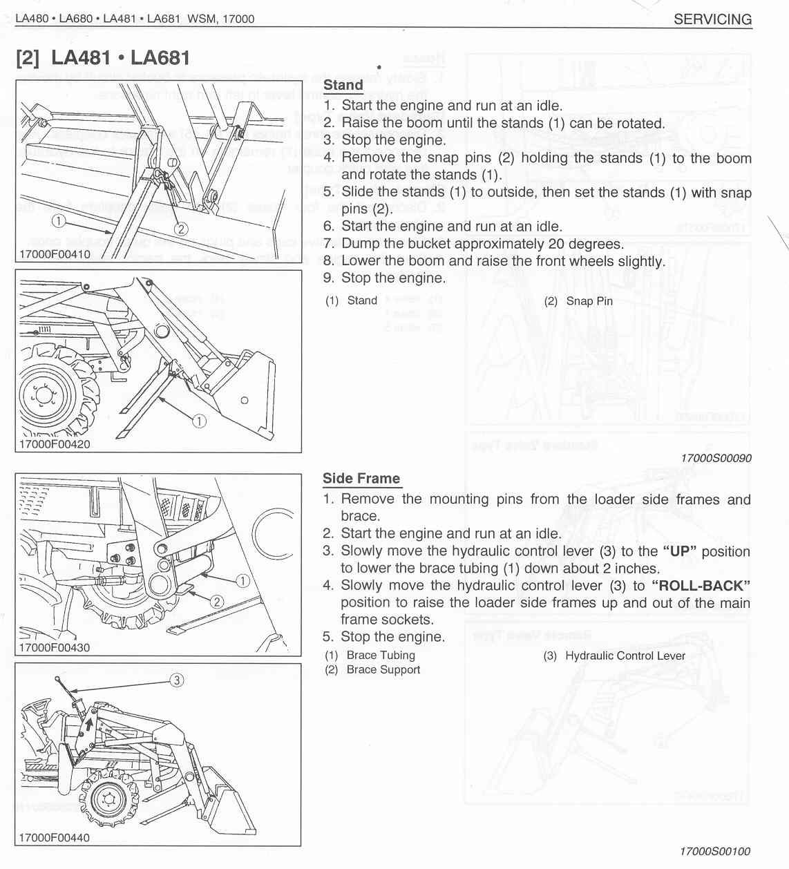

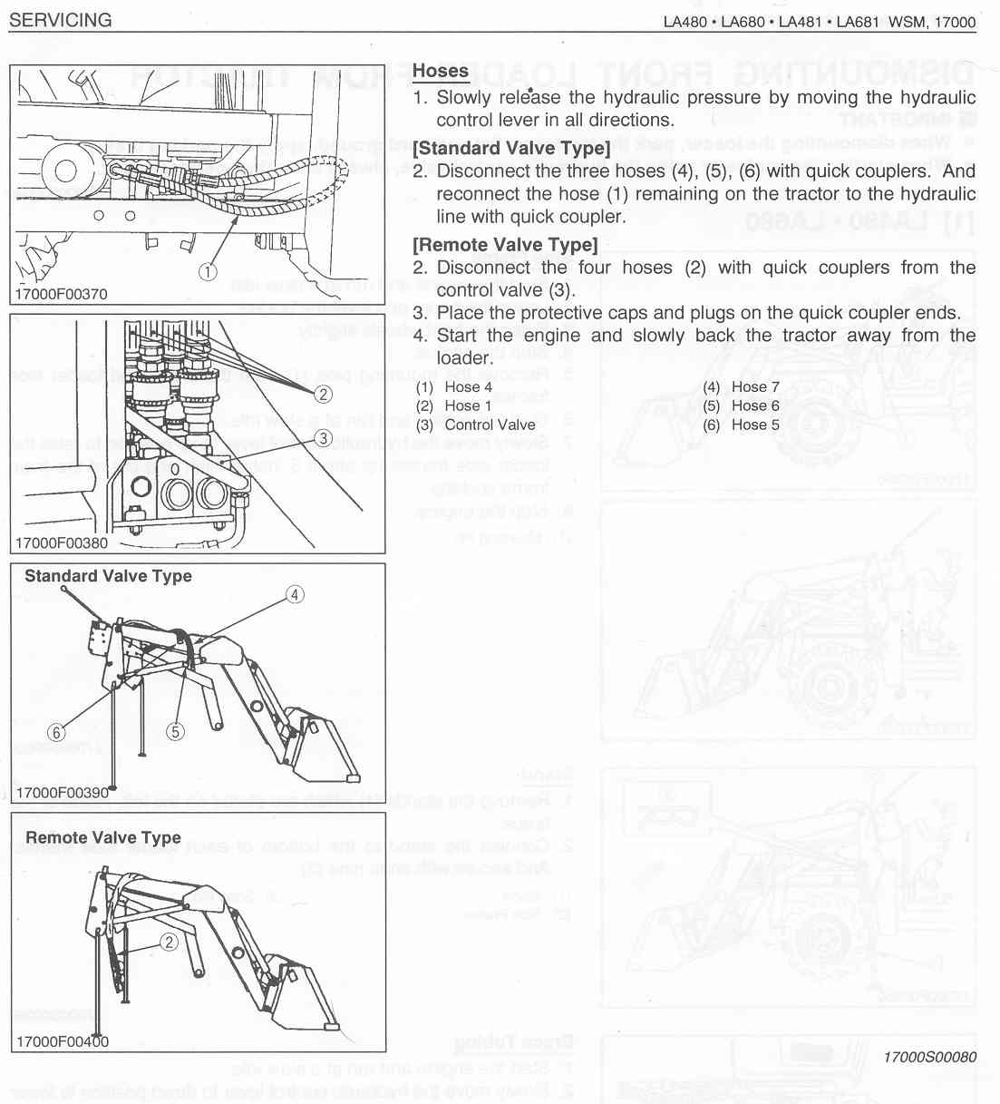

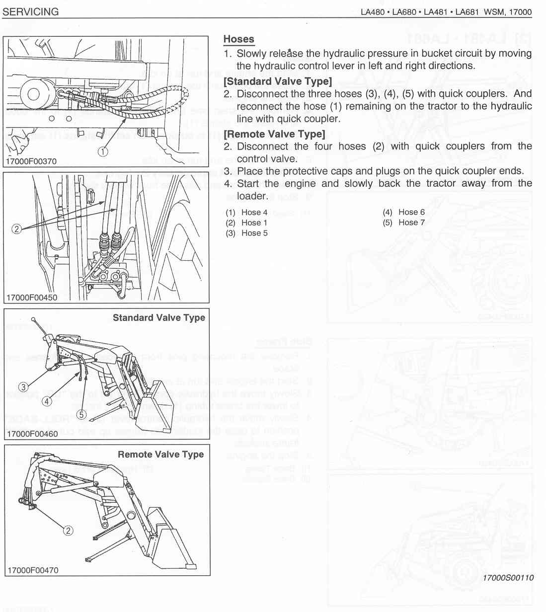

I'll get to my other computer and scan you the info from the loader manual...
Removing the loader is quick & easy... going back on is only a little more difficult, because the hydraulic Quick Disconnects can be troublesome to reset.. KennyV

Here are the steps...see attached...
