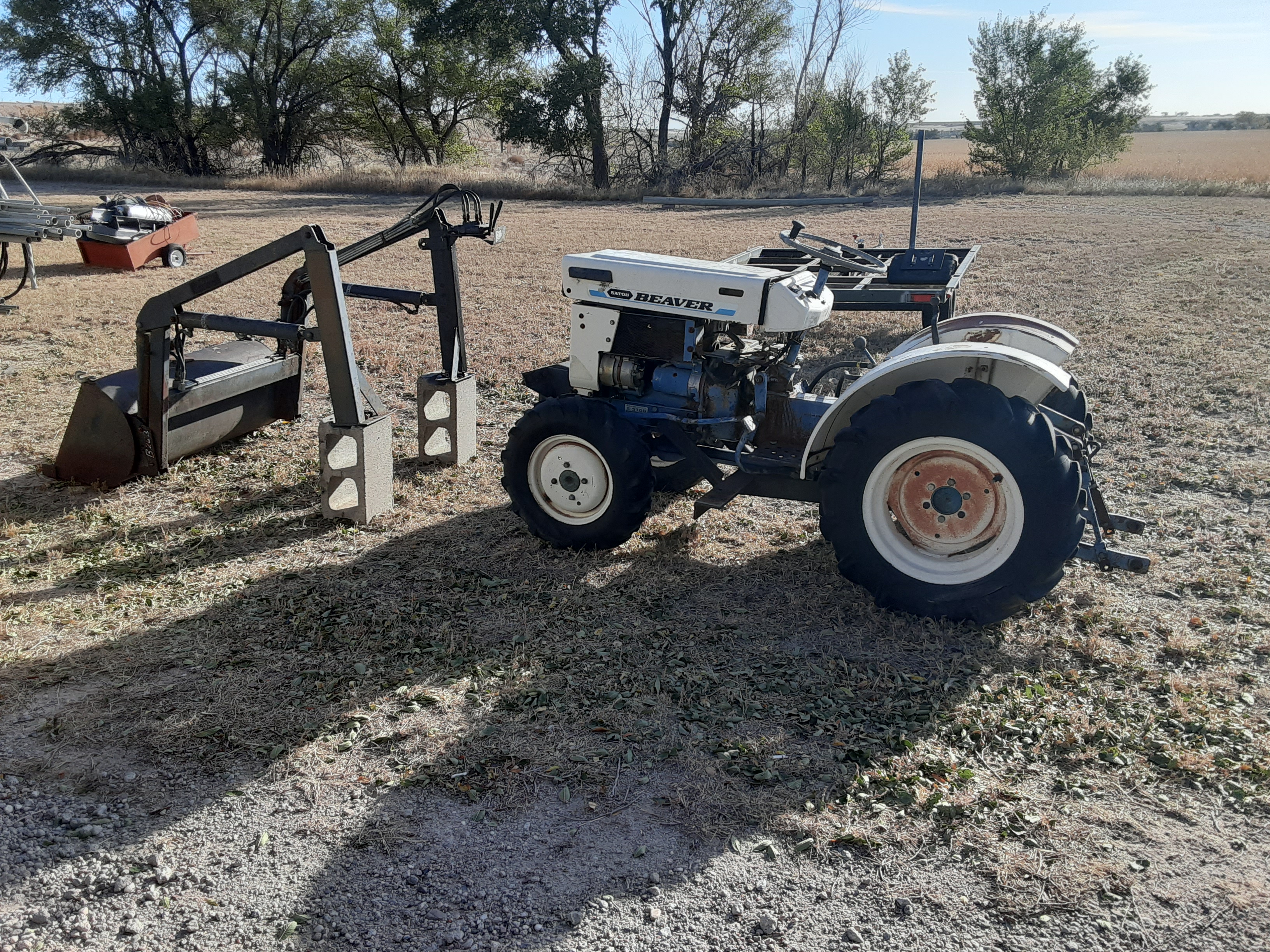

Picked this up from a neighbor that parked it outside in an open corn crib over 20 years ago , hasn't been run since.
Had good old red fuel in it and that was a plus. A little rust in the tank that cleaned up nice.
After replacing hoses , new starter , filters , pulled and cleaned injectors and turning it over by hand with some oil in the cylinders it was time for the magic moment .
Got it to start puffing black smoke but it just would not take off . Got the new starter pretty hot and said to myself ( their goes 150 dollars you dummy ) .
It's still working . Glow plugs working , heat gun blowing hot air directly into the intake pipe and it still would not light .
Ok time to check compression . Pulled glow plugs , filled cylinders with mystery oil and ran to Harbor Freight to get a compression tester .
1 1/2 hours later installed gage and guess what . You got it , gage defective . Back to Harbor Freight .
Forgot to mention yes i did blow the mystery oil out first. Ok an hour later and back with the new gage .
Front cylinder 340lbs , rear cylinder 280lbs . This baby should light .
Ok i know starting fluid is a no no , but i figured its either going to run or i may be parting it out.
Unhooked glow plugs , got her cranking puffing black smoke and hit her with a tiny shot and " IT'S ALIVE " .
Have had it running off and on for around 4 hours , changed oil and made sure everything else works .
Did put a fresh oil filter on it before i got it running .
Runs great , trany , 4x4 and pto all work . I am a happy camper .
Oh the clutch disc was stuck. Got it free'd up by hole sawing a hole in the side of the bellhousing so i could pop it loose .
Tried all of the other suggestions . No Go .
Anyway not a bad purchase for 400 dollars with a johnson loader and factory pto reverser to boot.
Revamping the hydraulic hookup to the loader and will post some pictures when i get done.
