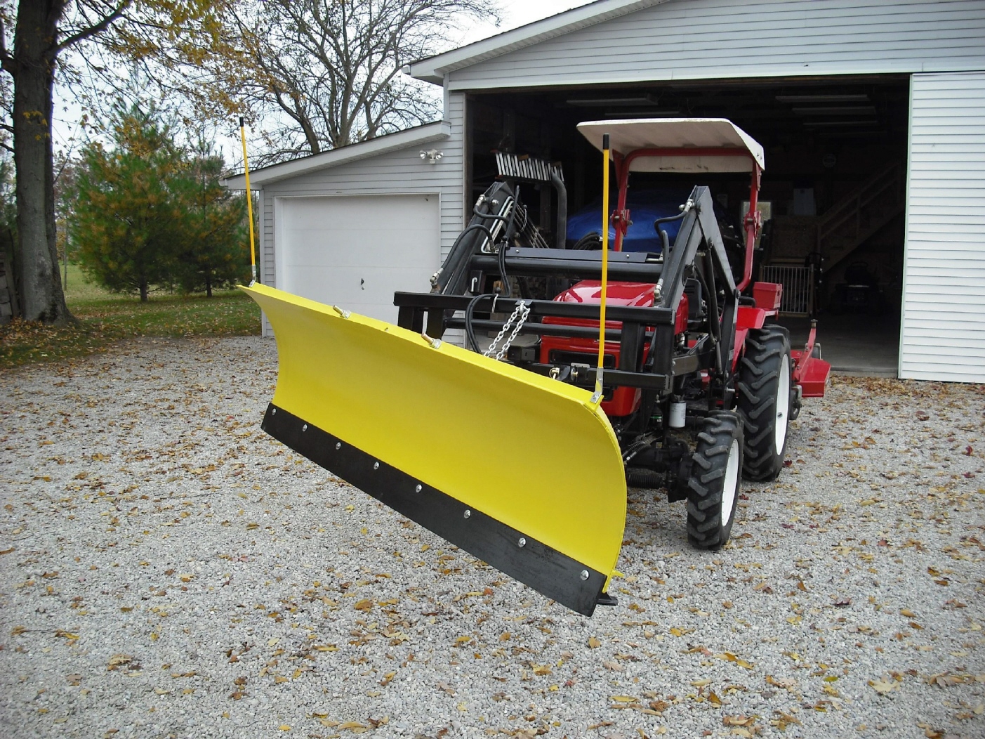

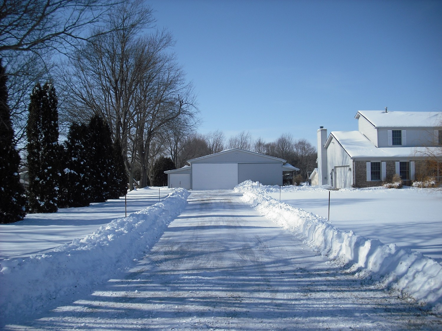

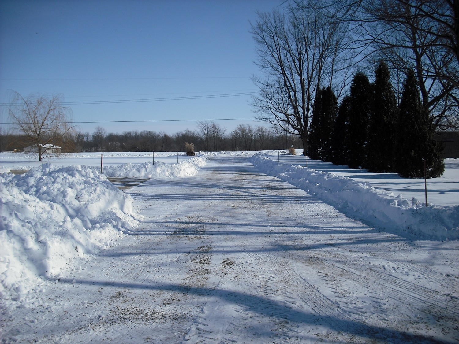

I have only gotten my tractor stuck 1 time digging a grave for a horse with the FEL. I have 600 plus hours on this tractor and we have had as much as 27" of snow on the ground at 1 time in a 24 hour period. I have a 28HP tractor with the tires loaded, rear wheel weights, 4 front suitcase weights, and a FEL. It weighs about 5,200# with the snow plow on it and 7' rear grader blade.
I mow with this rig also using a 6' Caroni RFM. It does not harm the turfs one bit. Just do not go in when wet plus my tractor will go places my neighbors could not even think of using turfs and R4's. I get called to plow my neighbors 1/2 mile of drive because his JD 35ish HP tractor with R4's can not do it.
Here is a picture of my rig but I still had the mower on the back. Also a picture of my last big snow which was 18". I can plow my 280' long drive in about 15 minutes tops.

Absolutely correct on this one Chris. Types of soil and weight of equipment along how you are using attachments all paint the picture differently. The op is looking for quite the spread in versatility and his cutting I think is for his lawn. If that's the case, turfs with chains should cover his needs quite nicely. Love the pics by the way. Is that the Northern Products tractor? What size rear tires came with this?
   / New Owner - tire, chain, scraper questions #16
Yes and no. All these Chinese tractors are made by 3 or so big companies. Jinma is the largest and most popular. That is what Northern's tractors are and that is what mine is. Mine is a 2003 rated at 25HP but I put it on a pto dyno and it turned 31. Its very strong. I also have a Ford 861 gas that is 45 HP but 2 wheel drive and this Jinma will out work it any day. So far I have had good luck. Getting close to 700 hours and only replaced the starter and the thermostat due to failure.
