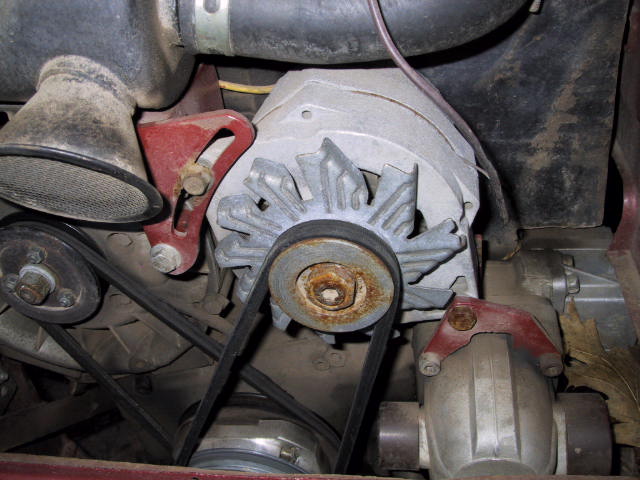

Tom, I would be honored to be featured on your site! If it helps even one tractor to survive, it will be worthwhile. I have also grafted a GM Si alternator on, which has worked out really well- I will have to get pictures of that up too. Keep up your site! It is a wonderful resource!

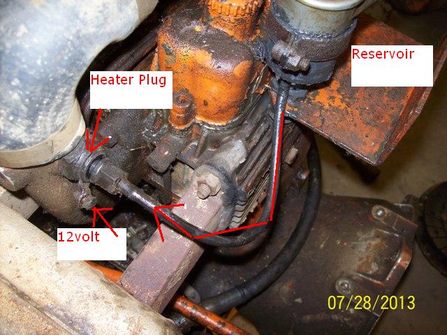

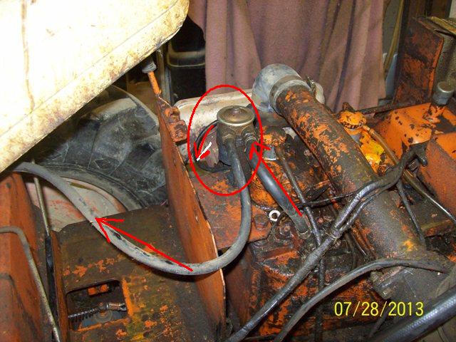

I have a cold starting set up on my 997.
I'll post some pics at a later time. It is basically a small reservoir that is filled by the fuel return line between the injector return and fuel tank. This feeds a small amount of fuel to the heater plug in the intake manifold.
The heater plug and this set up seem to be very common. The plug is listed on eBay for less than $20.
Massey Ferguson Heater Plug Part Numbers # 2666103, 893501M91
Most, if not all that I learned about this set up was gleaned from Massey Ferguson literature.
Joe
