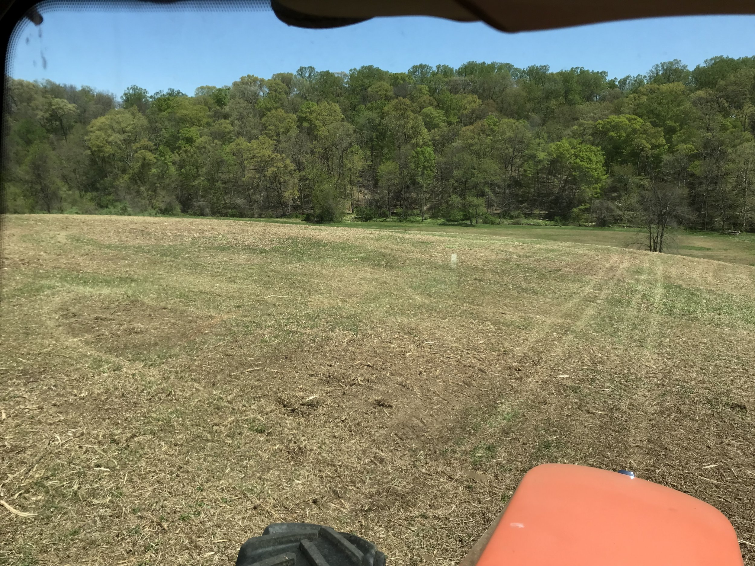

Hello all, Me and my wife bought our place about six years ago. There was about five acres that had been clear cut by the previous owner. He let it grow up and by the time we got it, it had grown up a lot. We hired a forestry mulcher to come in and clean it up. In the process of harrowing it and getting it ready to seed. My question is there are so many maple and gum saplings that just keep on coming back. I brushhog them as low as I can and just keep cutting them but they always come back and then some. What is the best way to take care of them?

Thanks for the help. I think the main problem is that when the where mulched up the stumps where taken down to ground level and wherever there was a stump I get stands of sapling trees. I could try pulling them but would have to pull the stumps which is out of the question. I might try spot treating with some brush killer after I have cut them off and see if that decreases them. I'm just looking to make it usable pasture land. The land for many years will never be good for hay production. Just wanting to use it as another place to put cows to give my other pastures a rest.

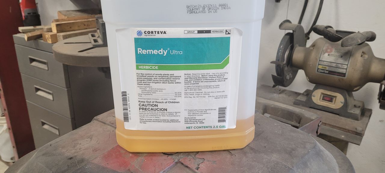

For spraying chemicals on a standing tree, "Remedy" works the best for me. You can gain some effectiveness if you mix in some 2-4-D. And that mixture won't kill your grasses. Some people recommend mixing with Diesel Fuel but that tries to kill everything it contacts. I also discovered from my friend last year that Remedy will kill lespedeza.

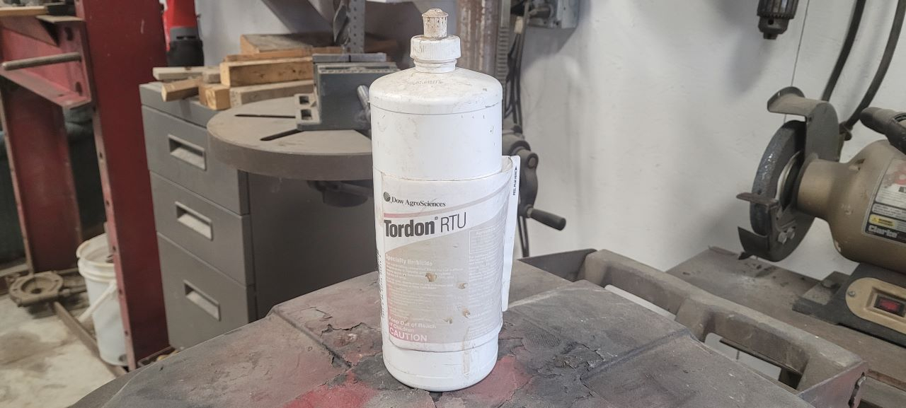

For stump treatment I use Tordon RTU. I also have some pelleted Tordon but rarely use it. Excuse my faded Tordon bottle, it rode in the chain box most of last Summer.
