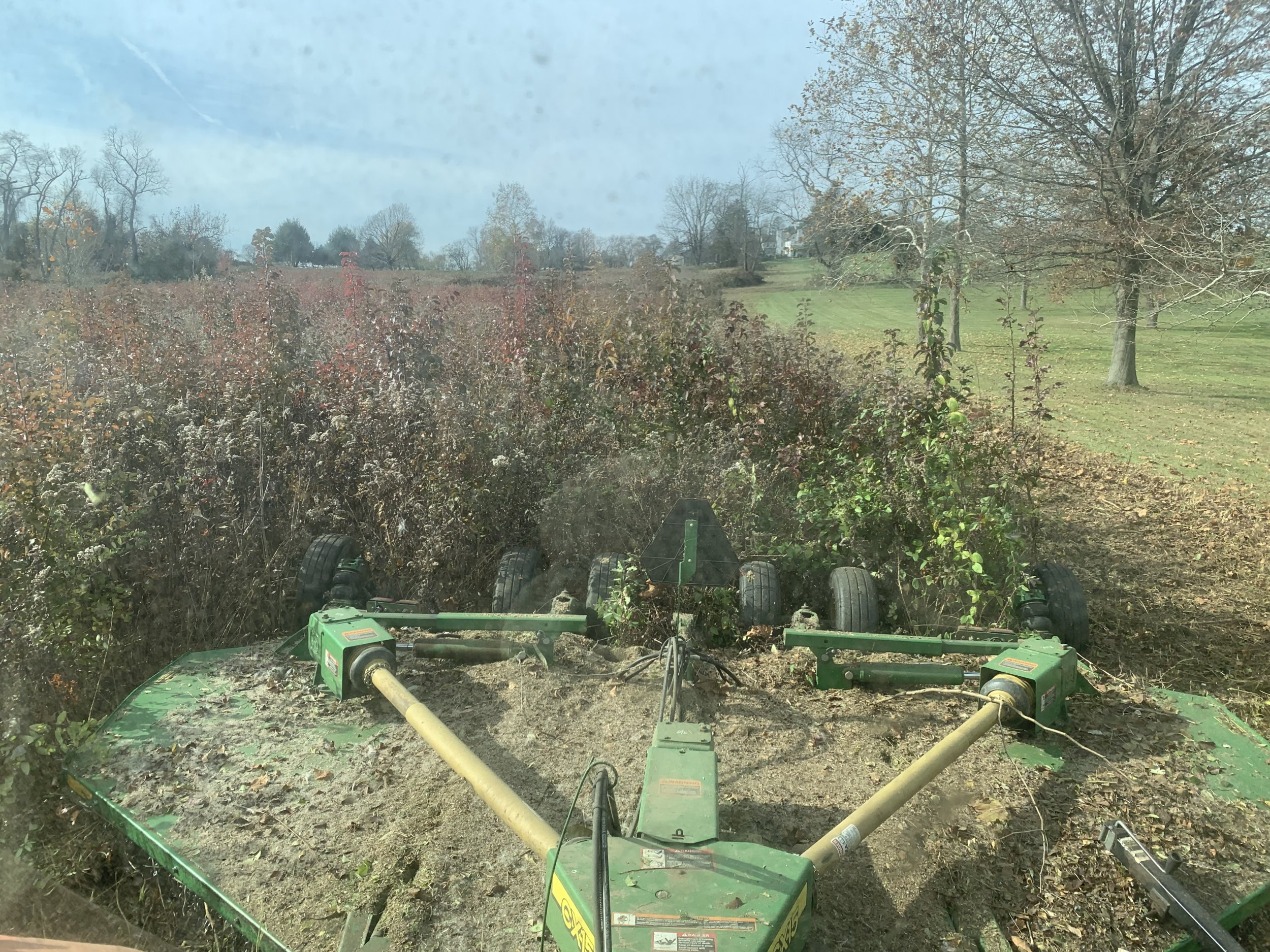

Made hay off this hilltop field 4 months after this picture was taken. It was scrub brush, autumn olive, blackberry stickers, hemp dogbane and other junk. It could just as easily been grazing land like the OP wants.

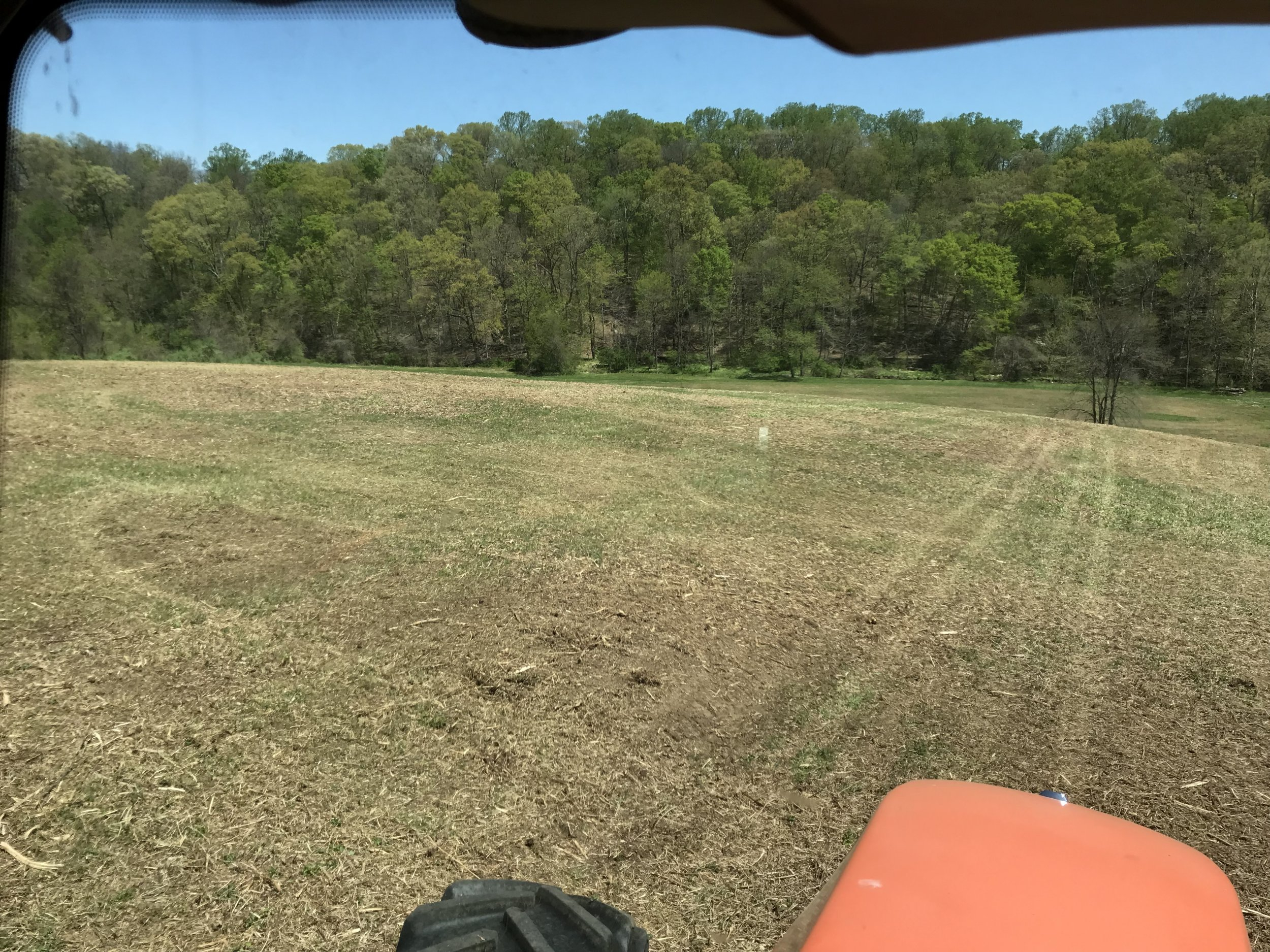

Here’s another I cleared about 10 years ago. Didn’t use any chemicals on this one, either. I cut this in the fall and by the following June it was producing abundant hay.

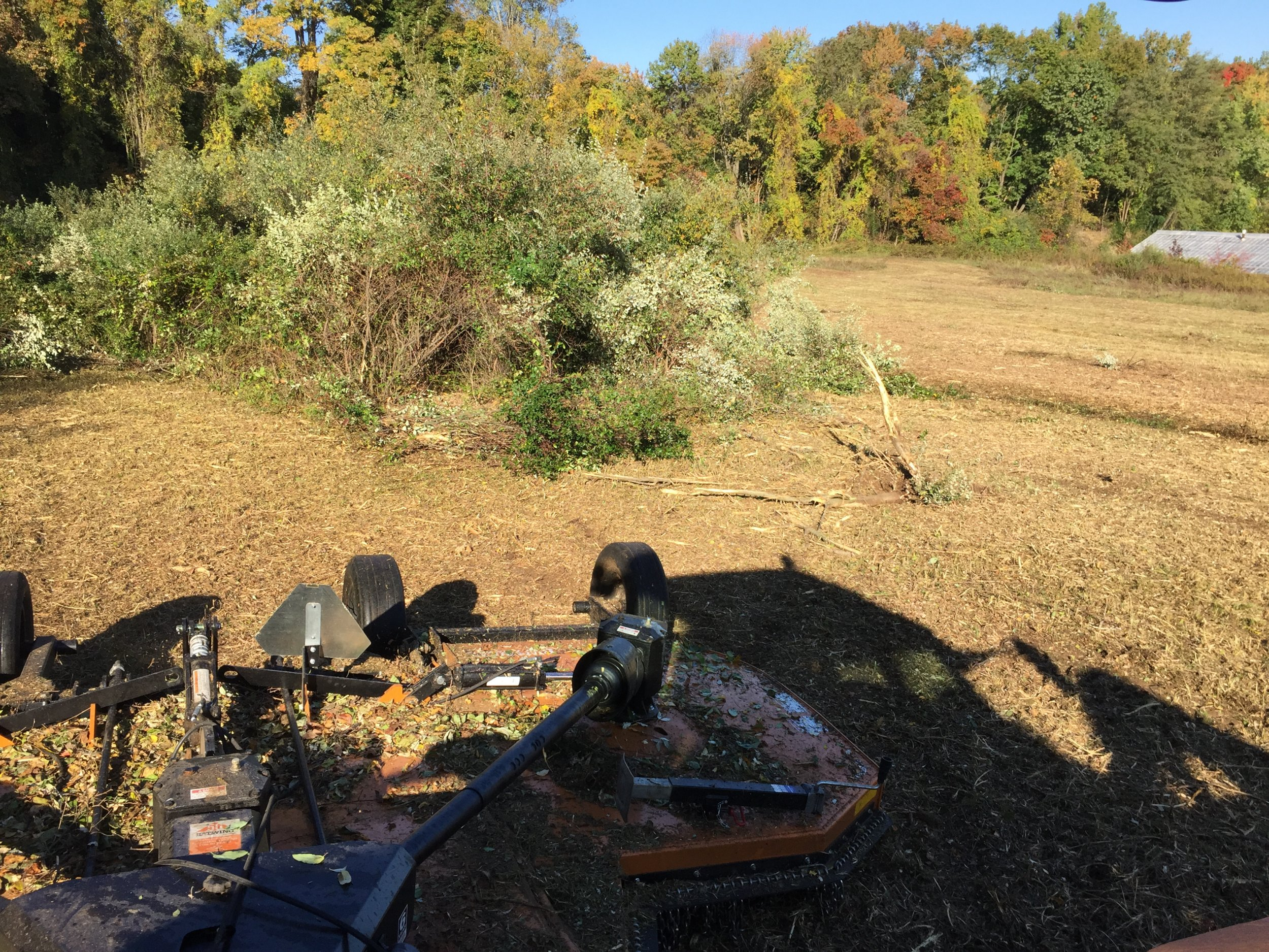

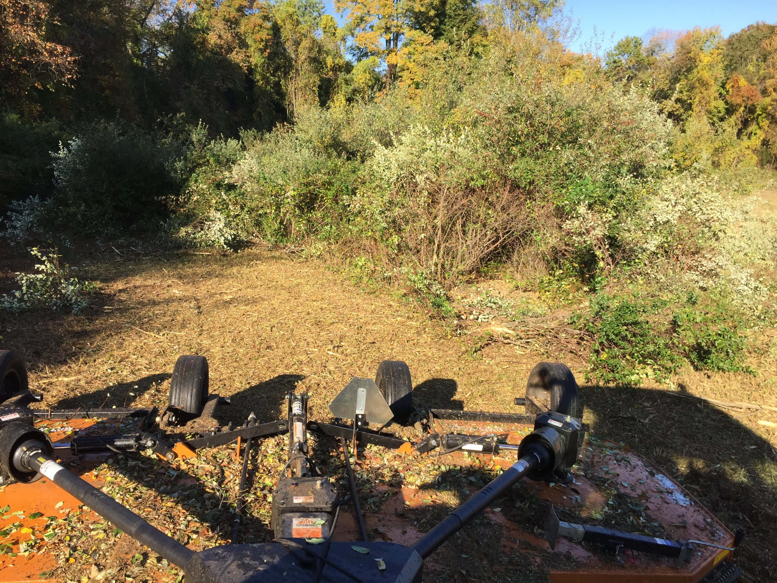

Here’s a field of saplings cut in October of 2015

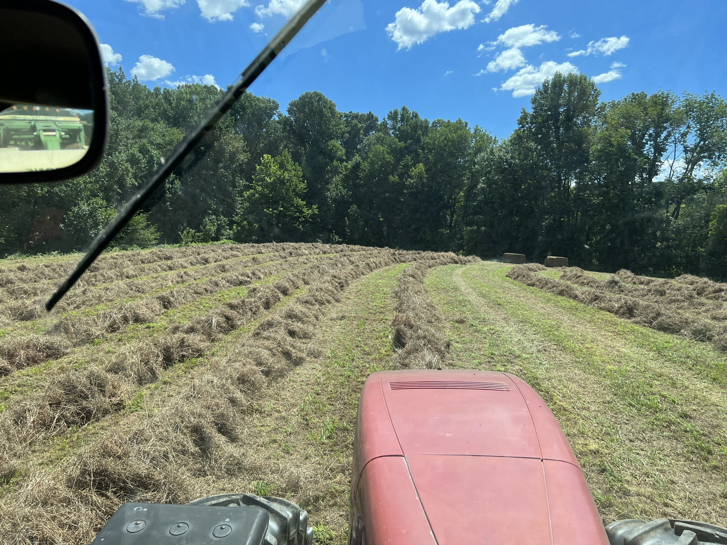

Here’s same field this summer making hay
