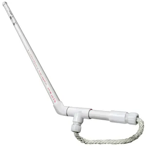

I've also noticed that down in Downeast Maine they clear fields for blueberry production in a similar manner as what you've done and the last eradication step is to have workers with wick applicators wipe the offending plant and they die. Rope Wick Applicator, Herbicide Wick Applicator, Weed Thief | Agri Supply
From the road, it appeared that they only touch the plant they wanted to kill.
