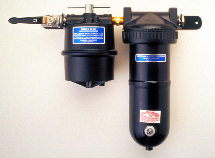

So I had some time to play with the plasma cutter a little more. First I had to clean my regulator and mount/ plumb my air drier. The in-line filter that comes with it didn't include the mounting bracket shown in the on-line manual. After looking through the consumables I found the bracket and the screws needed to install it (much different looking than the manual). I ended up installing a small regulator before the filter and it's set to 80 psi. I also replaced the push lock connectors for the air line between the filter and cutter with ones that are 90 degrees. When I get a chance I'll take a picture.
