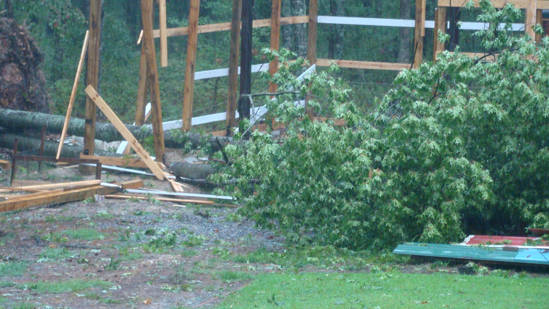

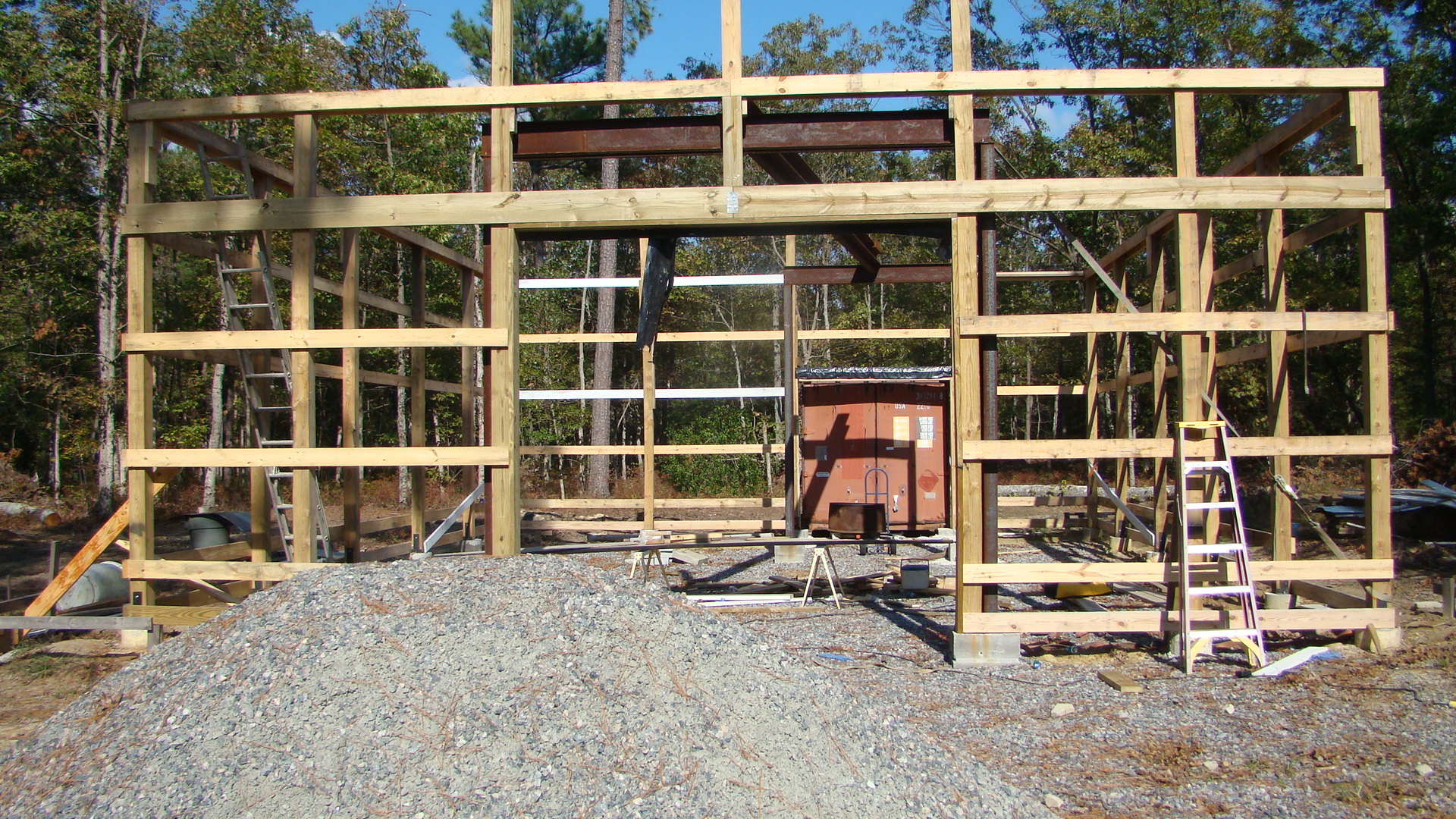

Well I'm finally back to square one. Or back to where I was the day after the storm. I didn't think there was as much damage as there was but I had to rebuild over half the barn. I had to tear out the whole front wall, most all of the left and part of the right wall too because it was bent and twisted so badly. I also went ahead and put 2x6's in between the double top wall headers and this helped stiffen and straighten up all the walls in the process.
I was going to build my own truss system but I have gotten so far behind I bought them already made and they should be here in about 2 weeks. I was planning on this to be a 6 month project but with all my delays and problems I had with the steel beam I installed and now the storm I'll be lucky to have it done by spring. I'm not really rushed for time but I'm at the point I'm getting fed up with problems and just want it done.
Before and after pics:

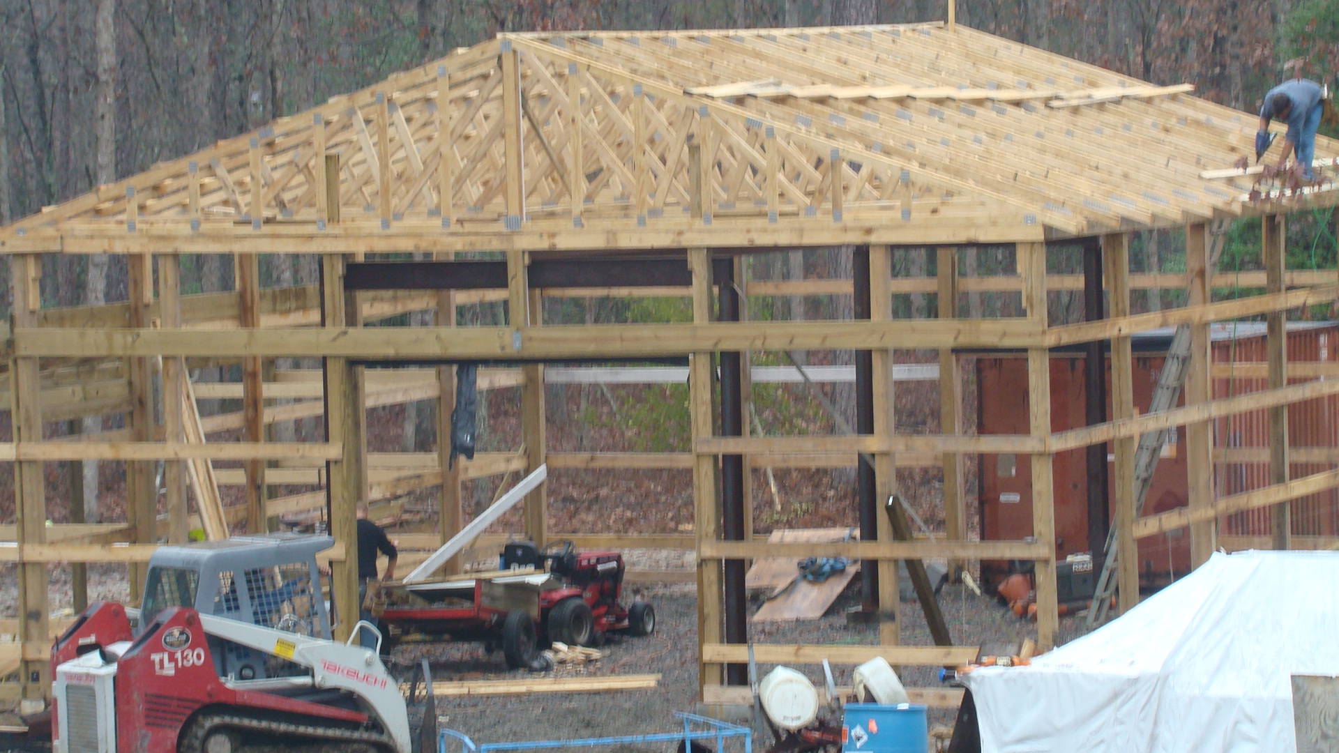

Oh I forgot my picture of the barn. I was going to take some pics of the woods and new roof on the house but it's been raining so.
