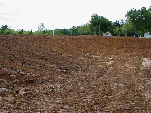

They took the dozer away tonight {darn it} The whole time it was here, they took the keys each night...........It sure looked like it would have been fun to play on.
/ new pond
#22
The dozer guy packed each layer of about 1' of clay before adding any more, then packed the topcoat of topsoil. I started to boxblade the dam smoother but was afraid I'd just loosen it where it might wash. I had him pile up the leftover clay that wasn't used in the dam so I could use it elsewhere later....
I have a mountain to move with the little iseki now.
According to my sight level the bottom is about 10'-11' to the spillway and the dam is about 2 1/2' above that. I plan to smooth out the yard around it this weekend and put down bermuda seed.
There is a large oak tree on the point we left sticking out into the pond. Once I clear out around it I plan to have a picnic table and some chairs, and possibly a small dock. I have some st augustine grass that I have been cultivating for plugging the yard that I will put down around the picnic area.

a few pics

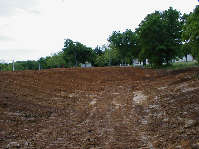

#24
If anyone up there is listening.......please add water

My little iseki is really earning it's keep lately. Today I put topsoil and st augustine grass on the picnic area of the pond.Then I started removing the loose clay inside the pond, a lot of loose clay.
Sorry, no new pics today, barely had time to eat anything.
Final dimensions look like it's about 150' x 100' or so.
Does anyone know if ryegrass is ok for the inside area while I wait on some water.I have bermuda grass seed for the dam.
Tomorrow I hope to get to the outside of the dam. I'll try to take a few new pics tomorrow too.
