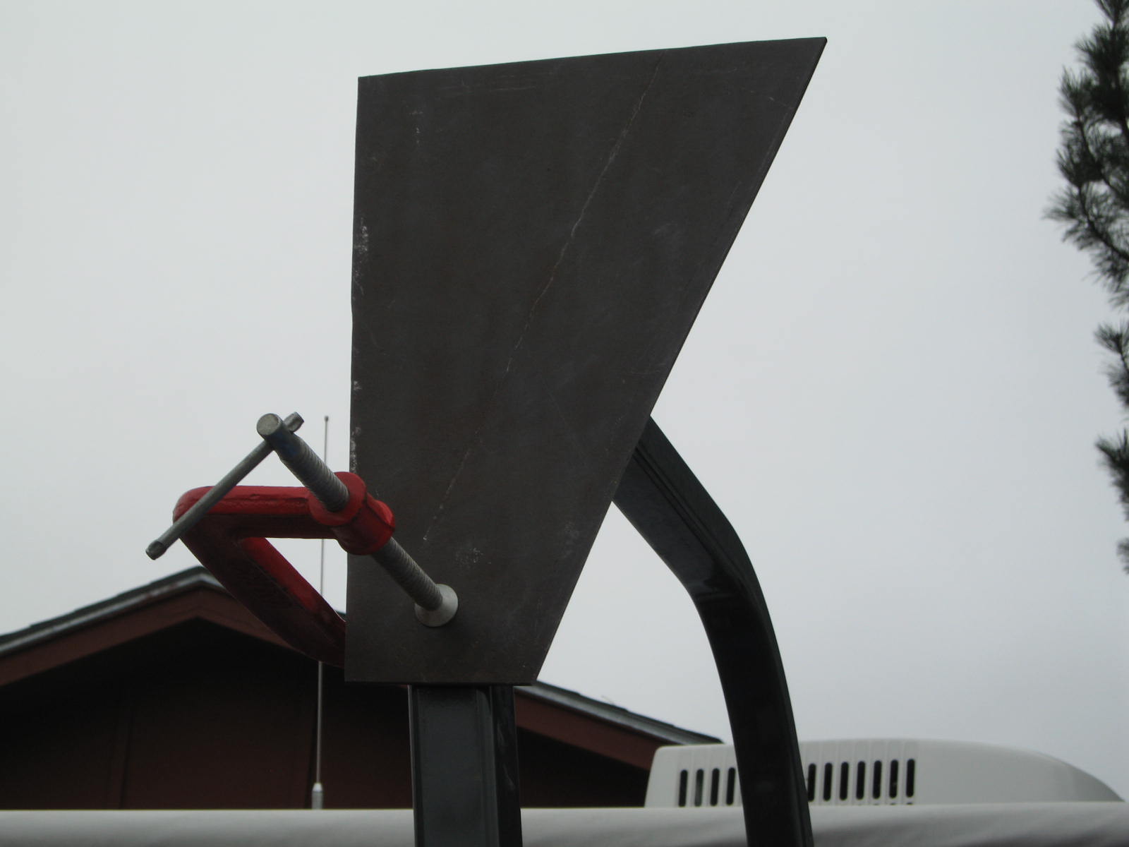

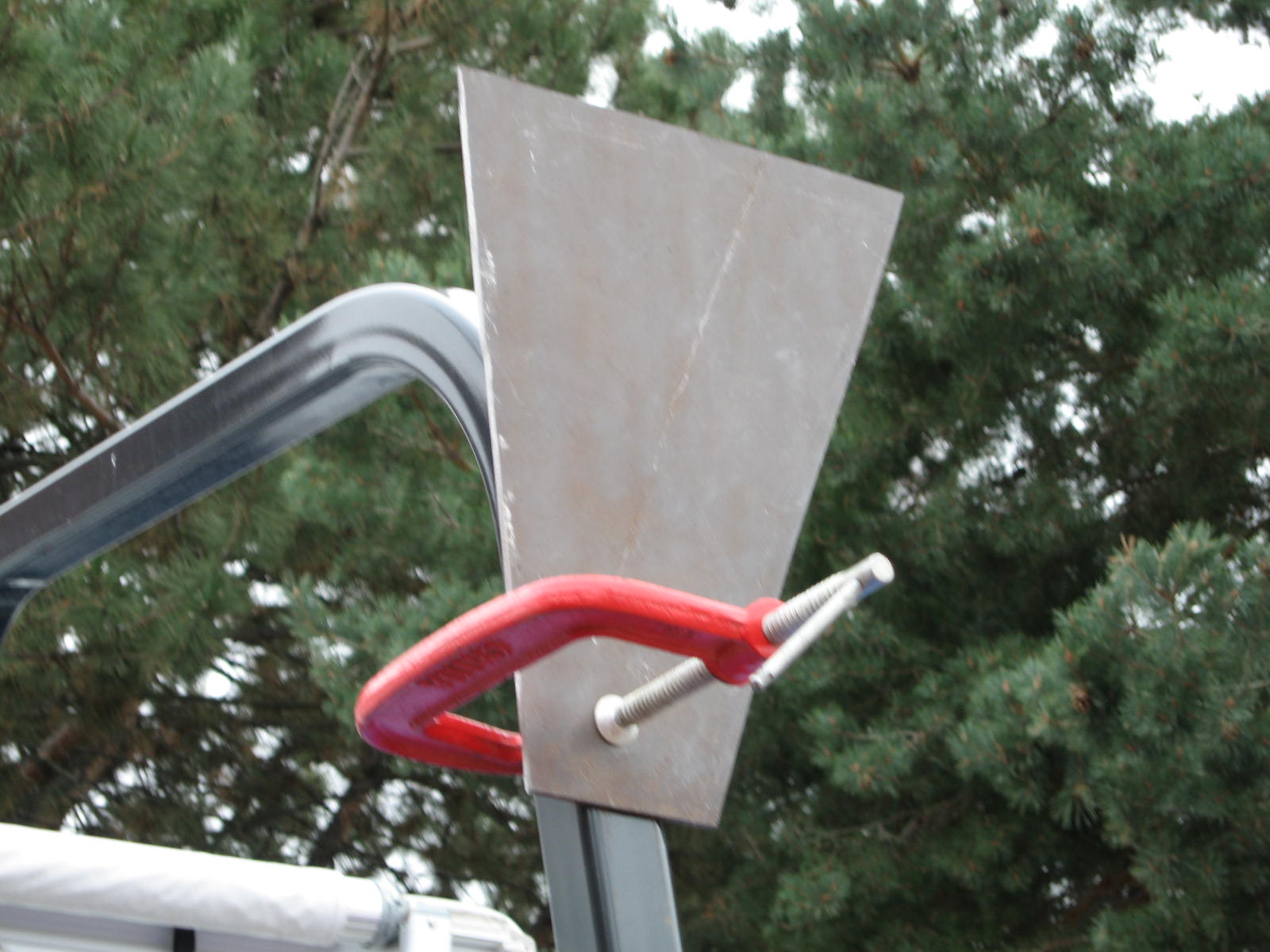

Getting started...I had no real cutting tool. Skill saw and a cuttling blade. Scrap came from the recycling place.

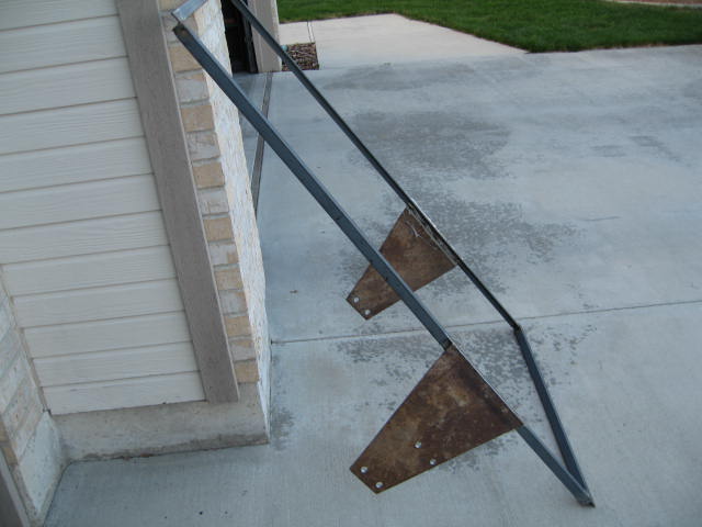

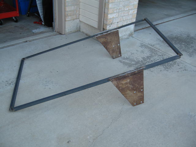

Marked one side support and drilled it out. I drilled the other side out using the first drilled support. Put them on on the ROPS using the u-bolts and cut the sides, clamped them on and then cut the ends. Pulled it back down and welded the box and then the supports to the box. The 1x1x1/8" was .91 a foot.
