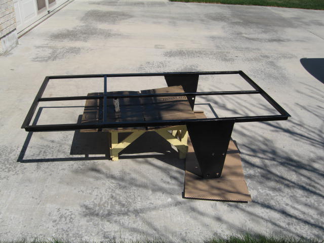

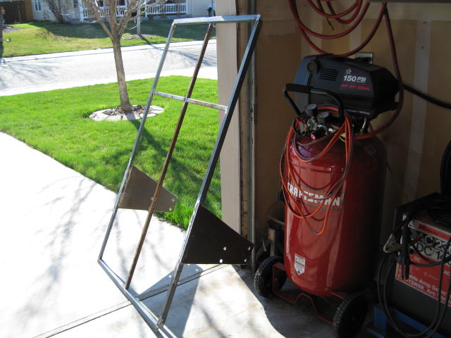

Measures 35 W x 61 1/4 L. The angle cost me $14.56 @ .91 a foot. Total out of pocket cost so far is $66.82. My bunged up finger doing this today is priceless..ha
   / New Porject - Mahindra Canopy
#12

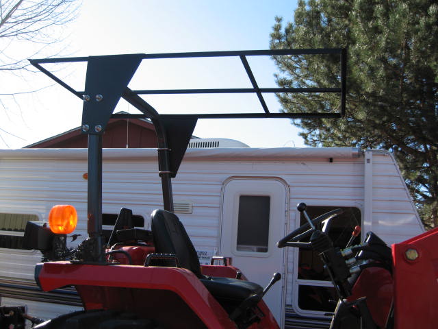

I'm kinda concerned I may have made it too long. I may have to mount it to the tractor again and make sure I can see the bucket at it's full height overhead. If it's too long I'll cut it down.
#13
Buddy had some spare small square stock so I beefed it up a bit. Didn't add a lot of weight, but, it's much more solid. Ran a piece all the way down the center and then added the two sides. I think the length will be fine. The ones they sell are 50" & longer and my length is shorter since I used some for the back end.
I'll make sure everything fits today, rattle can it, and cut the diamond plate and I sould be good to go.

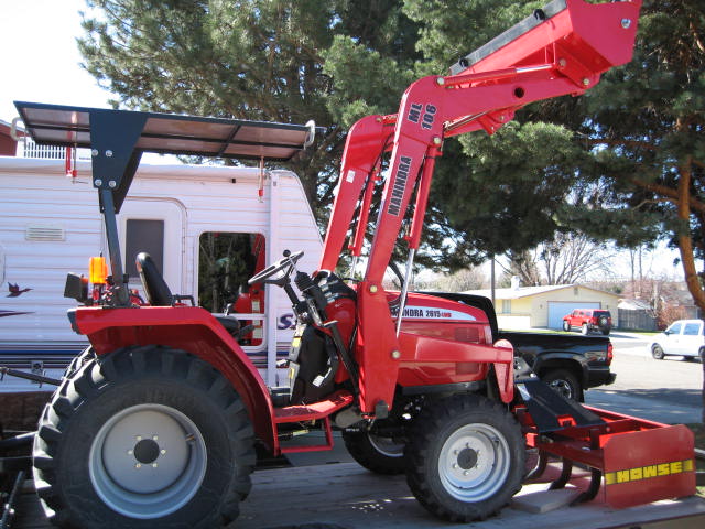

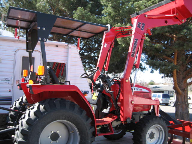

Painted. It's also mounted to the tractor, but, I don't have picture of that yet. Looks nice and just the right size. Had to order SCO Insulation for the roof. Can't seem to find it locally. 19.99 for a 3/8" 4'x6' sheet and they ding you 7.99 shipping. Shipping is such a rip off anymore, but, gas prices...

Almost finished. Cut the diamond plate myself with a skill saw. I'm not paying a sheet metal shop 65 dollars for 15 minutes work to bend the sides. Cut off the excess bolts and ground them down. I just need to wait until the SCO insulation shows up and buy a few bolts for the top.
94.80 out of pocket and I need 8 small bolts and a can of adhesive. I'm sure I can come in under 5 dollars for them.
