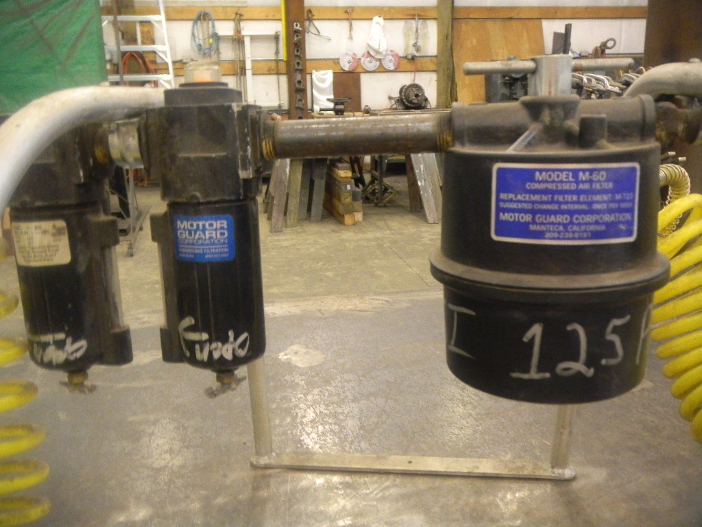

At a minimum I would buy a Motor Guard filter system.
SA, What is the model number you have? I started looking on line and it appears there are charcoal filters and some just use a roll of toilet paper for the replacement filter. :cool:
   / New Powermax 45XP! Crap... I was just about to pull the trigger! #13
The filter on the left is: Model AF510. Replacement filter RC-4020.
The filter in the center is: Model CO-4515. Replacement filter RK-4015.
The filter on the right is: M-60. Replacement filter M-723. Some people use a roll of toilet paper.
This system can only take up to 125-PSI. I use this system for my nail gun. I use the air dryer for plasma cutting, and painting.

Is there a simple way to judge if the air supply is dry "enough" for plasma cutting?

Only thing I can think of, is if you go through consumables too fast.

Believe it or not. Harbor Frgt actually has a decent moisture / oil filter designed for painting. It's really not too bad. I've used all the top selling filters out there and there are really only a couple good ones La-Mon and Motor Guard for starters but this $30 HF set up is worth a look. I painted a 5x10 trailer with a cup sprayer and used the HF system after a friend mentioned it. No fish eyes at all. I had some Thermal Dynamics Filters which are good for small time plasma cutting but they are $120 and they let me down in 20 minutes of painting. I'd vote Moto Guard on the Plasma and the HF $30 Paint filter for painting..

Look at the side length of your Electrode. If it has thin black barber pole swirls. That is moisture. Or look inside your tip if possible. Same thing. Most importantly is that if you cut for 20 minutes on a 6hp 60 gln everyday compressor, You have a moisture issue. Smaller compressor? Even worse. Rectify by purchasing the best dryer / filter in your budget. Or just get used to swapping out $20 worth of consumables on a regular basis.

In fact I have already installed the cheap HF filter/regulator just off my tank.
1/2 in. Air Line Filter/ Regulator with Gauge
Definitely will put something downstream nearer to the plasma cutter. The motor guard seems a cost effective add-on for now. If and when I install a cutting table and get serious, then I will be explain'n to the better half that I really need an air... no honey not a hair, dryer! :p
