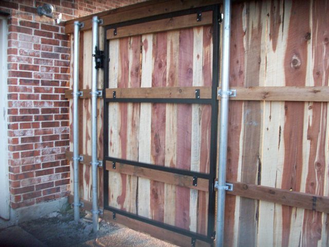

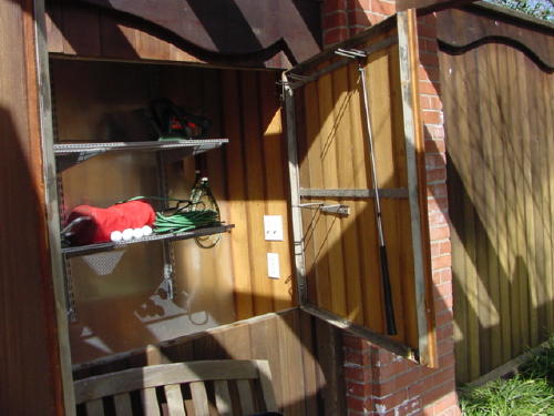

The first couple of pictures are of a western red cedar fence with a hidden locker installed.

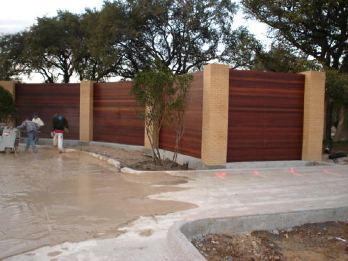

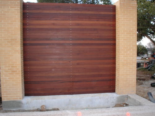

The next ones are of the massanadaruba fence.

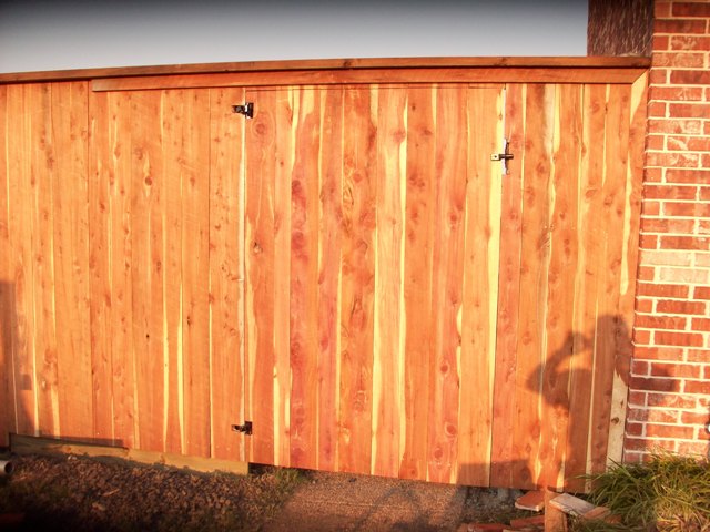

The last ones are of an eastern red cedar and some gate details.
