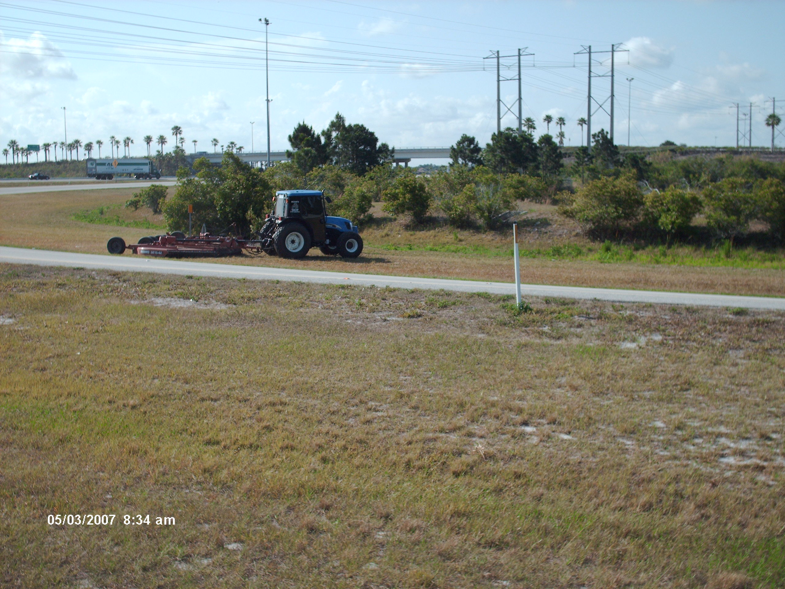

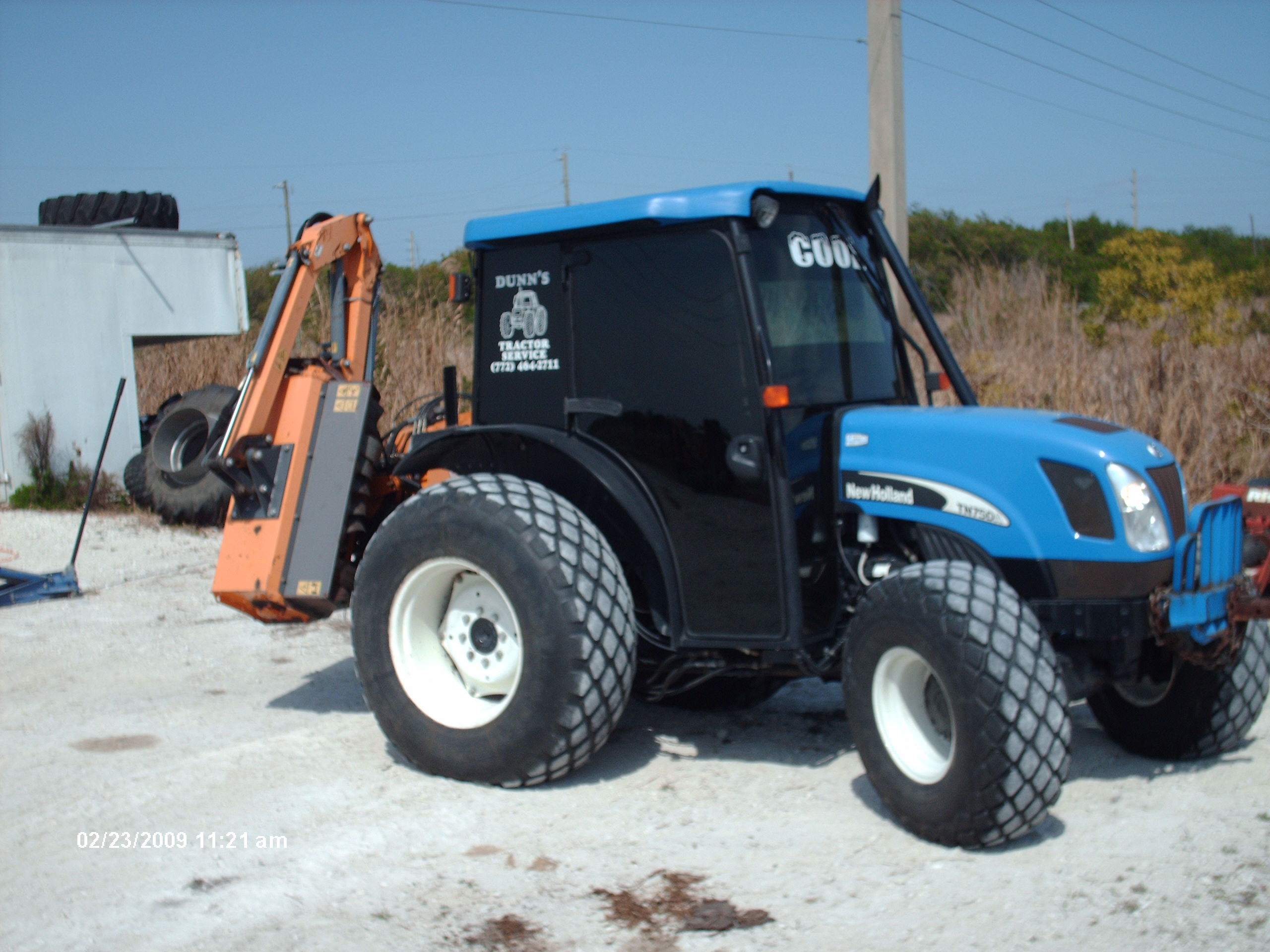

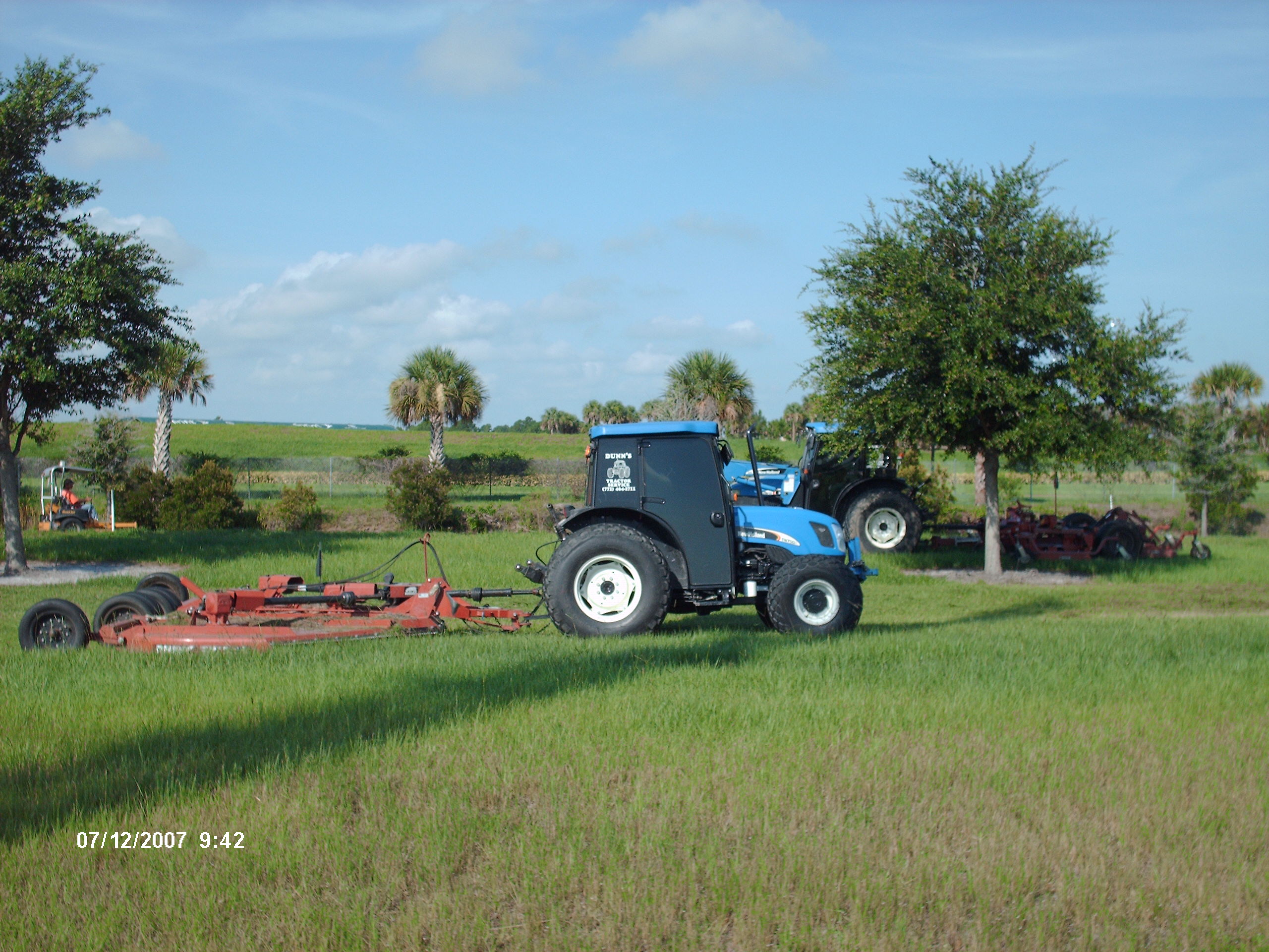

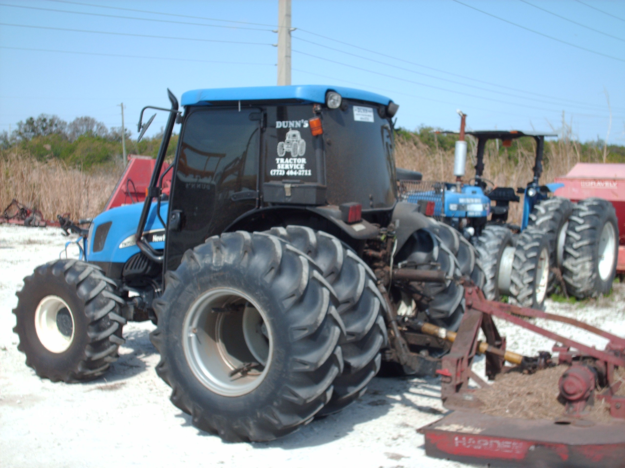

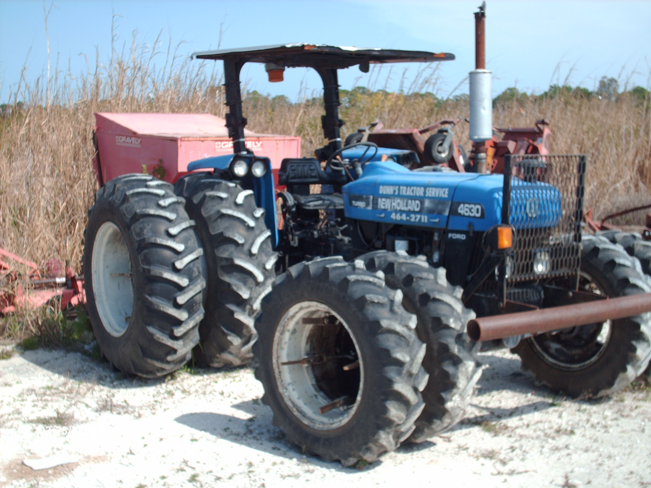

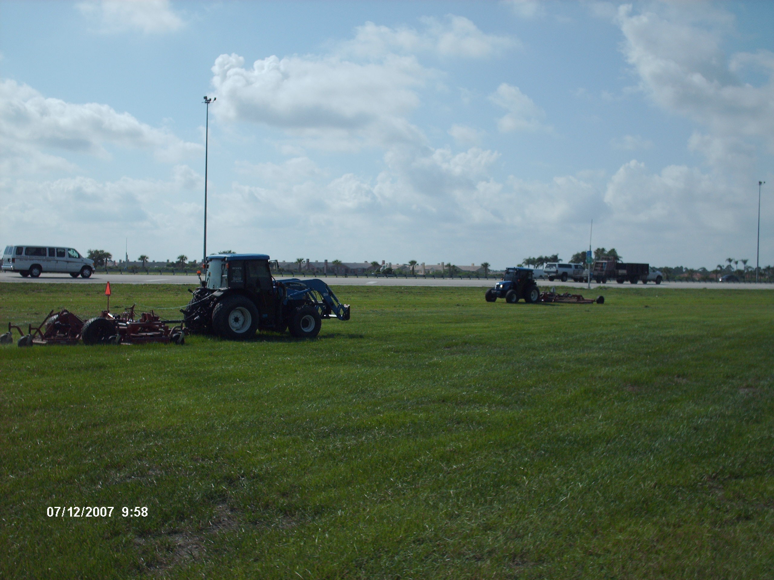

I am curious though, can you tell me more about the tractor in your avatar and possibly post a larger pic of it? Is it one of your TN's? If so it would be only the second one I have seen with rear duals.
   / New Problem Oil leak on TN75D #13
here some my NT75 at work we keep one set at all time with duals and another one as needed. We have 14 NH total with the nt75 being the smaller ones and the NW ts110 the largest with 2 of them being set up as duals front and back
