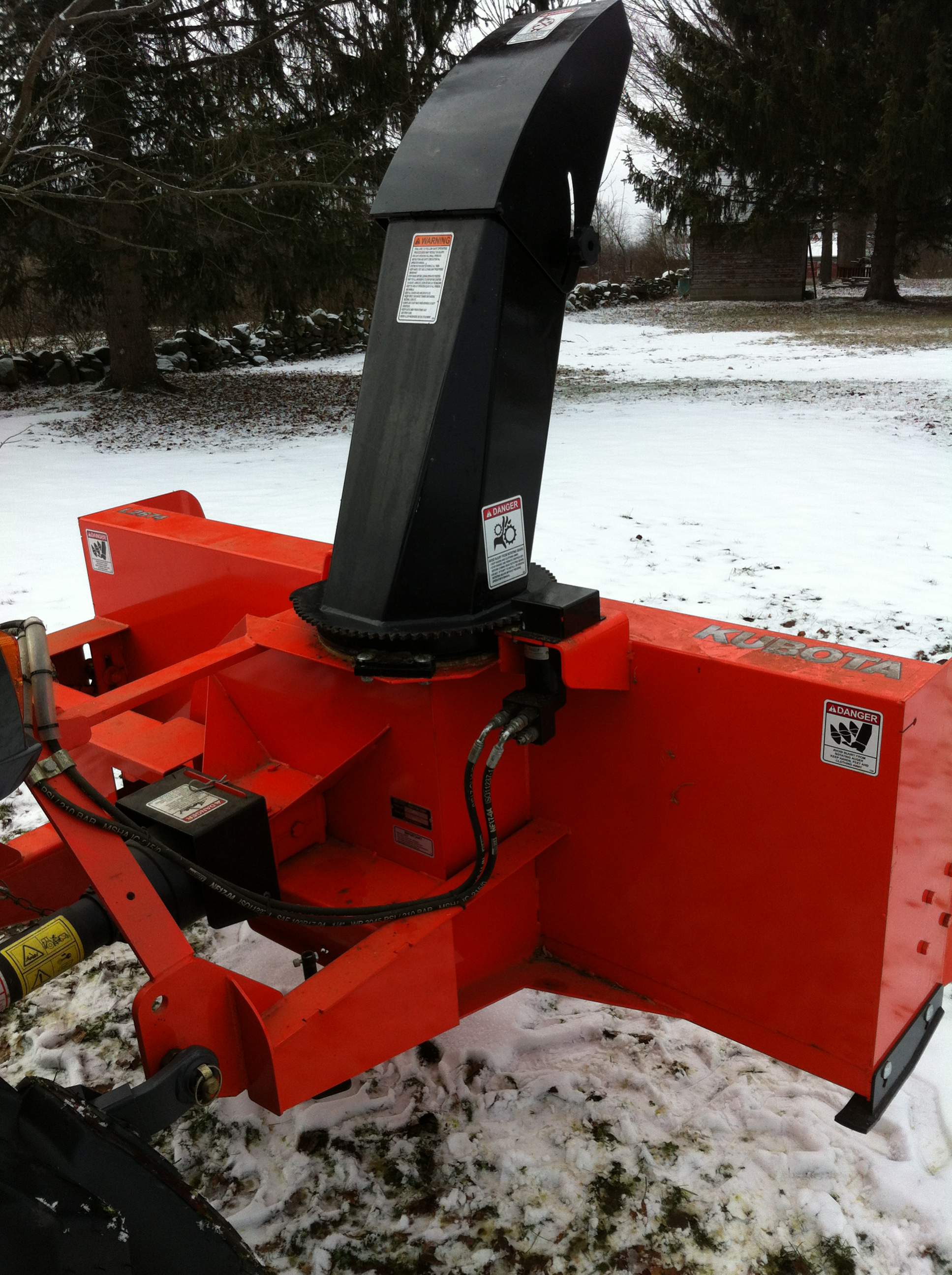

Gee nice looking snow blower, it will work well for you. I like the color too, :thumbsup:lol,lol.! Gee some of the snow blowers seem so similar in design I bet only a few different manufactures are making for all. Mine is a LA2674 Kubota snow blower and it looks to be almost a twin except for a few different design changes. The chute on the Puma is hydro cylinder, on the Kubota it's hydro motor, bolt on cutting edge, round auger bar vs square, different shoe design but both seem heavy duty. Best of luck with that great looking snow blower and keep us up to date on your review.DevilDog

Thanks for the comments, DevilDog!! I wanted the hydraulic motor chute rotator, but they
sent the blower with the cylinder rotator instead. It seemed to work ok once I re-installed
it correctly, but the hydraulic motor seems less complex. Don't know if it's more reliable but
we'll see. I'm still waiting for the first chance to use the blower. Snow forecast for tomorrow
through Friday.

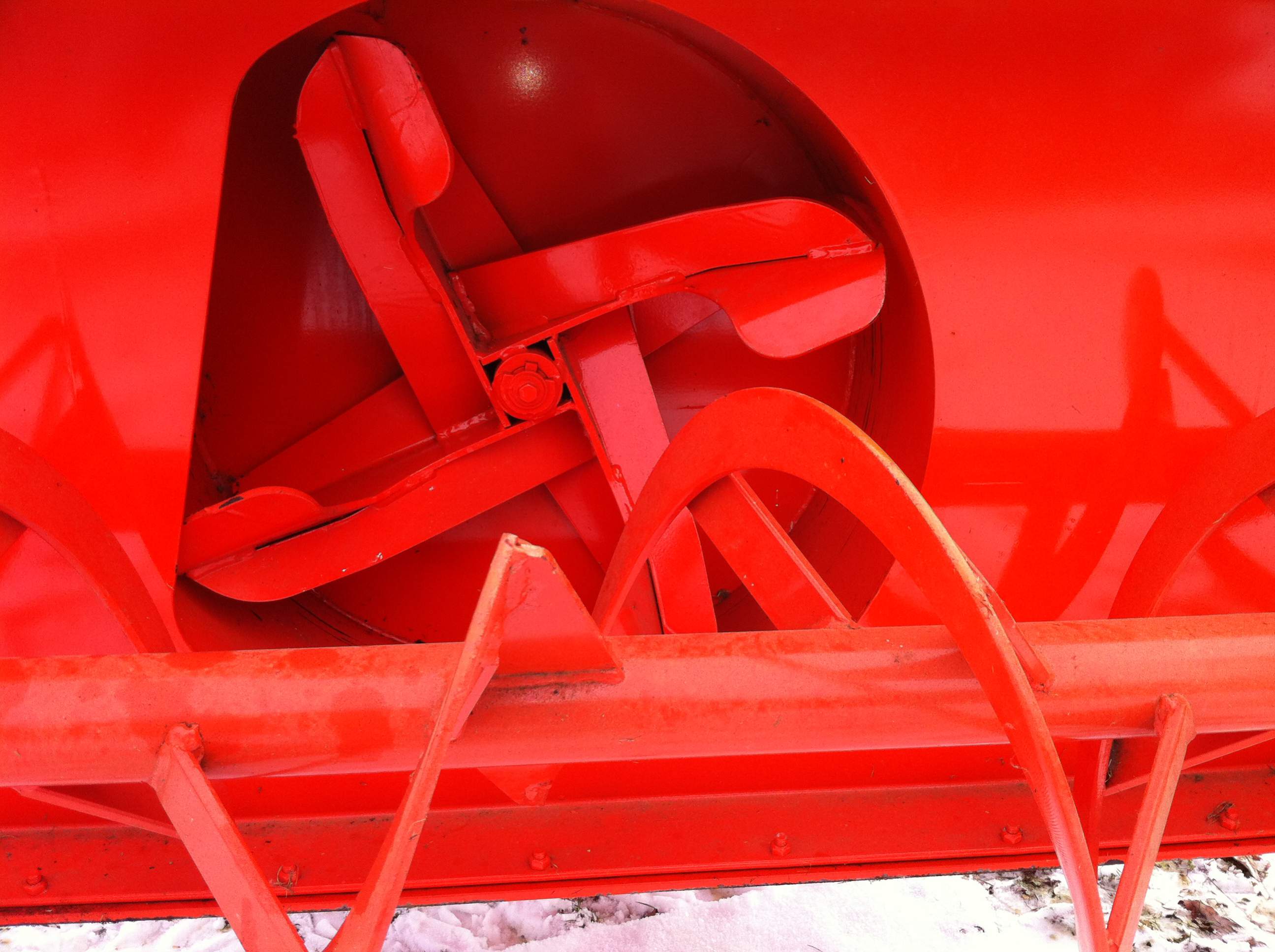

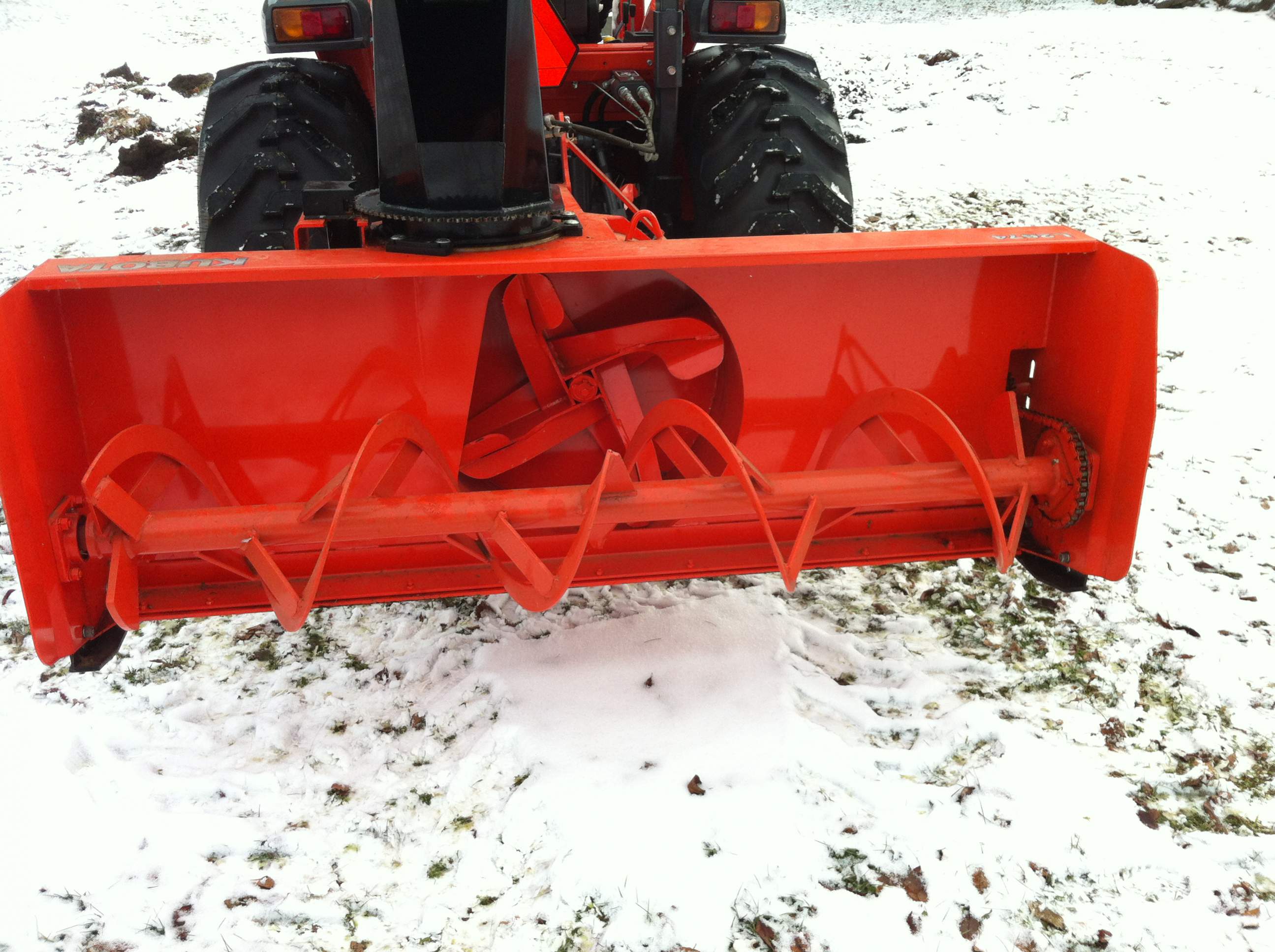

I finally had a chance to use the new snow blower for the first time, after an
8" snowfall of light powder snow. Sorry, but no pictures. The wind was blowing
at 25 mph from many different directions, as is usually the case after a nor'easter
here in New Hampshire. The blower worked quite well, despite the fact that I
had it adjusted just a little too low for a gravel driveway. The inside of the impeller
drum was 'sandblasted' from the gravel ingested and blown out the chute. Fortunately,
none of the small rocks hung up the auger or blower so no shear bolts suffered any
catastrophic failure.
The only problem I had was getting the tractor started. The temperature was about
5 degrees F when I went outside and turning the ignition key only resulted in the
clicking of the starter relay. With about an hour on the charger, that problem was
solved and it started and ran fine. The tractor hadn't been used much in the last
month, except for a short stint while changing attachments, so the battery didn't
get much chance to charge after starting it previously.
