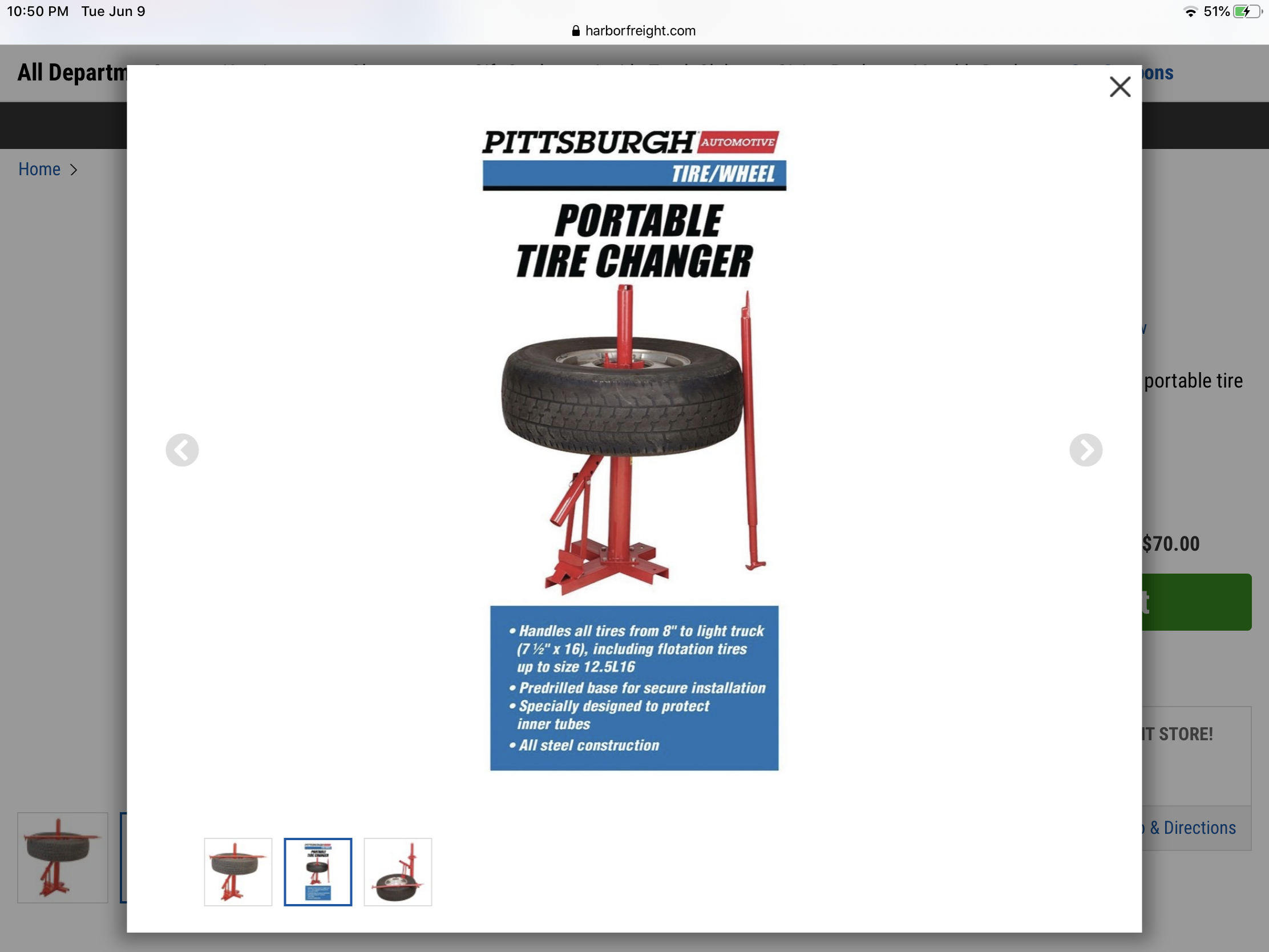

On that subject, how many of you to your own tire removal? I found out a trick that works really well to get the tire off the rim....
take it to a tire shop. :D
But seriously, I took it in once and they only charged me $10 to remove the tire and install the tube I supplied. Now, they no longer will do that due to liability. So, I do it myself at home with some harbor freight pry bars. I'm thinking of getting 1 of these for $40 at Harbor Freight. With a 20% off coupon it would only be $32.
   / New PT-180 owner #110
I have only done it with pry bars, and not for a long time. And no, I don稚 miss it. It was a bad combination of bad roads, bad Firestone tires that at one point gave us seventeen flats in six weeks. We got really good at tire changes and repair. Practice makes perfect and all that. We went to Michelin tubeless and had one flat in eighteen months on the same roads. Ask me which brand I have bought for the rest of my life...
That tire replacement stand takes a lot of stress. So, you would probably need to bolt it down, which means having a permanent spot for it. That alone would keep me from doing it. You may have more room in your shop than I do.
As always, YMMV...
