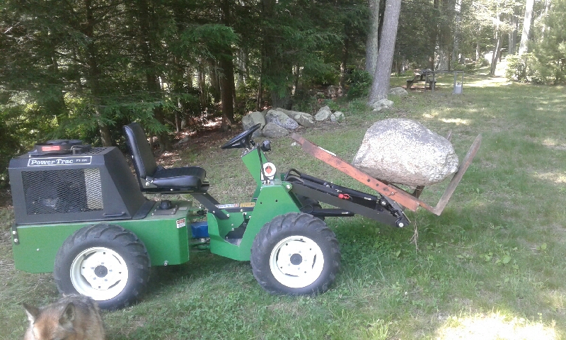

Thanks for the input guys. I searched around the yard today and no luck at finding the key... So I'll call terry in the morning and see if I can get one sent down to me.
I did spend a good several hours on it today mowing and doing bucket work, but I gotta say I wish I had bought the LM bucket as the regular one (in most cases) doesn't even challenge the hydraulics. I said most cases because I used it to move some of my pavers for a backyard project into the back yard and when I hopped off to open my gate the tractor tilted forward... Luckily I had the load low and it wasn't an issue when I hopped back on it.

I've had that happen too. Hop out, front goes down, hop back in, front goes up. Just a case of having sufficient ballast, in the right location. :)

That is known as the PT pucker when you're on the machine and it does it unexpectedly. Welcome to the club! :laughing:

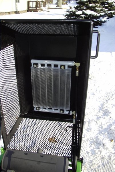

That is what I did because it was hard to deal with the duty cycle.
Awesome! Now, what fan didja get, what size is the cooler, and is it a push or pull fan? Also, where did you tie into the hydraulics? Or do you have a write up?
