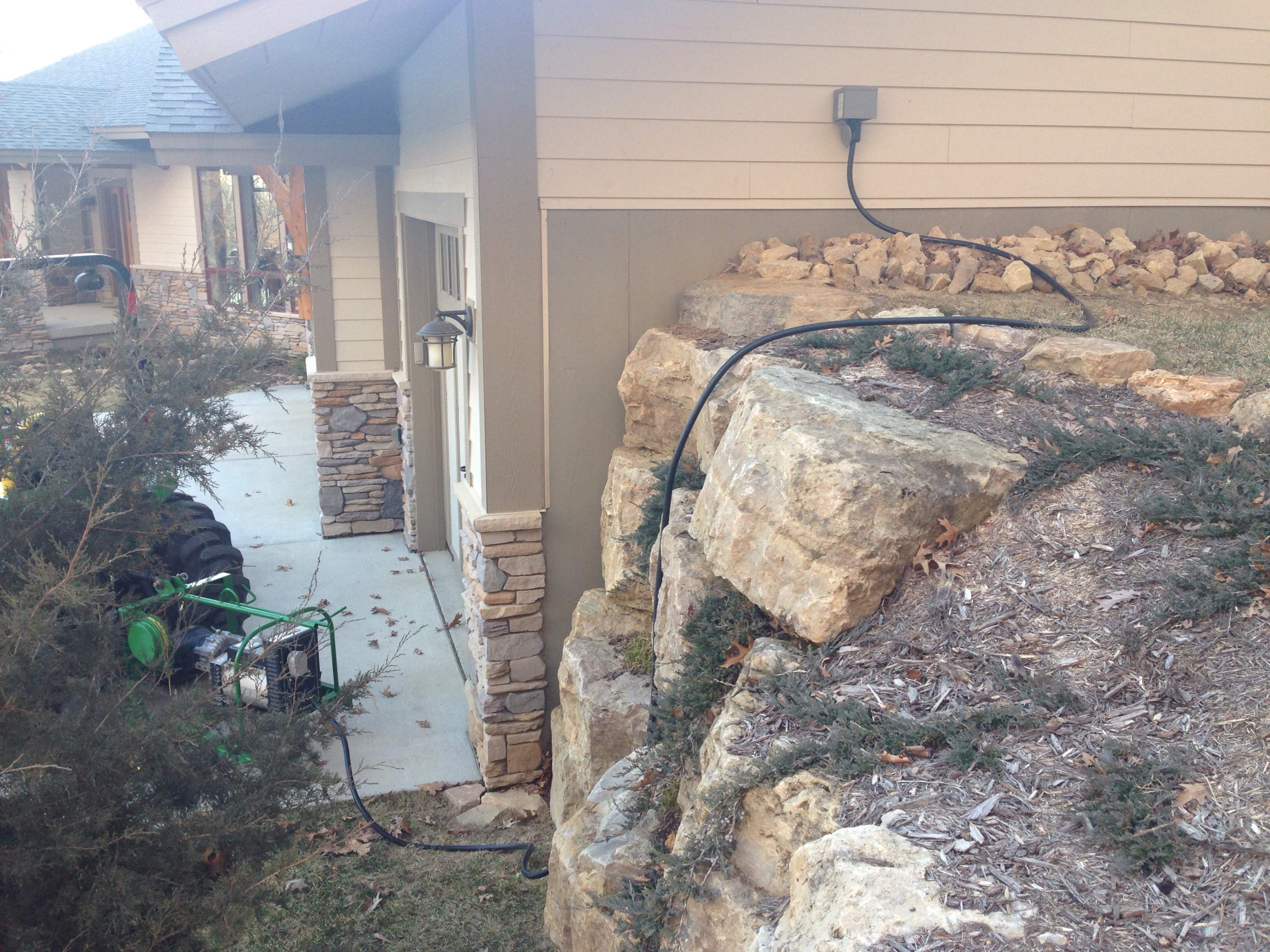

Here we are hooked to the house for a power outage
   / New PTO generator and 3pt carrier #23
I see your ground wire is still coiled on the unit,, What are you going to hook it too ????
#24
The Ground wire is only for running it in when a building ground isn't available. When it is hooked to the house it is grounded through the houses grounding system via the cord.
