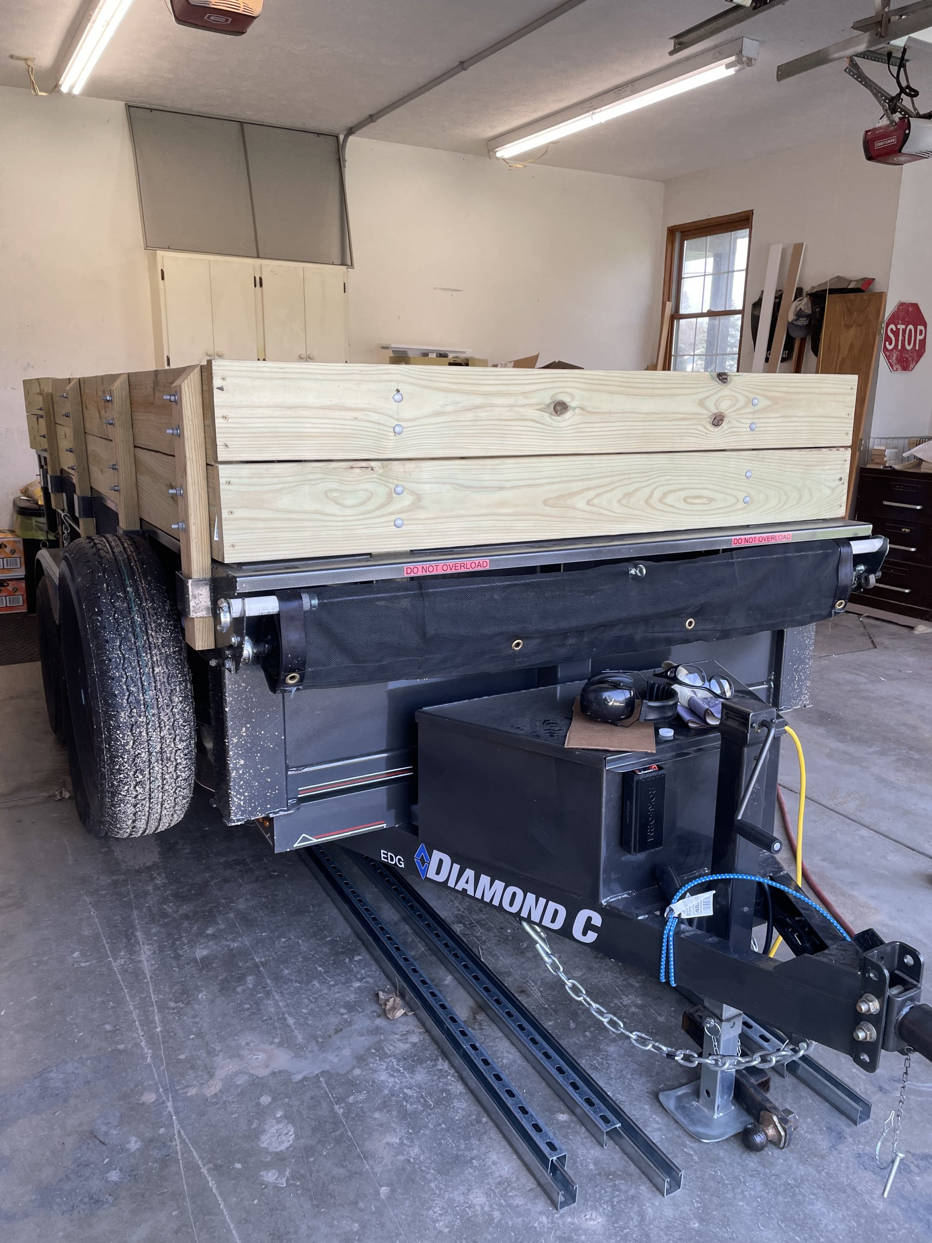

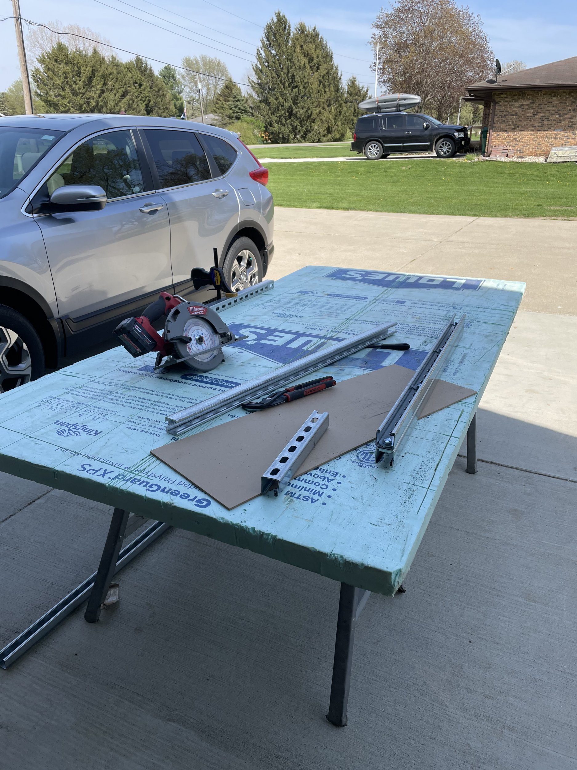

Picked up the P1000 slotted Unistrut and laid out a cutting table outside. To cheap to buy B2B strut so I had to remove small pieces of the outside channel to get my socket in there (I don't have any thinwall sockets). Picked up a Lenox steel cutting blade at Lowe's.

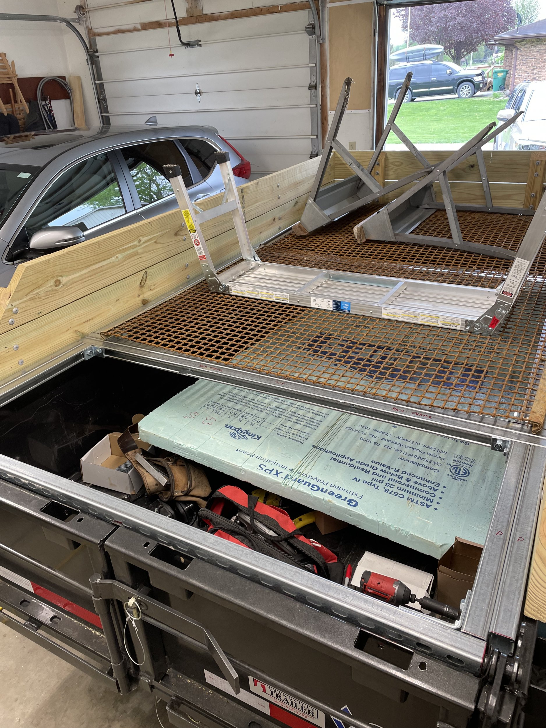

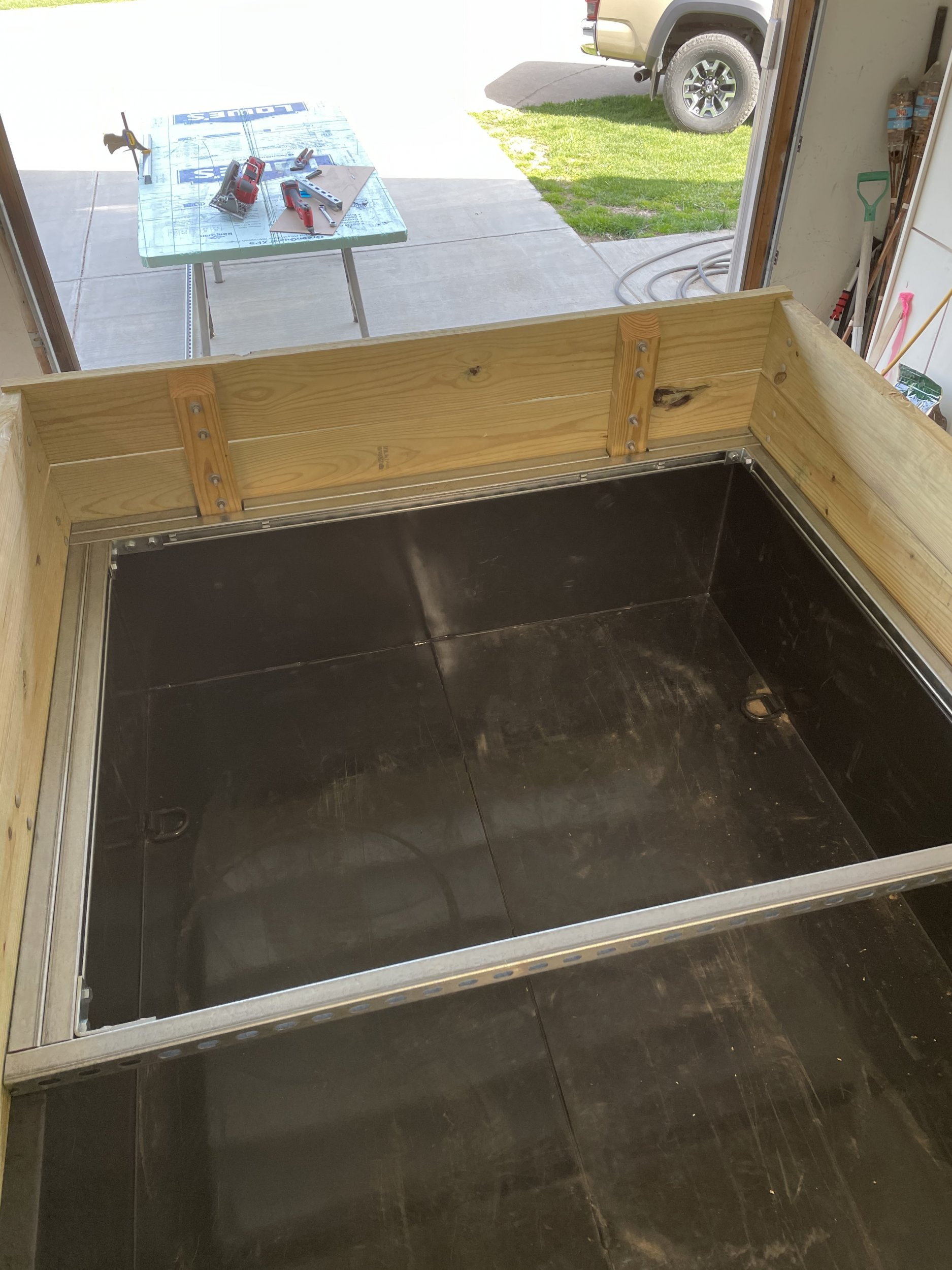

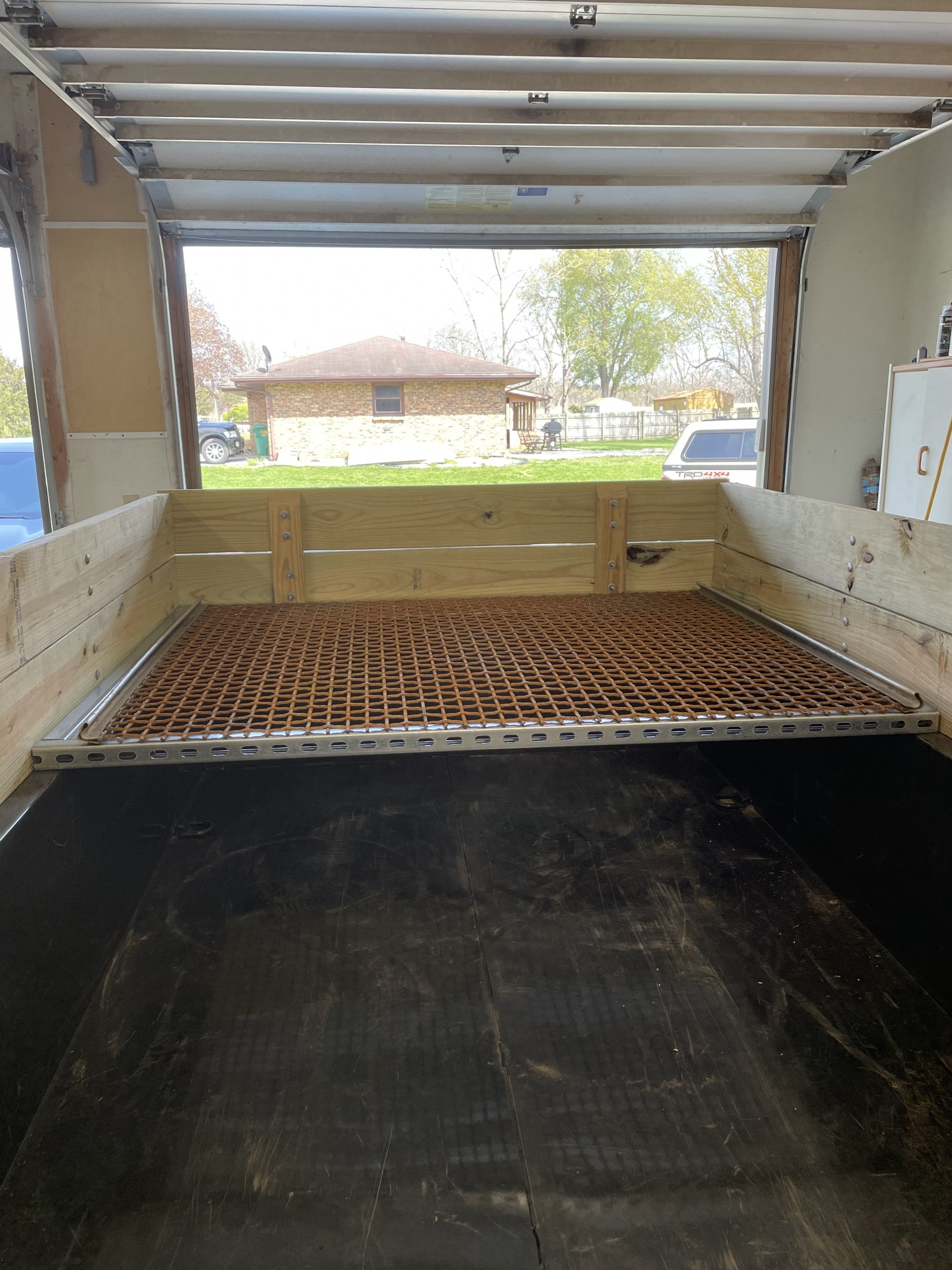

Trailer is 5'x10', got the first frame in place and laid the gravel screen with underside up as it has a camber from being used. Not sure yet how I will secure it down, maybe zip ties? Or, I can drill into the strut frame and utilized a bolt (or screw) and washer. I want to be able to remove this by myself and have hopes to screen some topsoil with it after overlaying with the correct size screen.
Double strutted on one side to close the gap. Secured that side with 4-hole 90's and the opposite side which sits on lip of trailer, with 2-hole. Strut bolts are 1/2"x1". Here's the screen sitting on the first frame.

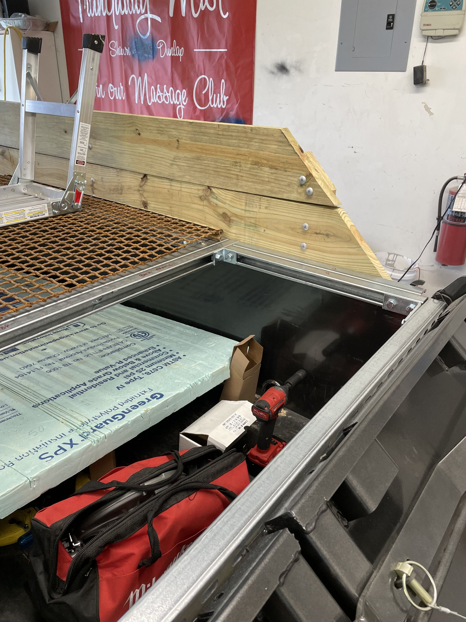

Another angle from the back. Not sure yet how I want to do the partial piece at the back. I know I want to be able to use the spreader function of the tailgate, and I'll have to cut some plywood "closers" for the gaps in the sides at the back.
For the landscape rock screening I'm trying to get all the dirt and debris out of the rocks so I plan to keep the bed down, dump in a bucket full, and have wife wash with power washer. I'll have tailgate sideboards removed but leave tailgate closed and (in theory) I should be able to raise bed, spoils will stay in the trailer and the rocks roll off the back nice and clean.

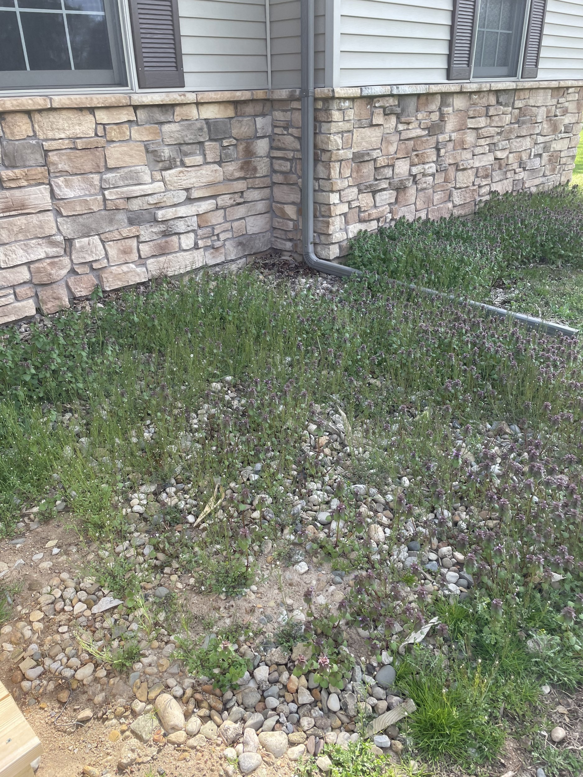

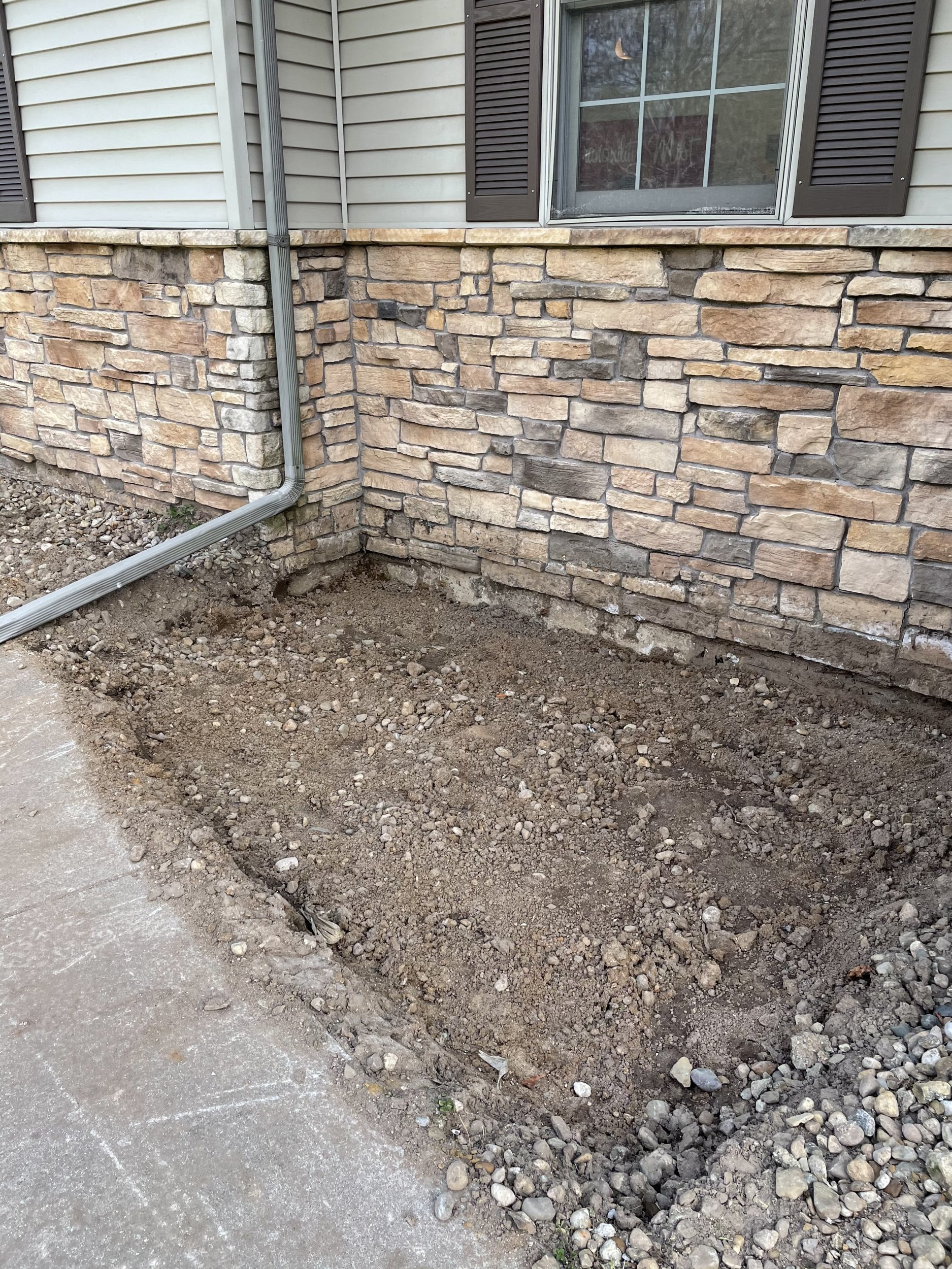

Here's a pile and look at location of where I'm removing rocks. Of course, I had to dig down a little and do some fixing from my boo-boo when I built the house in 1995. Cultured stone installed on foundation and continues to "slip" as I didn't do a brick ledge.

In my perfect world (ha) I’ll be able to keep tailgate closed and clean stones will roll off top above tailgate. If mud seeps out of tailgate I’ll try and park tractor bucket under and stones can roll into bucket. If velocity is to high and stones bouncing up onto hood I plan to have a partial sheet of plywood at back side of bucket.

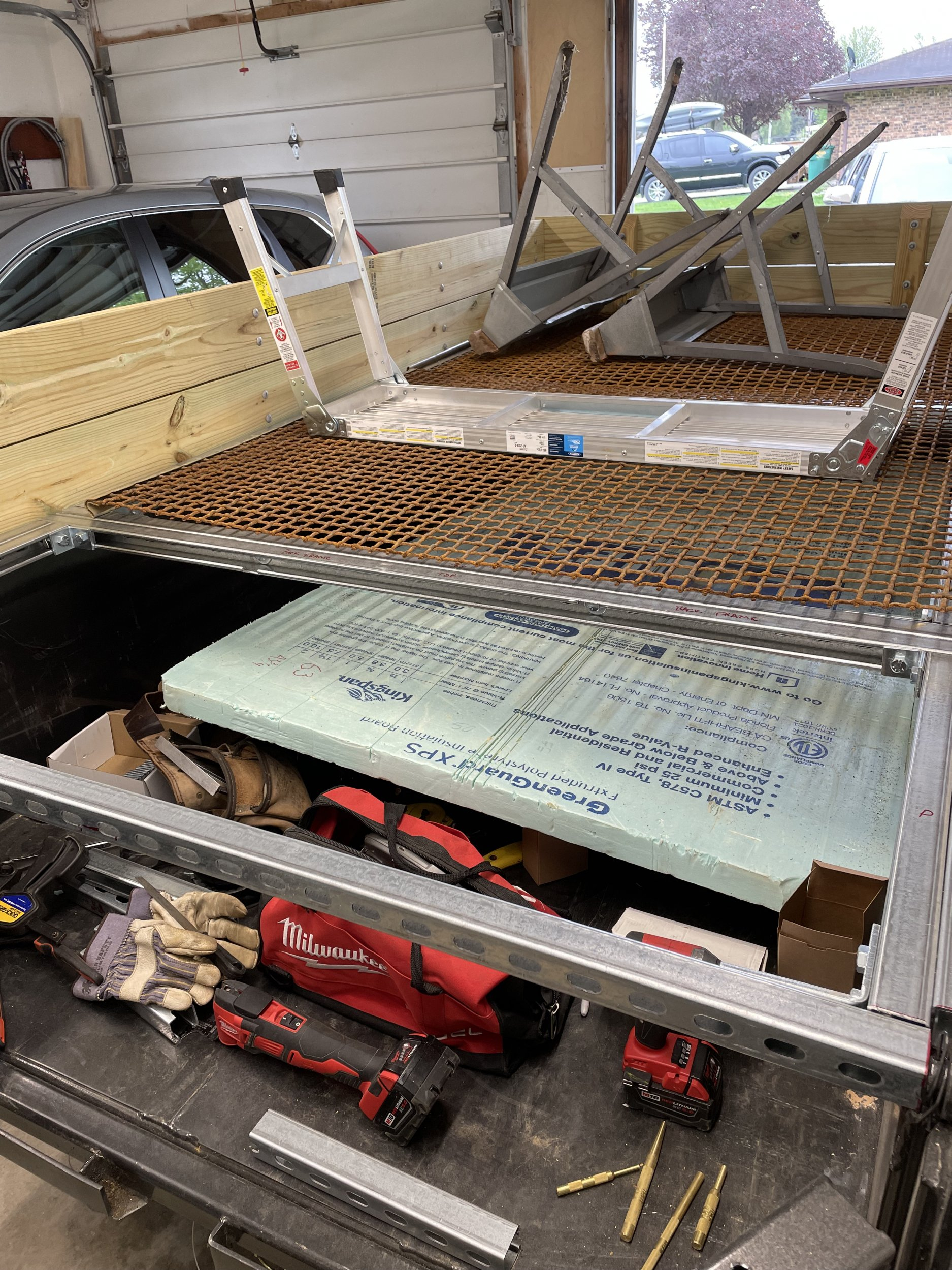

Didn’t get a whole lot done this weekend but am ready to cut last screen. I checked to make sure the tailgate could still open either way.
Now I’m trying to figure out how to keep it from sliding off the back when I raise dump bed. Got a couple ideas but I want to be able to take this in and out rather easily.
