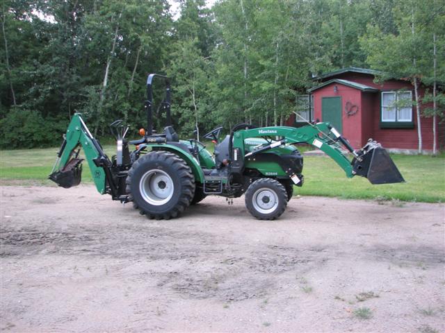

I haven't tried any extra front attachment as of yet. I was told it will handle the post hole auger from a Bobcat. That's one of the reasons I bought the Montana because of the higher fluid out put of the hydraulics than other tractors. Mind you it doesn't have the high capacity of a skid steer but close.
Hope those pictures help.

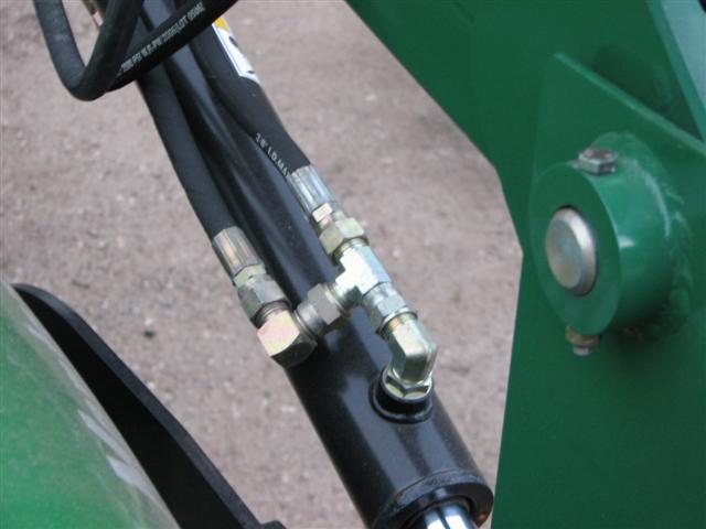

Thanks for posting the pics alltoys. If I can get the 3rd fucntion kit for that price I am going to order it, either way I am going to call my dealer next week and find out what my cost would be. I am wanting one for a grapple that I would like to purchase soon. And in the future maybe a plow for the loader.
Also can I asked you to take a couple more pictures?? I would like to see where the hoses connect under or in back of the tractor from the splitter for the 3rd function valve.

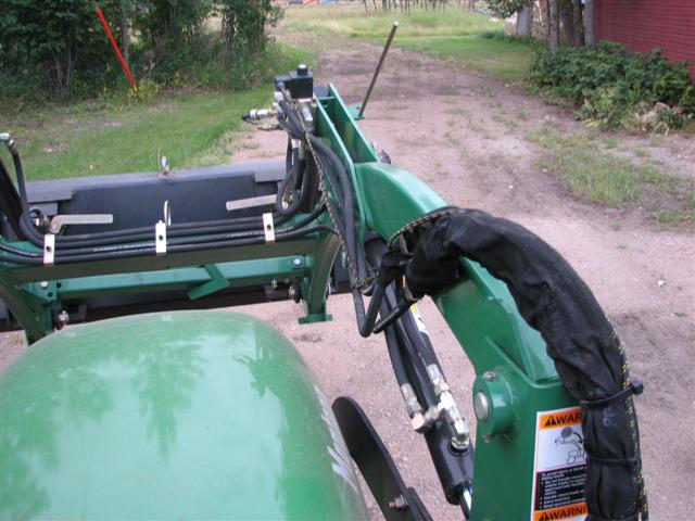

Don't know why I didn't see this before but the 3rd hydraulic is supplied by the loader tilt cylinder, tied in at the input to the nearest cylinder. See pick to understand.

Just a couple of things might make it better with the system I have. The electric valve is on when the button is pushed and stays open till the button is hit again. While it is open the joy stick operates the attachment. This way the grapple will open or close, Auger rotates in one direction or can be changed to operate in the other direction. This concept is the same that is used on skid steers and have been used for years. I had the identical system on my John Deer 7775 used it for years without any problems. Either way it was installed by the dealer and is covered by warranty.

Just a couple questions. Doyou know if your 3rd function is a true 3rd function or just a diverter? Do you still have control to tilt/curl the bucket and up/down of loader?
I would assume you have the diverter becuase it only has 1 switch, which should be cheaper that the actual third function. I contacted W. R. Long and got an approximate price of around $600 - $700 for parts and install myself for the true 3rd function kit, which allows you to keep all your other functions. I also email montana and got the part number for the kit (MTFKU1), but did not tell me if it is a diverter or true 3rd function. Right now I am looking for a 2 button rocker switch that will go into our loader control handle and get the parts for the rest of the 3rd funtion froma surplus supply. I have another thread started in the attachments section trying to find parts and ask questions about the 3rd function. Any input from the montana guys would be appreciated.
