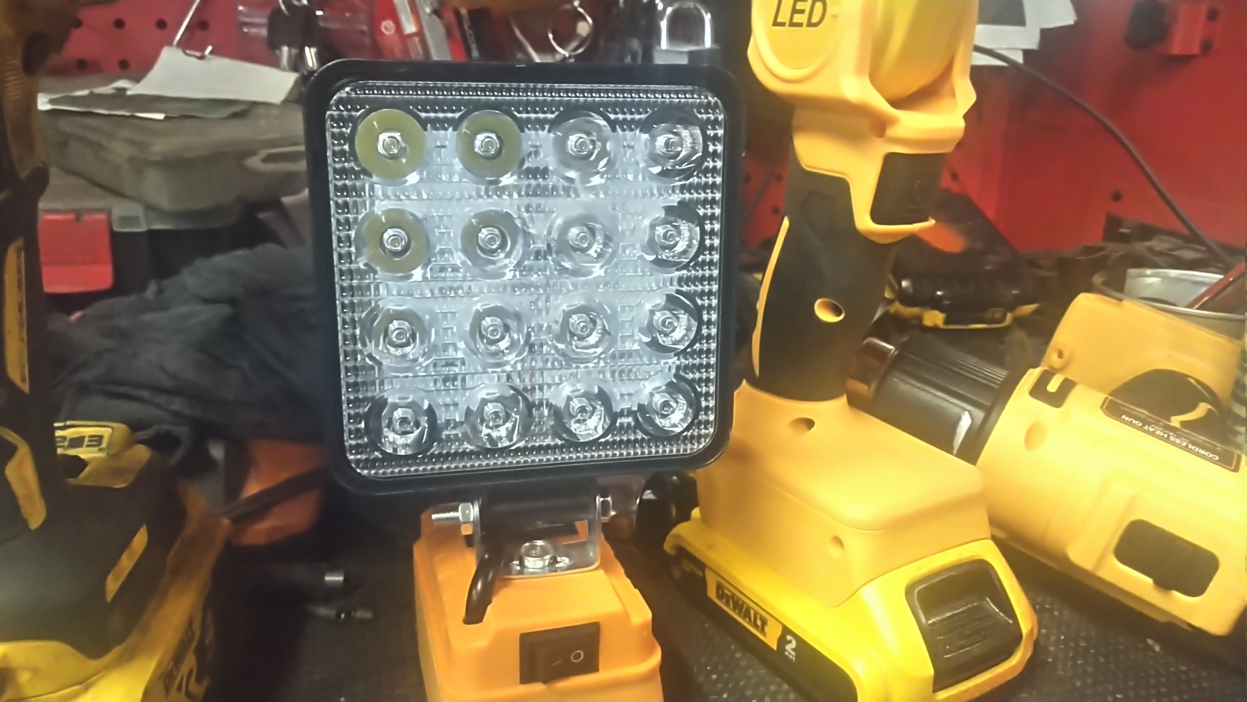

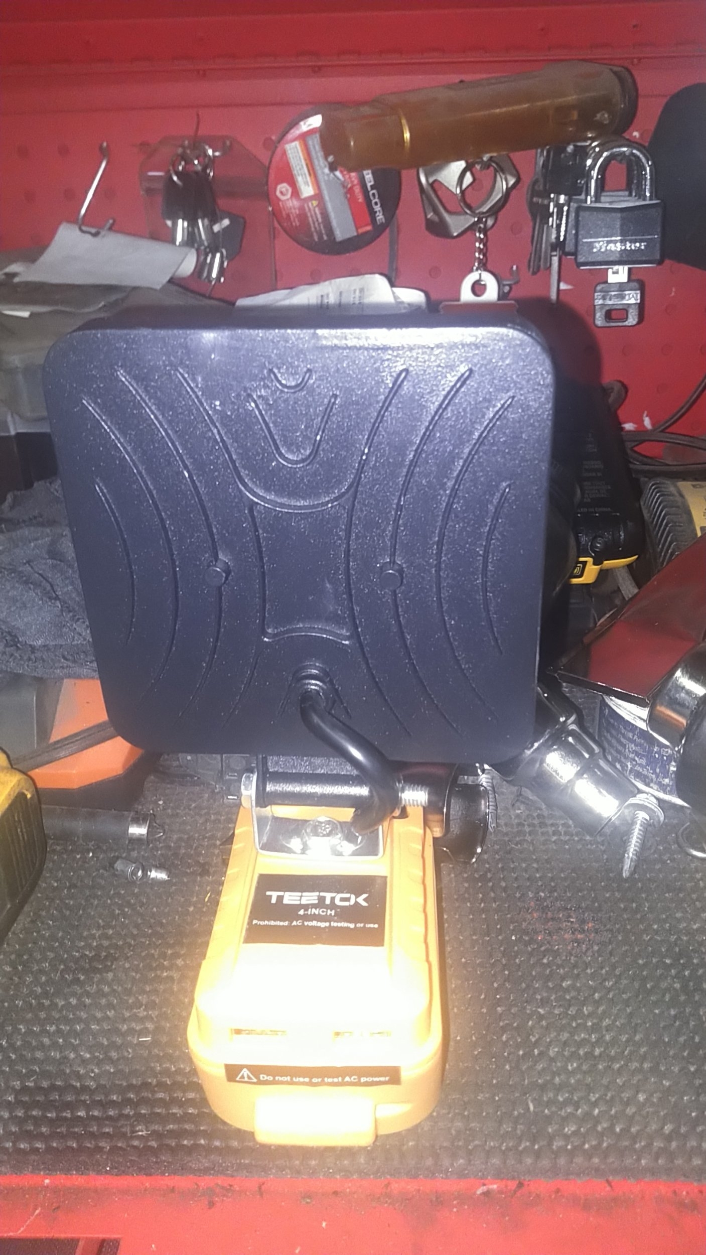

With DeWalt tools, the low voltage cutoff circuit is located in the tool, not the battery. Many knock off tools do not have this LVC and can damage the battery by over discharging.
Yeah I've left partially charged batteries in multiple DeWalt brand tools for extended periods never lost a charge unless I was using the DeWalt 18-20 volt adapters. I'll say the light was definitely off, nothing plugged in to usb port and battery had charge when I left. I just have to remember to remove batteries from cheap knock offs now on.
Yeah, I have one of those DeWalt USB adapters. Even though the light is off, and nothing is plugged in, the USB circuit still draws a small amount of power. Eventually, it will kill the battery

Okay here's the culprit buyers beware. My cheap DeWalt knockoffs to the right of it didn't lose charge and have no USB ports I'll pull batteries anyway though. As I get older I've never appreciated work lights on projects as much as I do these days lol.
