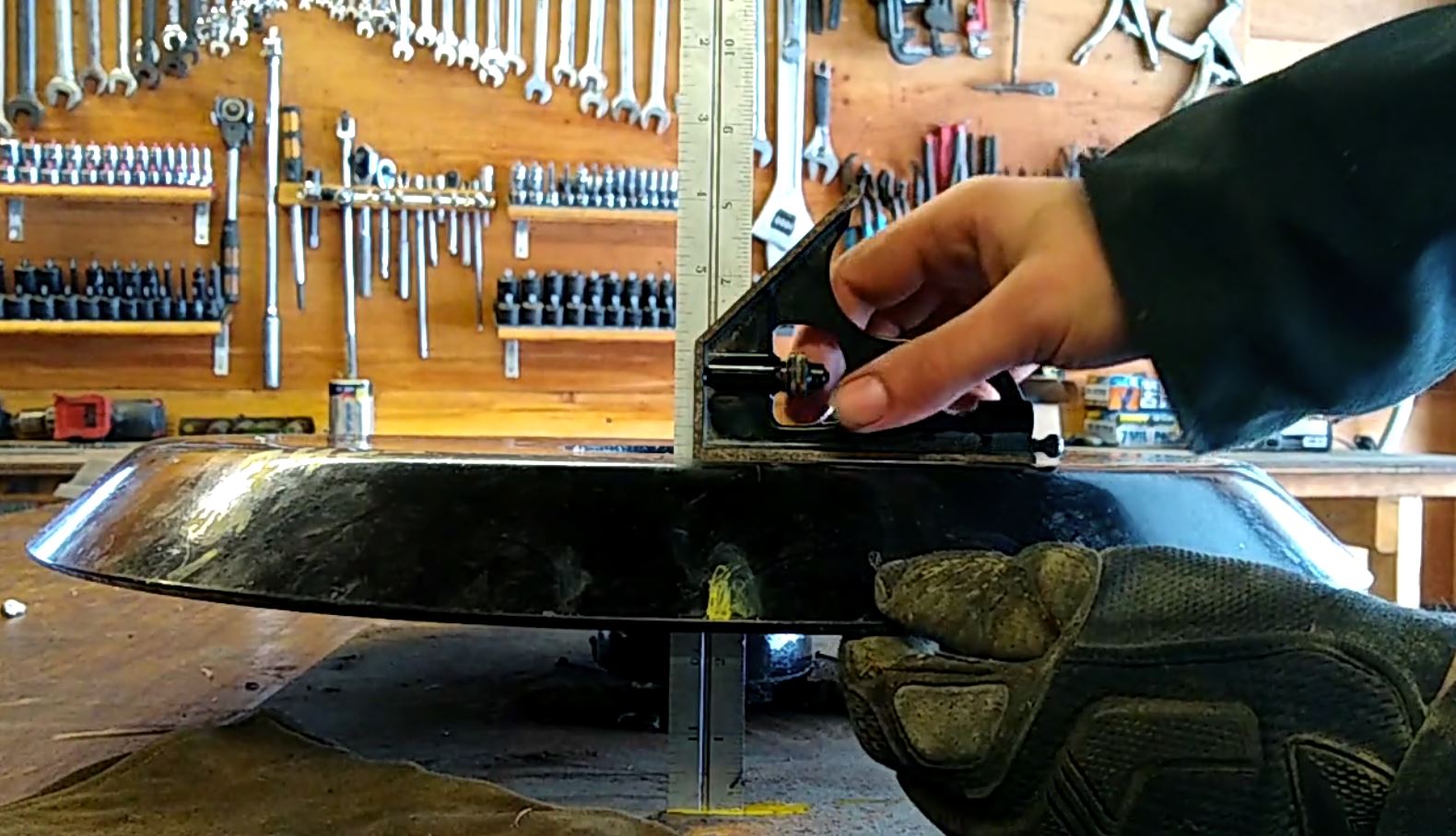

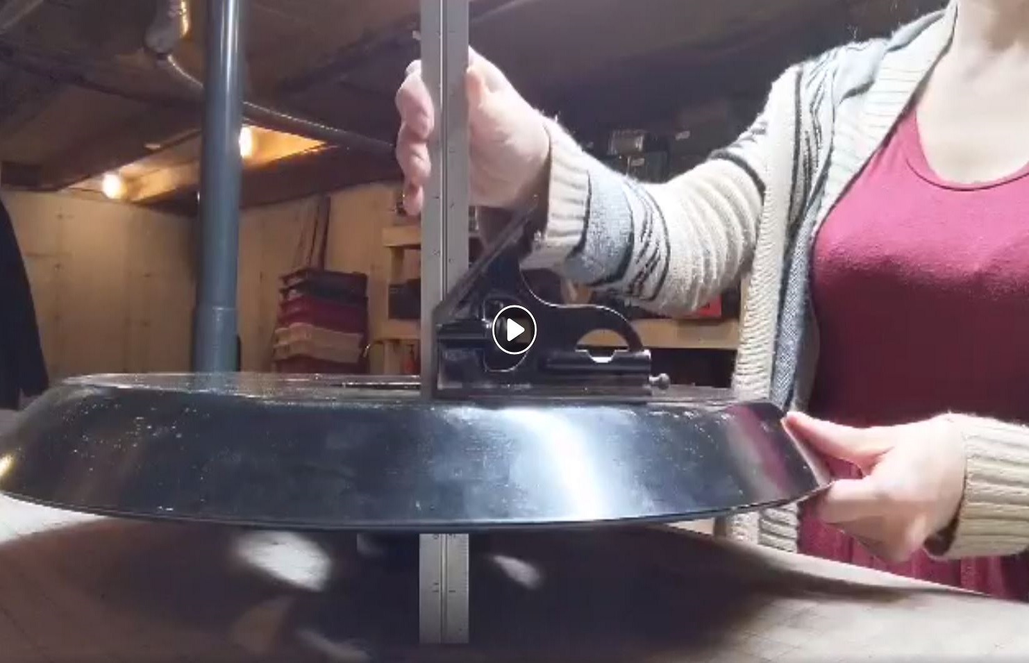

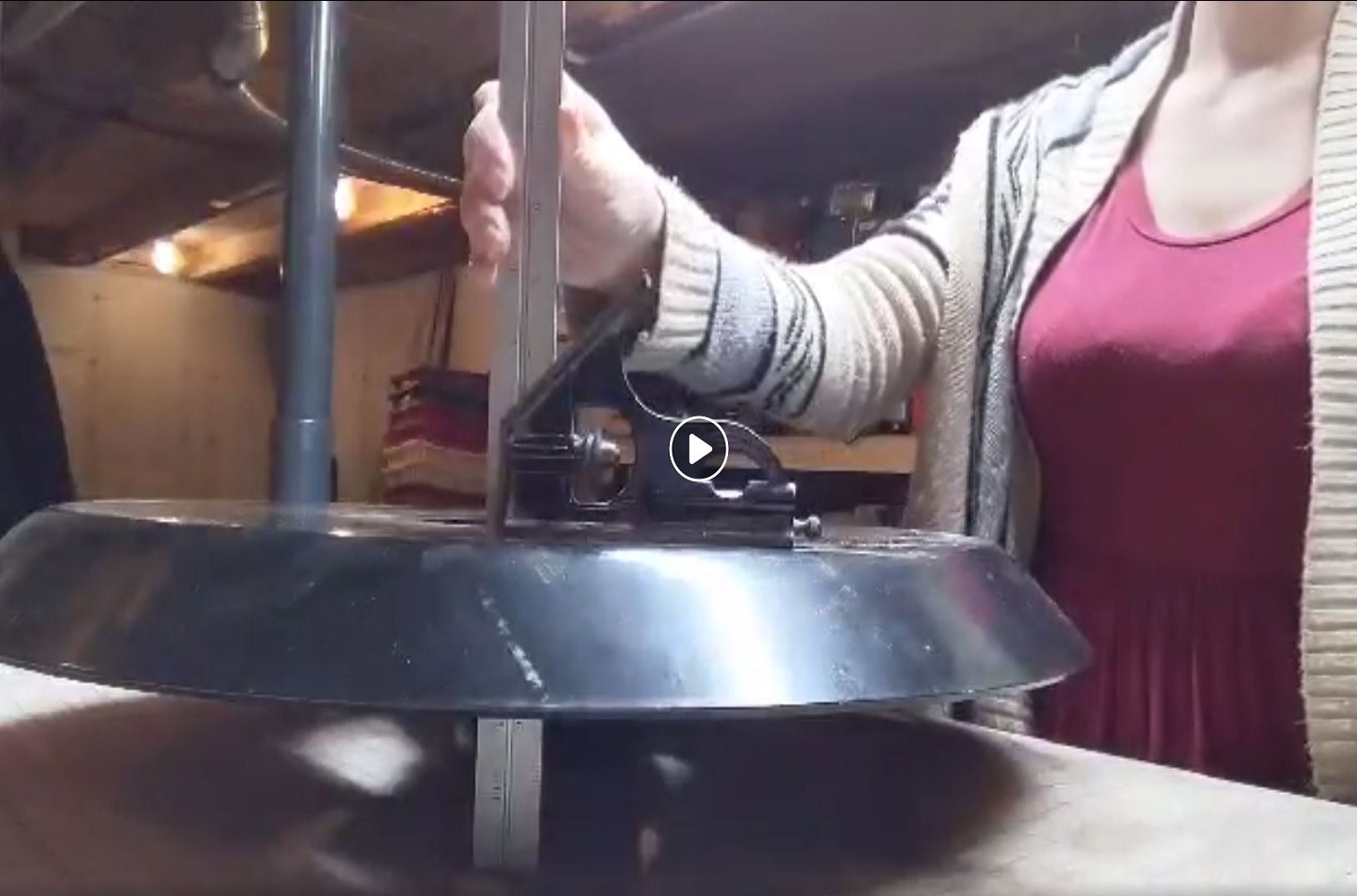

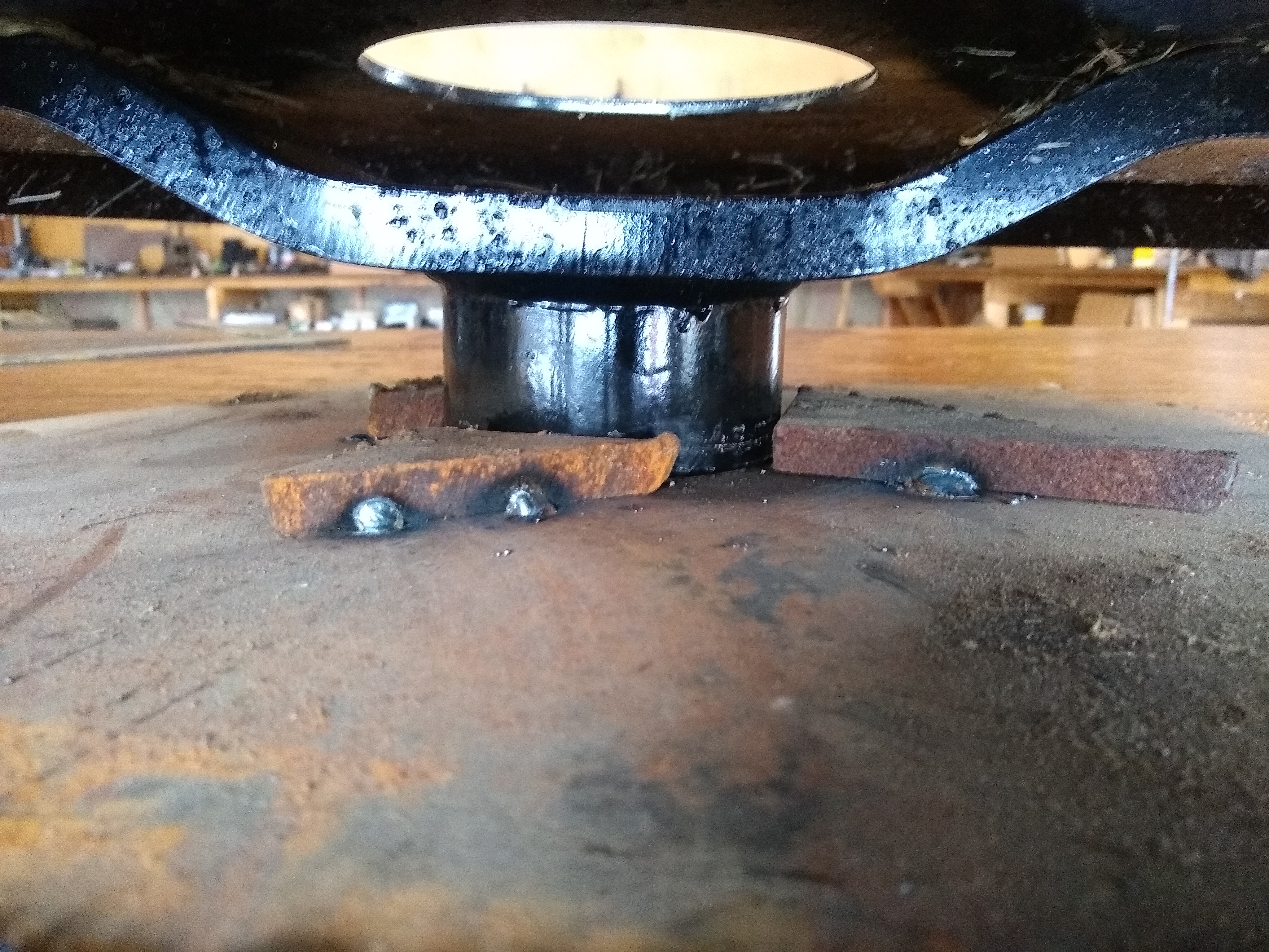

Replacement stump jumper arrived a few days ago. During my absence, my lovely assistant has taken measurement of this one. It appears much better. When I get back, I'll go over it, and mount it up. I think its safe to assume all unusual vibrations will be sorted at this point.
In the mean time, I've got a few more pieces of rotating equipment to manage at work.
   / New Rotary Cutter, Stump Jumper, Blade Pan out of alignment, Thoughts?

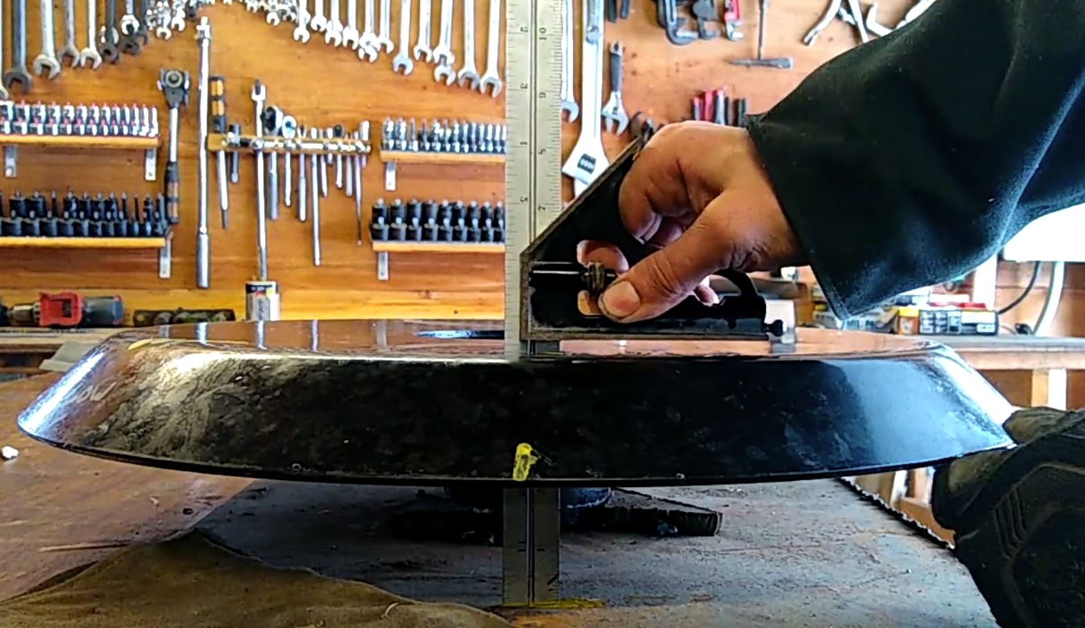

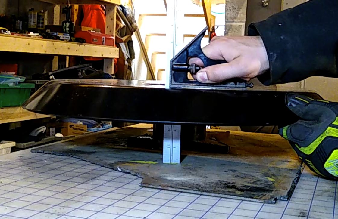

#28
Conclusion:
I've arrived home, checked the jumper myself. less than 1/16th out from pin hole to pin hole. The mit indicated 0.040, MUCH better. Mounted up to the cutter and she's as smooth as a new cutter should be. So I can confidently say that a stump jumper like this will certainly cause undue vibration. I'm happy now. The Mfg of this cutter sorted out the issues, despite some disagreements, at no extra charge to me.
Compare this pic to the one in post #1.
Having gone through this, it is my opinion that, despite the arguments I had on the phone, a rotary cutter should not have a stump jumper that is 1/4" out, pin hold to pin hole. Even one for rough brush cutting. (the rest of the jumper plate really doesn't matter, its the blade bar end to end that is important.) I would say 1/16th is the maximum acceptable. I'm willing to wager the spec sheet tolerance for whoever makes this stump jumper, would indicate similar. If I were the Mower maker, I'd demand much better from the folks making this jumper/blade carrier for them.
A few years down the road, gearboxes, and the tractors running them, will be better for it.
