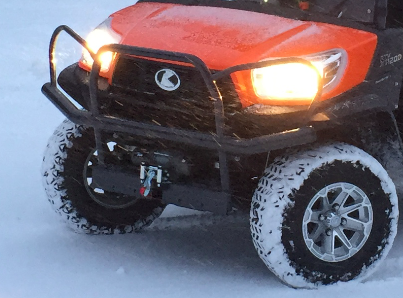

It's fairly easy to mount a winch in the front bumper, and the holes matched up to the Warn 3000 I bought. Hardest part was running the wiring to the battery. Sorry I don't have a better pic than this:
Here's the winch I got: Warn Industries - ATV & Side X Side Winches: Vantage 3000-s
It was on sale at Northern tool last winter and I had a $50 coupon, so it was a good deal. I set mine up with the plug for the winch's wired remote hidden under the hood. I did not wire up the permanent switch, since there wasn't a clean way to mount it in the dash and I figured I could just use the wired remote from inside the RTV just as easily.
So I ordered a superwinch terra 35. Should be here Wednesday. What's the purpose of a mounting plate if there's holes for a winch already? Added strength?
   / New RTV-X1140 #13
I don't think you need a mounting plate at all. In fact, there really isn't a lot of room on the RTV bumper so it may not even fit. It's probably only needed for installs where there isn't a suitable mounting area already.
   / New RTV-X1140
#14
Makes sense. Thanks. I'll try to take some pics of my install.

You don’t need a mount plate. I put a Super Winch Terra 4500 on my X1120D last year. Worked great
